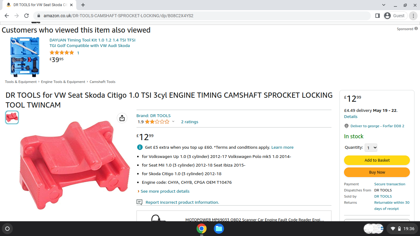

personally I would be asking them to time the engine again and just make sure the pins go in as required, it’s not a massive job to time this engine as technically if you know what you are doing you don’t even need to touch the belt or timing cover.
as the pulleys are not keyed and are freewheeling it is extremely easy to time the engine a few degrees up either way by mistake.
yes the pulleys are oval shaped and are marked to only go in 1 position using a camshaft pulley to camshaft pulley locking tool, but even if they were 90/180 degrees out I couldn’t see them causing a vibration.

To check the timing using the correct tools should take no longer than 30 minutes or so as its a bolt/pin and a bracket with locating pins, fairly straight forward so no reason for a garage to try and rip you off.
If youre sceptical, ask for photos of the timing pins in their correct locations and fitted to the car.
