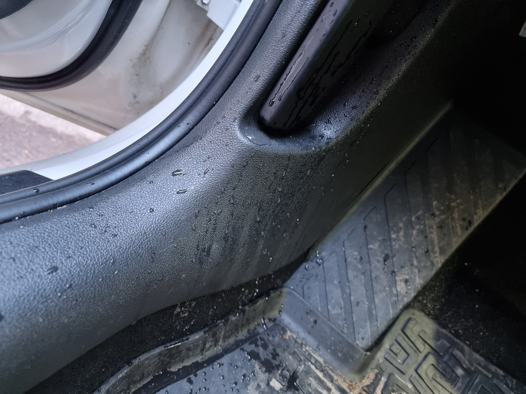

Hello everyone, I have a big problem. I am quite new owner of Octavia 3 vRS 2014 (model year 2015) diesel. This is an estate with panorama roof. Problem started when I discovered clogged drain pipe on driver side (I have LHD drive car with steering on the left). This is what was happening just yesterday:

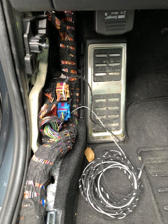

Thank you. I found that under this trim there are some wiring harness and few plugs:
What are these for? If they were flooded with water, is there a possibility it caused those faults? What about CAN Gateway module? Could it be damaged aswell?
Above photo is not my photo. As for my Battery, it is in good condition, charging is good aswell. Checked also few fuses and all are good.

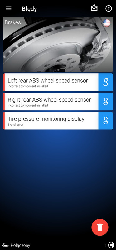

[url=https://postimg.cc/jW1JrmcX][img]https://i.postimg.cc/jW1JrmcX/Screenshot-20230312-151454-OBDeleven-VAG.jpg[/img][/url]
[url=https://postimg.cc/jL6gdQGN][img]https://i.postimg.cc/jL6gdQGN/Screenshot-20230312-151410-OBDeleven-VAG.jpg[/img][/url]
That is what it is on almost every control module.

This is the only thing that points to some hardware fault, two rear speed sensors. Of course it was working flawlessly before and the car was standing still during the weekend. In all other modules I get the U112300 error :/  Only the DSG is free of codes, engine also throws this U1123 code but works ok. Could it be caused by the d*** water?spacer.png

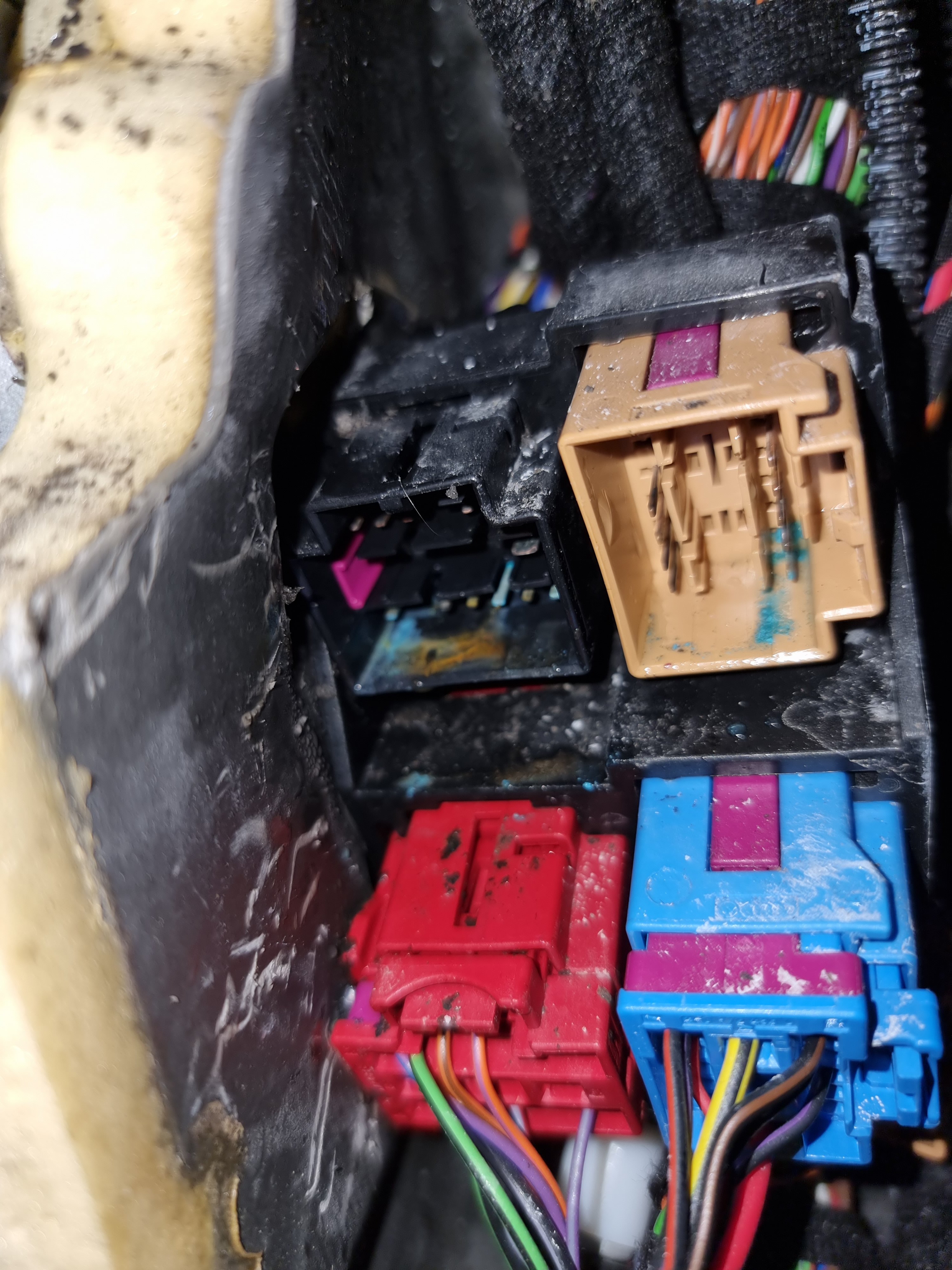

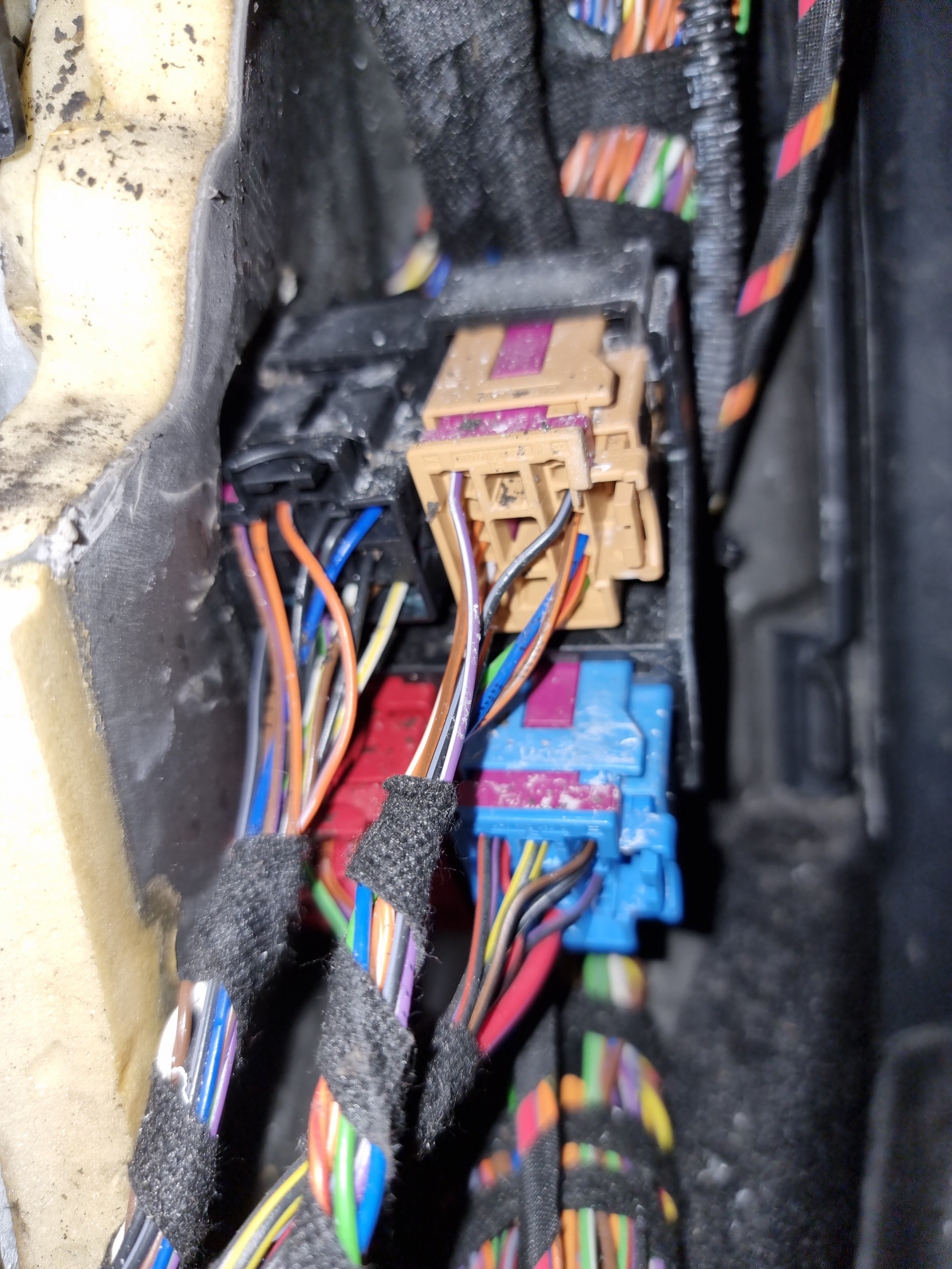

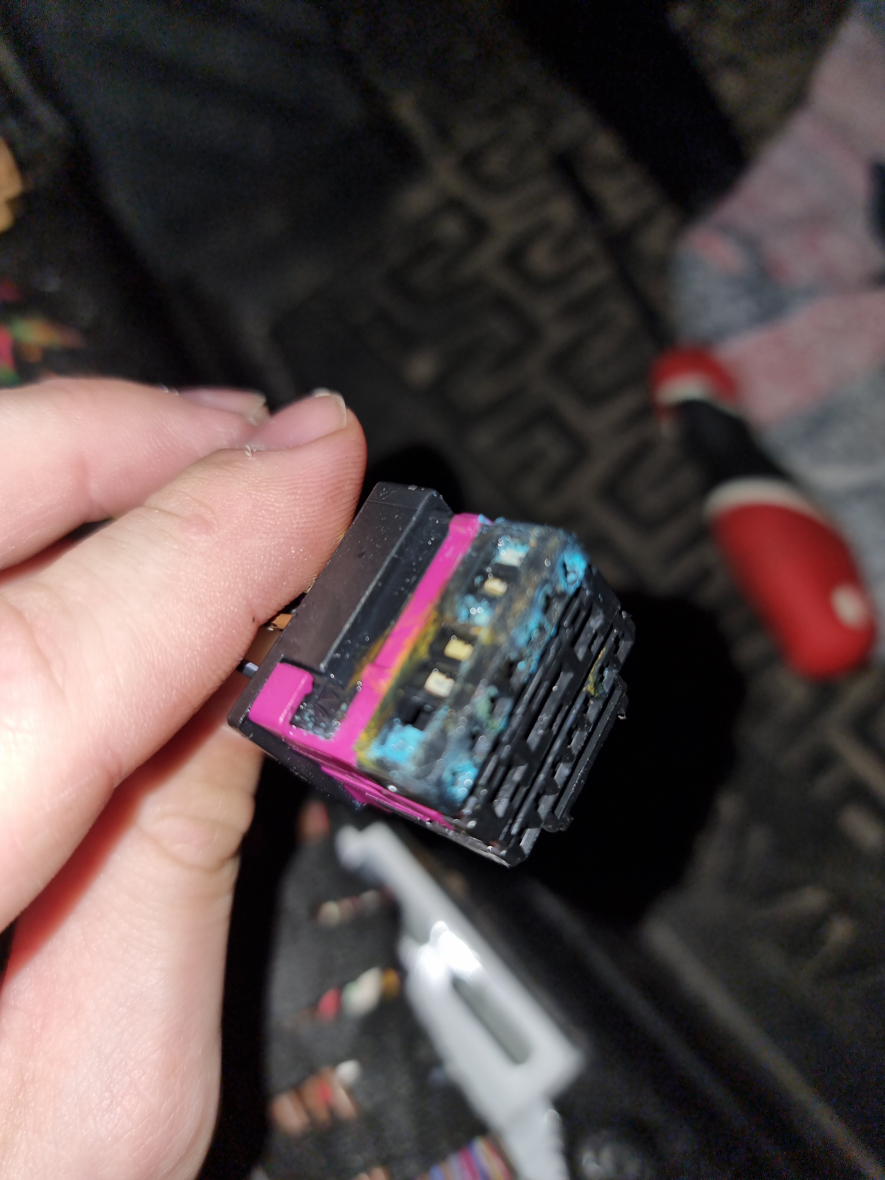

Fixed the problem. After removing the trim panel near the footrest, the plugs looked like this. After cleaning them with contact spray all came back to normal, car's systems are alive again. Next thing is to take care of the clogged panorama drains. Thank you everyone for ideas. So if someone has this problem and has panorama roof, then it shows where to look for the solution.20230314_003007.thumb.jpg.d1fd575963a952bab97d097a036b96fd.jpg20230314_003633.thumb.jpg.5fb927b968e1805b3bc880ff70a15cdb.jpg20230314_003640.thumb.jpg.58f69b5e4aac776a4cce769ba63957fa.jpg

After cleaning to help keep water and moisture out you could use something like Contralube 770 to protect the connectors internally, a sachet lasts a long time and a tube much longer. - PDS-Contralube_770.pdf
ETA: Use as required but no point putting in too much to connectors so that too much squeezes out when you put the connectors together.

I'm surprised at the amount of corrosion on those connectors considering the relatively small quantity of water indicated in OP image - very useful find for all those out there with leaking sunroofs.
@Warrior193 I was to but it was a very limited photo and perhaps it shows the water after it comes out from the inside the plastic trim.  Because of all the electrics and electronics on cars now the wires and connectors as so small it doesn't take much to fill them or cause resistance now.
