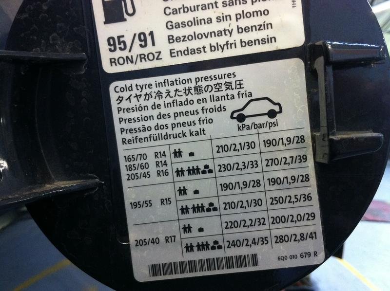

So to get Up to 5% Bio and that can be 0% you need to buy E5 Super Unleaded & that is 97 or 99 ron (Octane) in the UK.
Nobody sells 98 ron in the UK and has not for years.
VW Group have ignored that 98 Super stopped being retailed on the UK over a decade ago.
Even when they put stickers on the fuel flap showing,   98 / (95).
http://volkswagen.co.uk/en/need-help/need-help-faqs/fuel.html
eg.
Green VW Sirocco R,  Red Fabia mk2 vRS 1.4 Twincharger.

What that plate tells you is that 98RON is recommended but if you can't get it then 95RON is OK - check what the plate on your fuel filler flap says.
