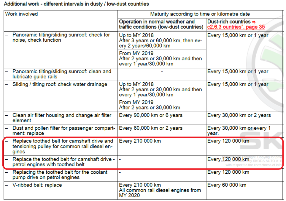

Dealer B is correct in relation to the official workshop manual...   the 1.4TSi engine has no mileage or time limit shown and is 'supposed' to be a 'lifetime' belt.
Dealer A is quoting the 'recommendation' that Skoda UK apply in the UK but goes against the official workshop manual and advice for the rest of the world.
The above info posted by Yogi appears incorrect anyway as the water pump is not driven by the timing belt but by an auxilliary belt on the other side of the engine.
Now make of that what you will - it will be your vehicle and your choice.  Many on here will tell you to replace it as a precaution against failure of it and the tensioner but Skoda don't seem to think it is necessary and neither do VW or Audi in other countries.

 That the same engine made in the same factory but sold elsewhere doesn't need a change at 5 years...   And that Skoda UK are taking UK owners for a ride by telling them something is needed that isn't?
Thats what it tells me.
Even their own workshop manual says it isn't needed.

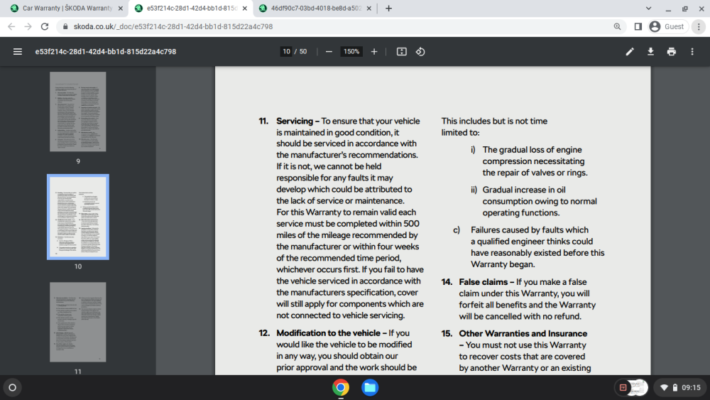

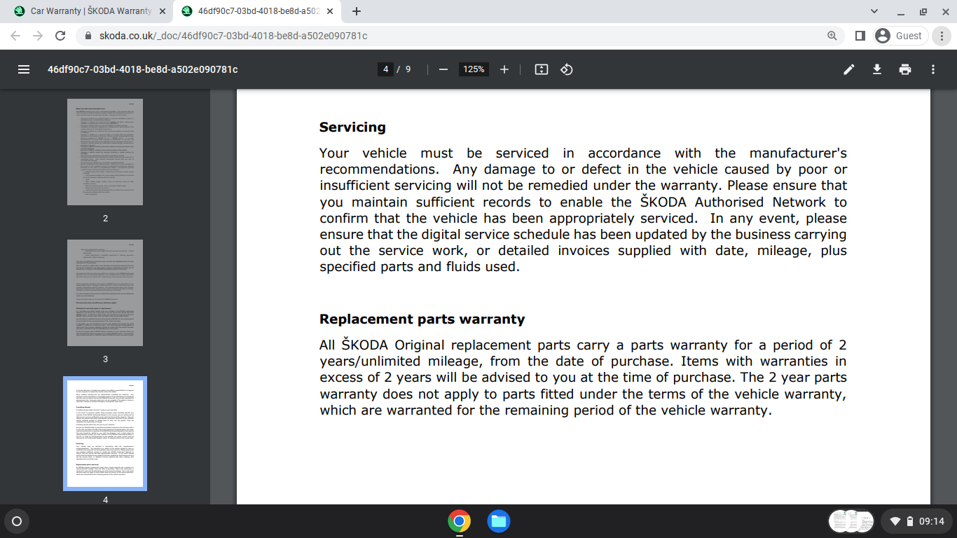

All very well, but if the workshop manual says it doesn’t need replacing, why doesn’t the car’s warranty (either new or 1-year second hand from an approved dealer) cover it? Particularly considering how badly it will screw up the rest of the engine if it breaks at full power?
Presumably because the warranty terms, conditions and duration are also set by Skoda UK (essentially an importer), unlike the workshop manual which isn’t.

I have Skoda’s All-In warranty which has just agreed to replace a leaking water pump, which as it happens usually costs around £400. A condition of that warranty is that I follow the manufacturers service and maintenance schedule. Now, is that Skoda’s schedule, or Skoda UK’s!? 😂
If the Warranty T&C,s say to the Manufacturers Schedule or Specifications then good.
They said Guidelines or Recommendation in the past and more recently they said Specification.    Ask at a Main Dealer and they seem to not know  the actual Schedule or Specifications at the Service Desk.
