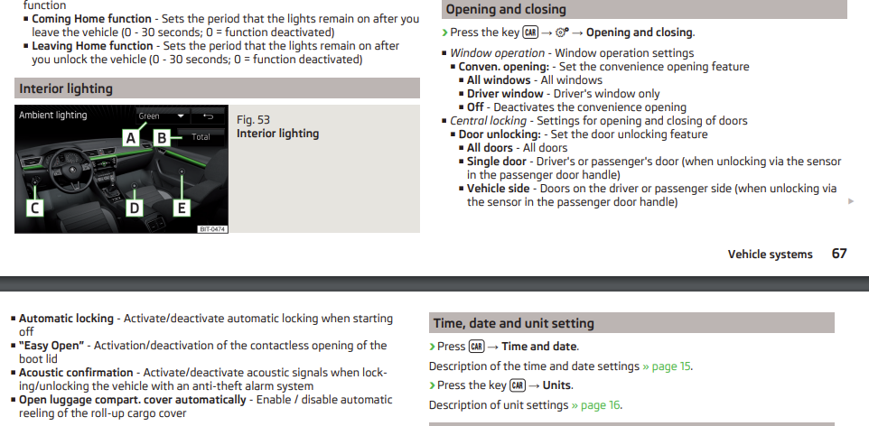

From the 2016/11 'Amundsen and Bolero infotainment systems Owner's Manual' for Central locking - Automatic locking - Activate/deactivate automatic locking when starting off -
https://manual.skoda-auto.com/004/en-com/Models
Edited by nta16
Thanks but I do not have the option “automatic locking” present on my bolero system (see above posts)
Sorry I though you might 'pressing' the other 'button' ('Door unlocking: All doors' instead of 'Central locking') my wife's car isn't available to see if there's a down arrow next to 'Central locking' it's not a facility we'd use so I can't remember if it's even available on her car.
At the service was any recall or programs updates done or is the issue starting after the service a coincidence, did the Dealership say £350 to fit the OSR lock would resolve the issue, or was there another reason to replace that lock, as the problem remains.  This situation is disappointing but unfortunately not that surprising when dealing with some in the motor trade.
If the Dealership doesn't want to be reasonable I think I'd try finding a good auto-electrician, or independent garage, with a VW appropriate scanner to diagnose the issue rather than a policy of fitting a series of parts replacements at your expense.
