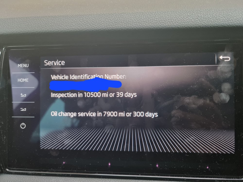

Hello everyone,
I have a message in my Kodiaq "Inspection in X days". We have this car for over 4 years and not on warranty any more.
What do you recommend to do now ? I mean I will go for the inspection obviously but ... should I buy some sort of service before that ?

@New11  The Inspection is the basic annual service, and will initially be set to year or two. It counts down as warning for about last 30 days (as does last 1000 miles).
When was it last serviced, was it basic (minor) service, or extended (full or major) service.  In simple terms tend to alternate, although depends on your mileage as reaching time intervals and mileage points usually don't sync.
You do not need a service plan, can just pay as you go. Depending on your style of driving and mileage the service plans often don't work as nearly always one minor, and one major service in 2-3 years which might not be suitable.
Really need to advise how long ago it was serviced, what type of service (minor or full), mileage at last service and now, and age of car for people to give best advice.
The main dealers should do job properly and any safety recalls too, and will do extra work (at high price, if you let them).  But if car is out of warranty a local garage, or fast fit centre that does servicing will be cheaper
INSPECTION can show separate from Service or Oil change due if someone does not set or reset properly.
There is no just INSPECTION.     Ask a price of an INSPECTION, there is not one,
So have the car set on Fixed Servicing 9,400 miles /372 days or Variable 18,000-20,000 miles / 24 months.
Some places do still do Minor & Major servicing as was the norm till 2020 when Skoda UK went Oil & Inspection services & extended scope @ 3 years then each 2.
***Get an Inspection of the Body Work when the car is being serviced, that is for the Paint Warranty up to 3 years then for the Corrosion Warranty for 12 years.
No additional cost, it should not need asked for, it is their job.,  Just they dont bother & Skoda & VW UK know that, then say no record of being done.***

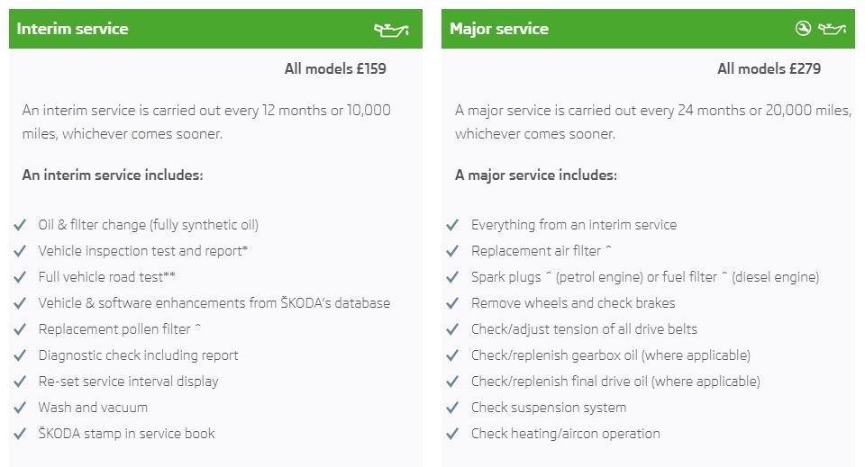

Old days If it was a Oil & Filter service with a Pollen Filter replaced that looks very much like what was referred / called a Interim or Minor Service.
It was 2019 / 2020 that the Oil & Inspection Service & Extended Scope started being used in the Fixed Servicing & Maintenance.
Then a Major Service.   (Not that much about it being Major, just servicing really.)
Any record of the Brake Fluid changed at this 2nd Service if not at the 1st, or in between at 3 years / 30,000 miles.
That is an extra that needs paid for.  Unless included in a Service Plan.
