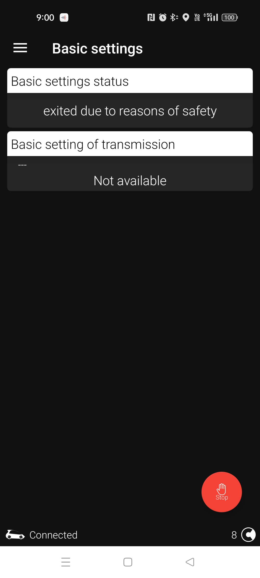

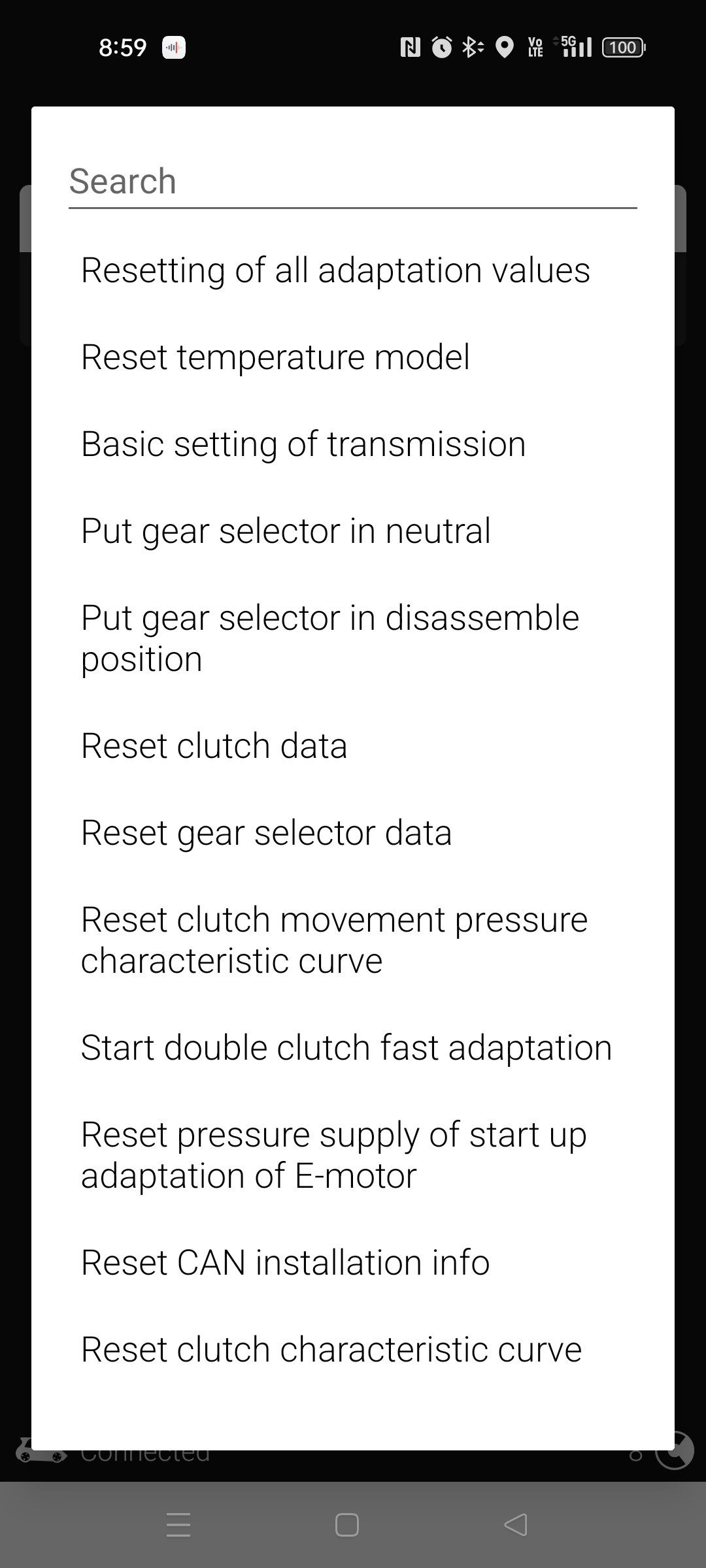

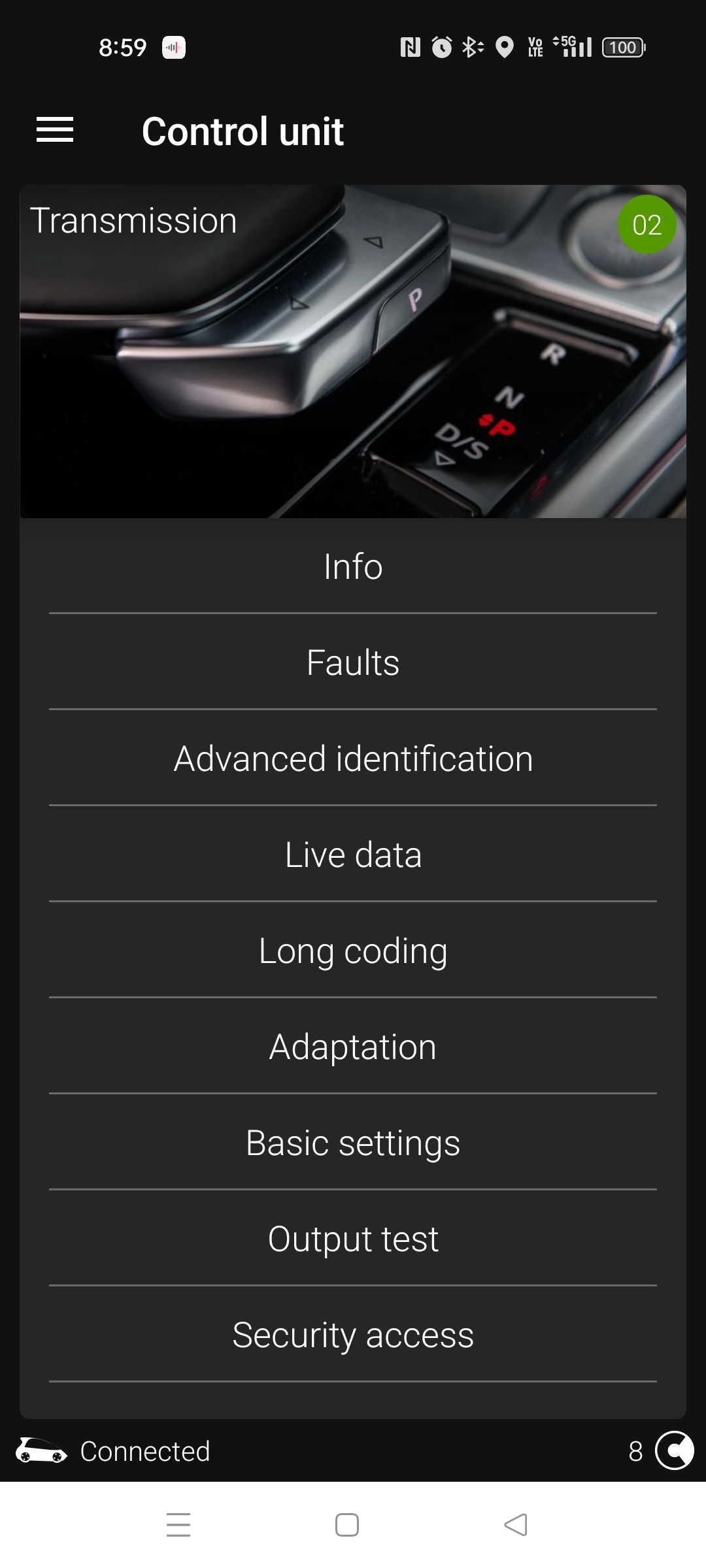

have you tried basic settings on the gearbox in the apps>workshop>basic setting of transmission section??
No, I didn't do that. Is there anyway of doing it from OBD11!!!. I'll try to have a look today...
I have tried to do basic setting..but it seems, it doesn't do anything..please see the screenshots.

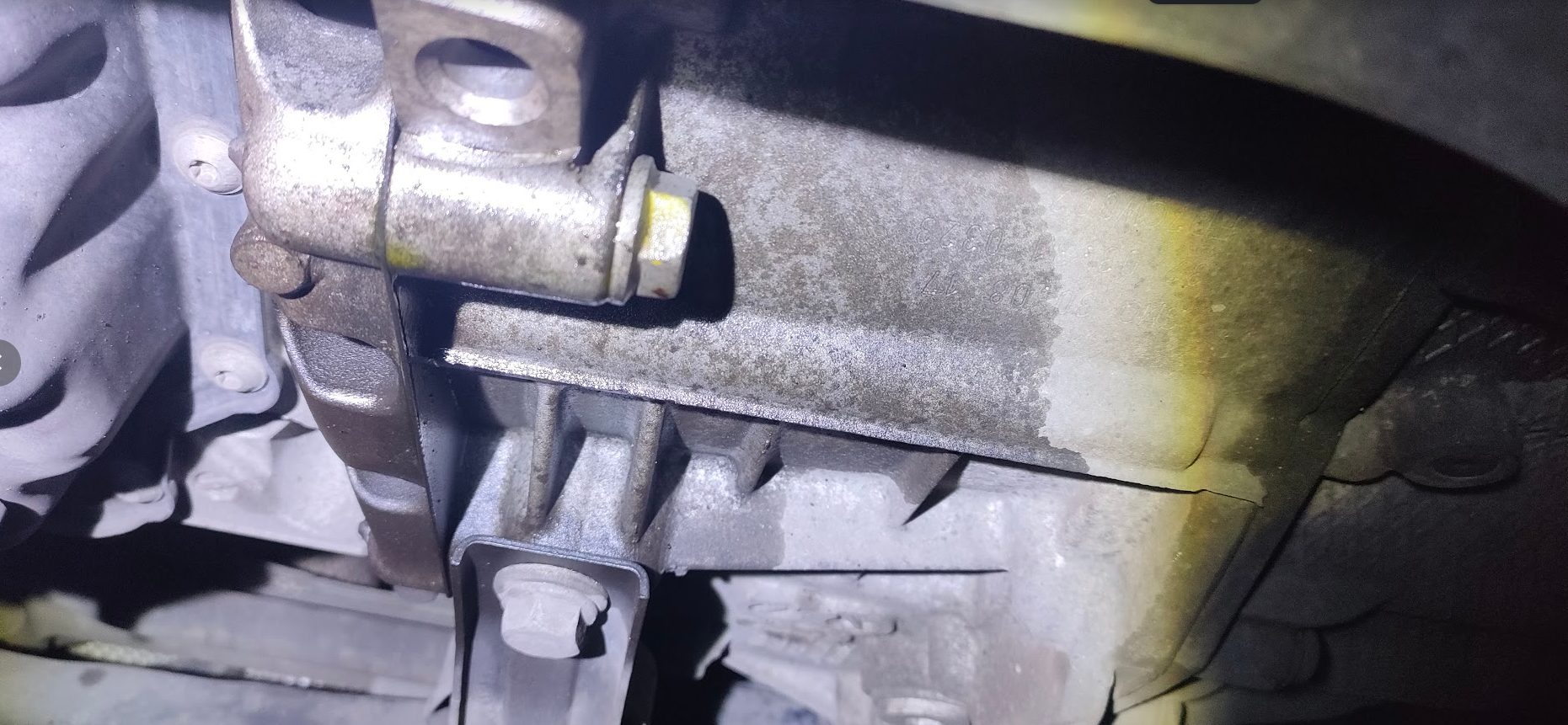

 Update:
Yesterday I had MOT and i saw the oil leaking sign again and this time in gearbox not in the mechatronic (which was laready fixed). So, I took the car to the same gear where mechatronic leaking was fixed. they also confirmed that mechatronic isn't leaking. this time it is gear box. My car also judders time to time especially when car is stopping position in uphill. So, garage guy said, I  may need clutch repair as well and with everything he said it will cost me 1500 +Vat..
It seems it is now one after another. Few months ago it was mechatronic and now Gear..
Need expert opinion...It is not too much leaking or dripping the oil at the moment...but problem is juddering.. it judders every now and then and as an uber driver i need lot of city drivings. What should I do? Can anyone recommend me any gear especialist in london to get the second opinion or quote.
