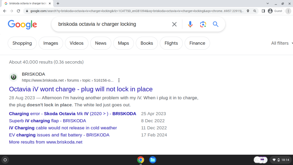

My first visit to a Skoda dealer resulted in about 14 days of wasted time, being told everything is fine and they had never heard of this before, but it’s all working fine now so have a nice day, oh and they also scraped my car.
A google search however shows this fault to be not unheard of.
If anyone has indeed suffered this ongoing problem I would be grateful to learn how the matter was finally resolved and how many times they were told everything is fine and dandy by the dealer until someone finally listened and rectified the fault.
many guidance/experience is appreciated even if it’s to know I’m not alone.
