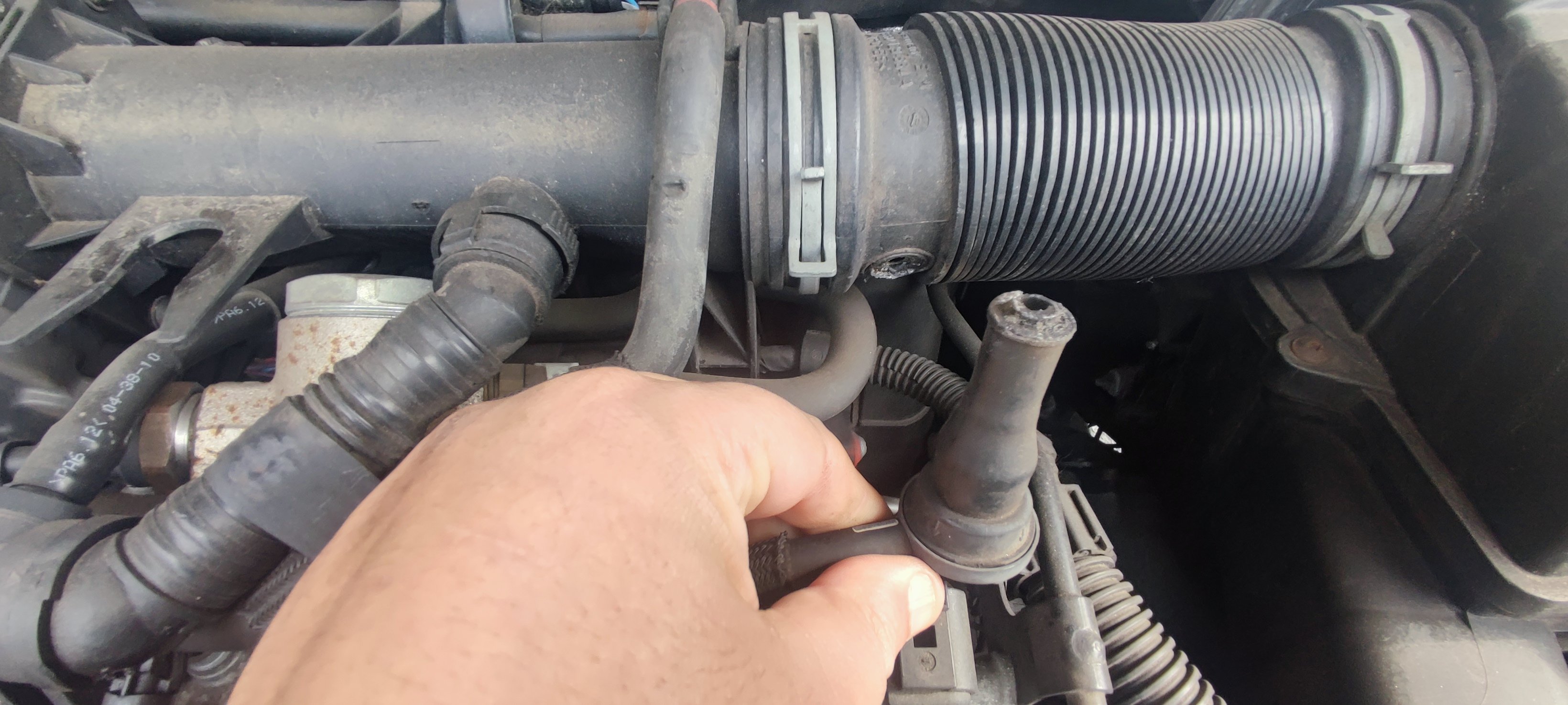

Hi people just had this issue come up. Every time I put the car into drive the car shakes and then when you attempt to set off the engine cuts out. I've uploaded a video could someone please tell me what the issue could be. Engine management light is flashing and EPC light is on. I've also attached a pic of what looks like a hose has snapped off from the air filter could that have anything to do with the car making a racket or is it much more serious.

Hose won't be relevant.

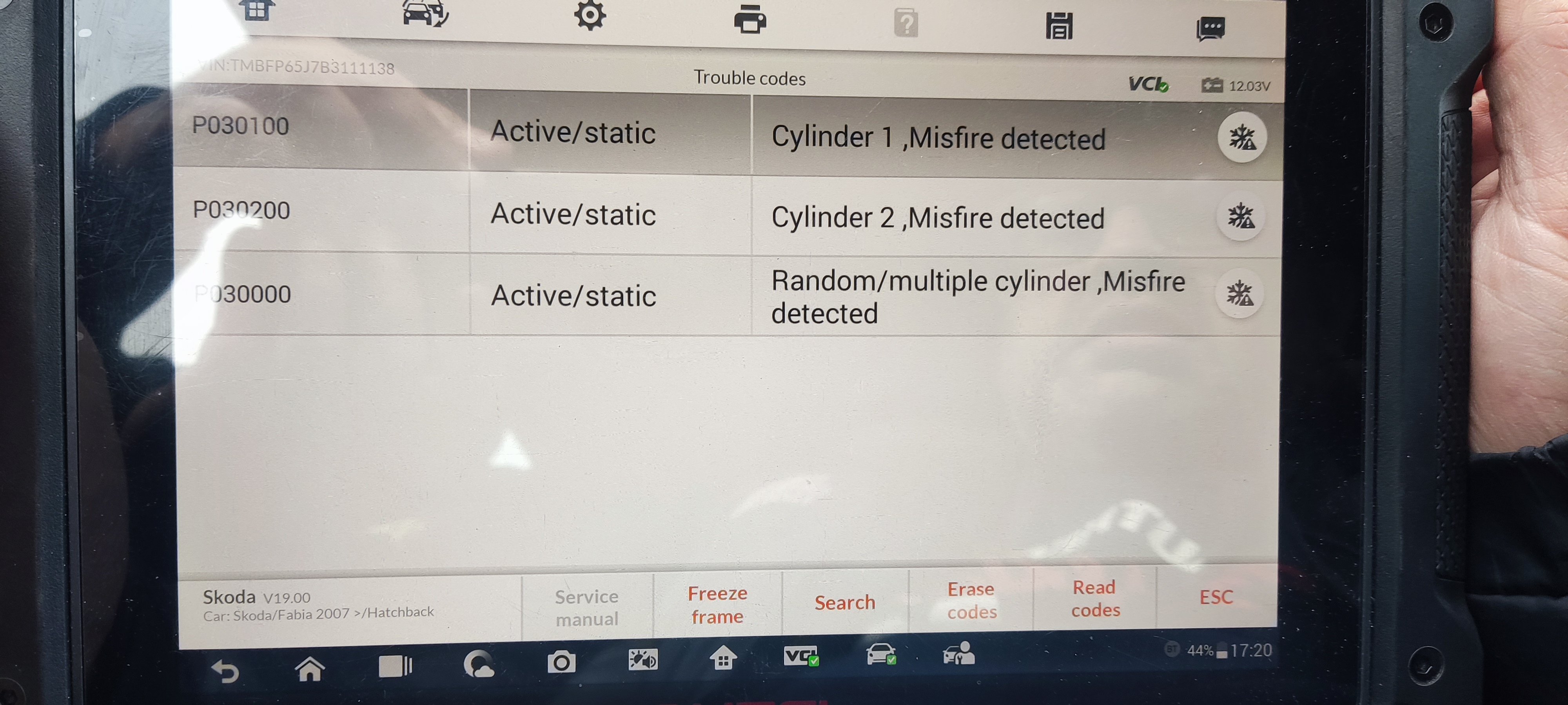

@Breezy_Pete I've just got a reader on it and it's given me these codes.

The snapped-off hose looks to be the crankcase PCV - wouldn't that affect inlet mixture?

It's next to the air filter assembly so it's unmetered and unpressurized and can't make a difference.

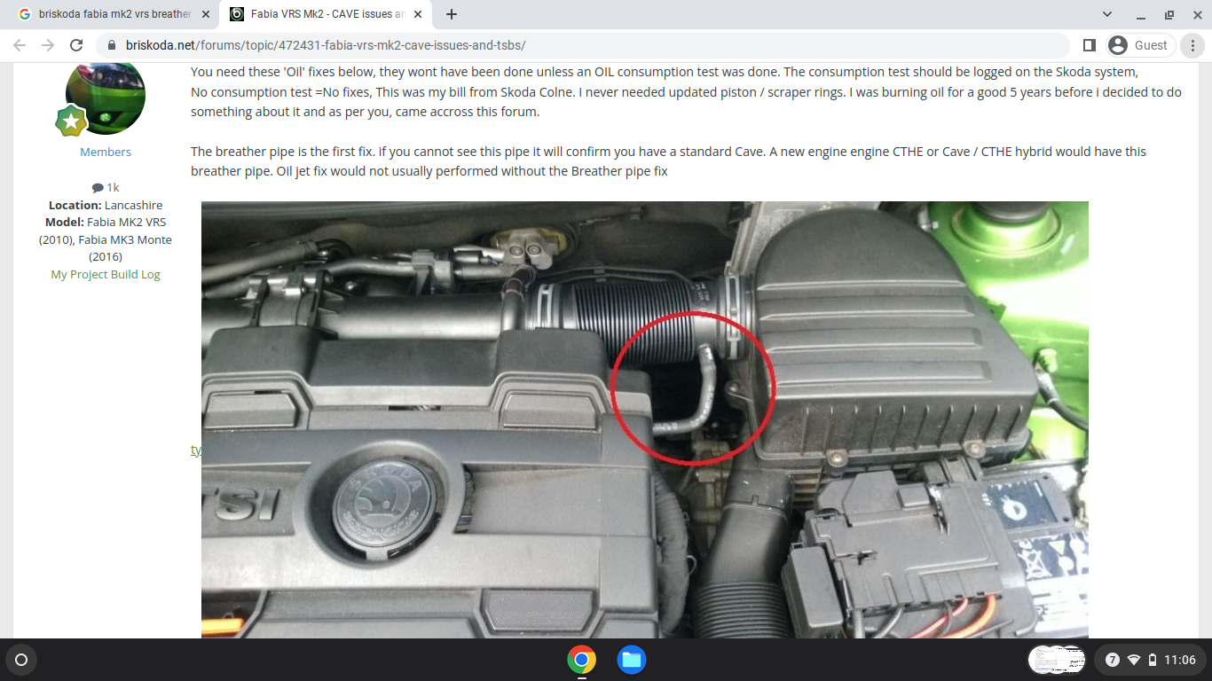

Fix the Breather as it will run like crap without it.
As for the Misfires logged,
get the plugs out and check all 4 and replace if required, or the one plug that might well be oiled up and black with soot.

1.4 TSI Twincharger issues, High oil use had VW Group / Skoda doing 2 Changes to the Breathers.
Ist one in Europe just the Breather Mod 2009-2012 & a software update.
2nd one tried out in Australia was Breather Mod mk2.

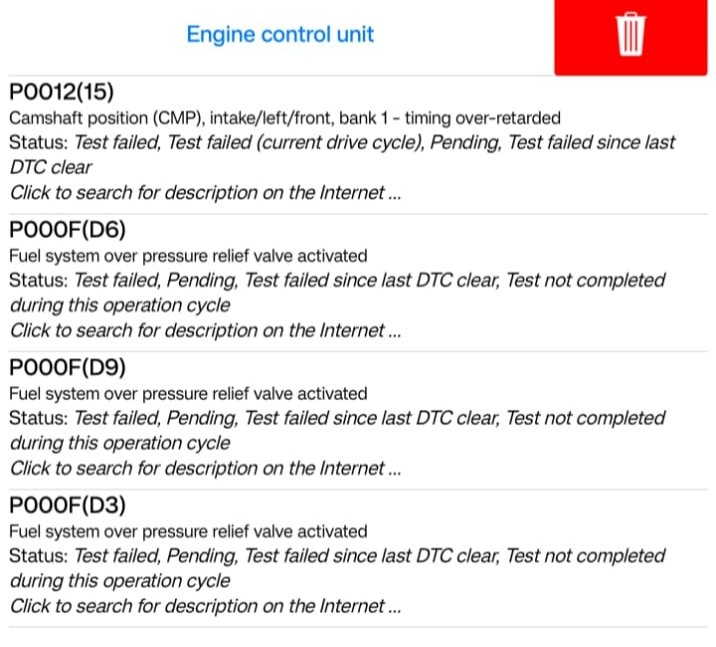

Hello people I've now got these errors come up. Car is struggling to start so put the reader in and it's now brought these errors up.. Advise please..
Cam dephaser solenoid failure is most likely, test the solenoid for a few ohms resistance across it. If so replace it and clear the codes, then start it and see what returns.
Morning had someone come out and look at the car last night and removed the plug from cylinder 2 which was black and covered in soot. The plug from cylinder 2 was the one the mechanic replaced last time and it's not lasted 2 months. The guy that saw the car last night suggested that it could be the cam/lifters and that a compression test would be the way forward and then to see if the valves have been damaged or cam shafts. Does that seem right?
Good morning, a compression test would be a logical starting point - then, depending on the results of that, check the valve timing, then the coil packs.
