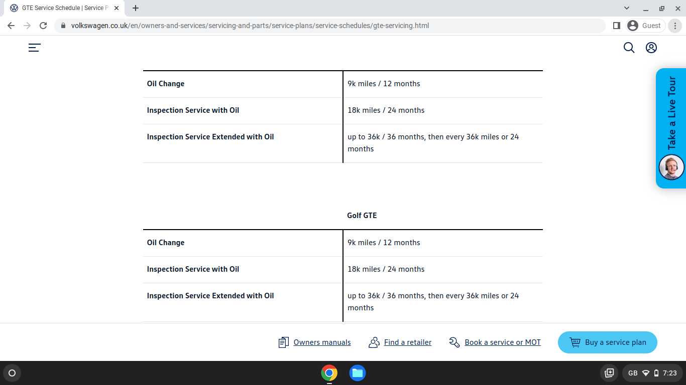

Does anyone know why service intervals are every 10k miles for the PHEV?
Because the engine might not run that often or get to an efficient temperature.
It is not 10,000 miles, it is a fixed Oil & Filter service regime so 9,4000 miles or 12 months.  (372 days actually)
VW has it as 9,300 miles.  I even read 8,000 miles in one VW Service schedule.
Here 9,000 miles, VW PHEV,s.   UK>
Passat GTE,  Golf GTE.
