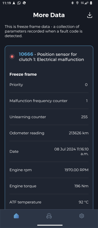

Howdy, just returned from holidays and a 350KM trek from the airport back home, on the way I lost 4/7ths of a gearbox! Emergency mode 2,4,6 only. Checked the code immediately:
10666 – Position sensor for clutch 1: Electrical malfunction.
I wasn't too happy ! I had one or too other errors too , ACC etc. cleared them all but after another 10KM the 10666 came back.

Just to add to this, the error only appears when the gearbox is up to temperature from what I've discovered.

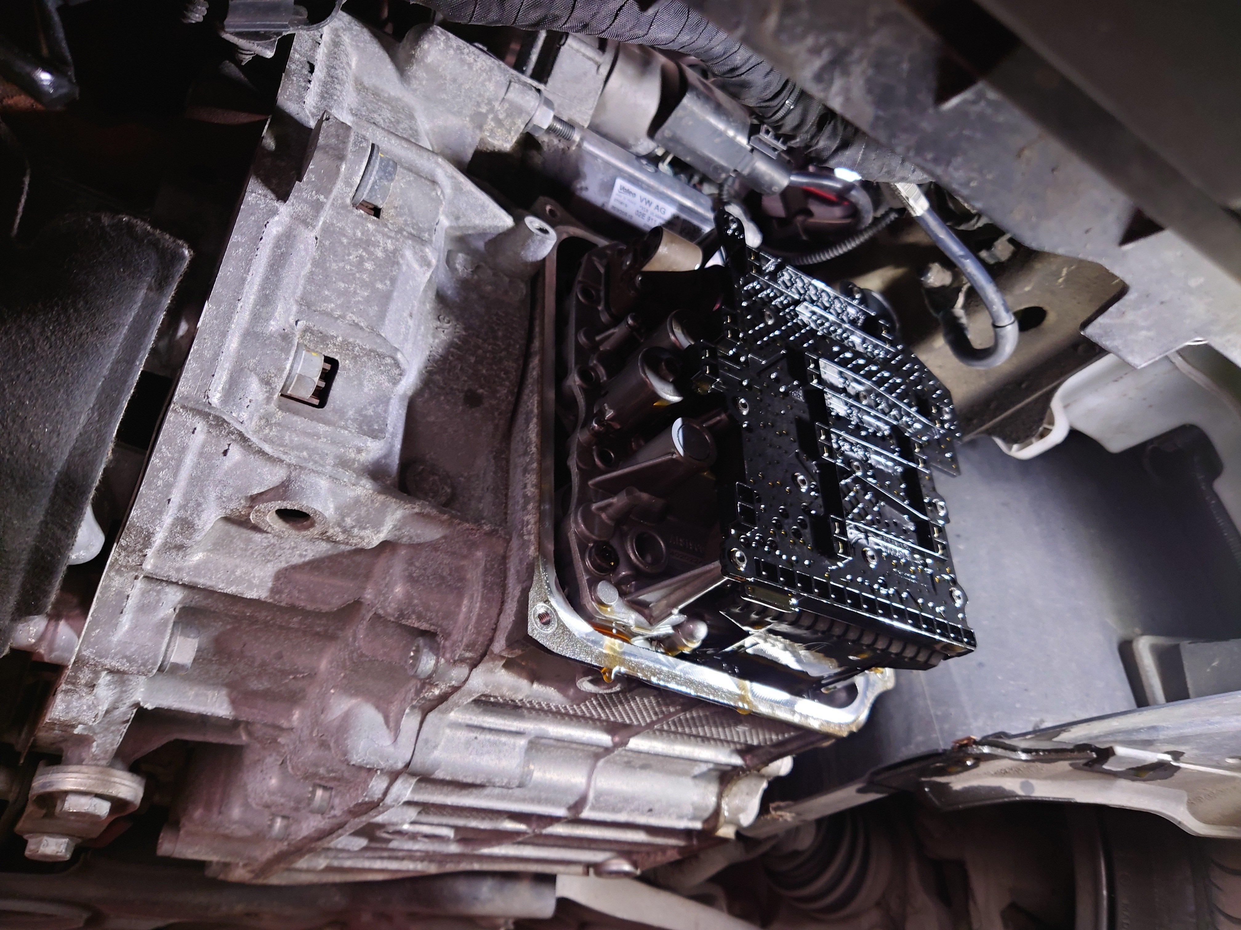

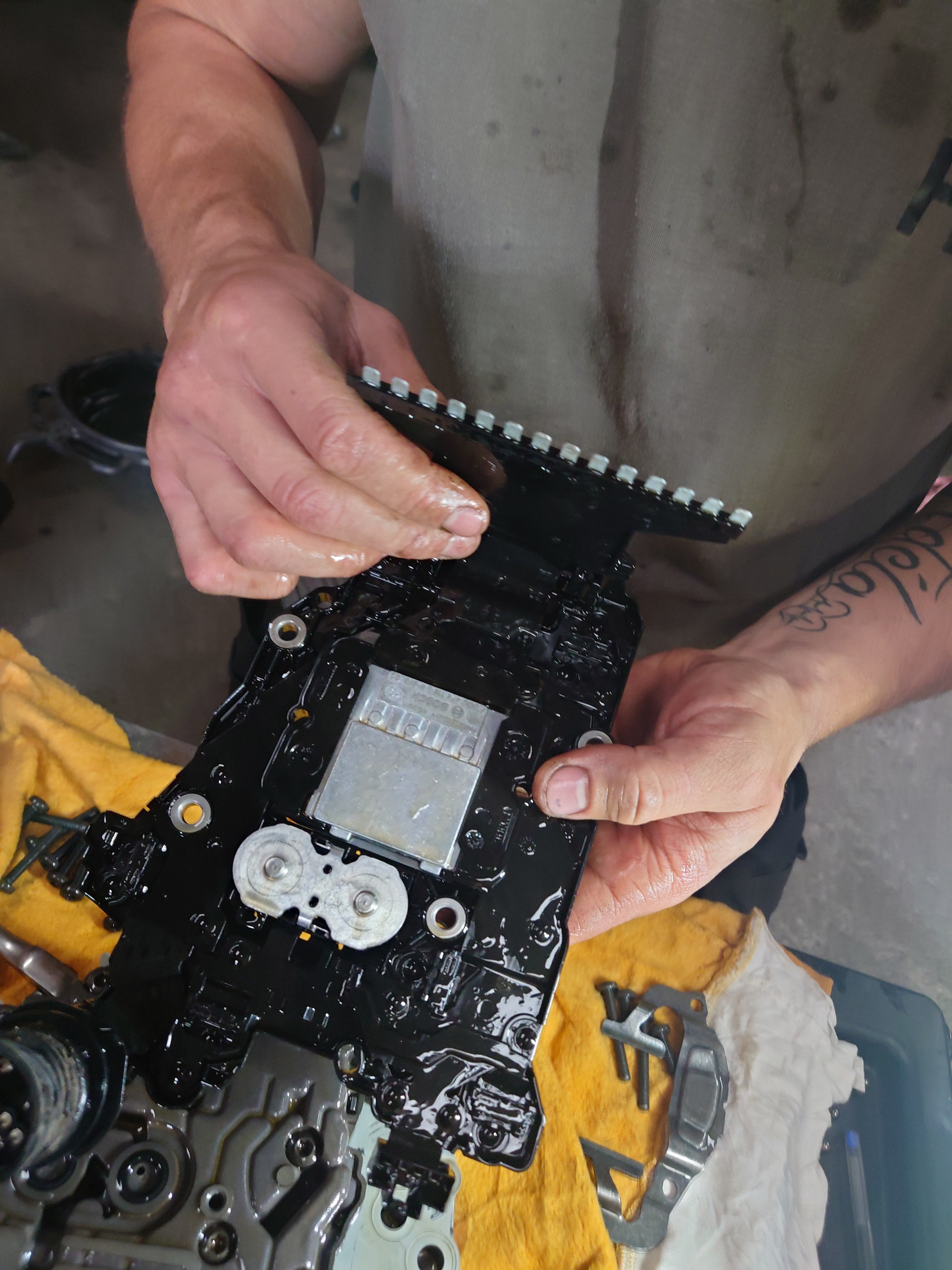

So, hopefully the final update.

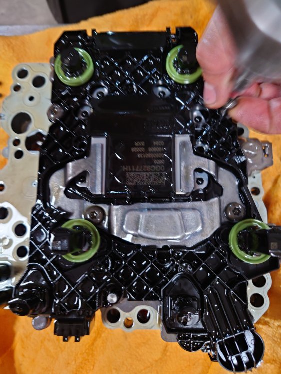

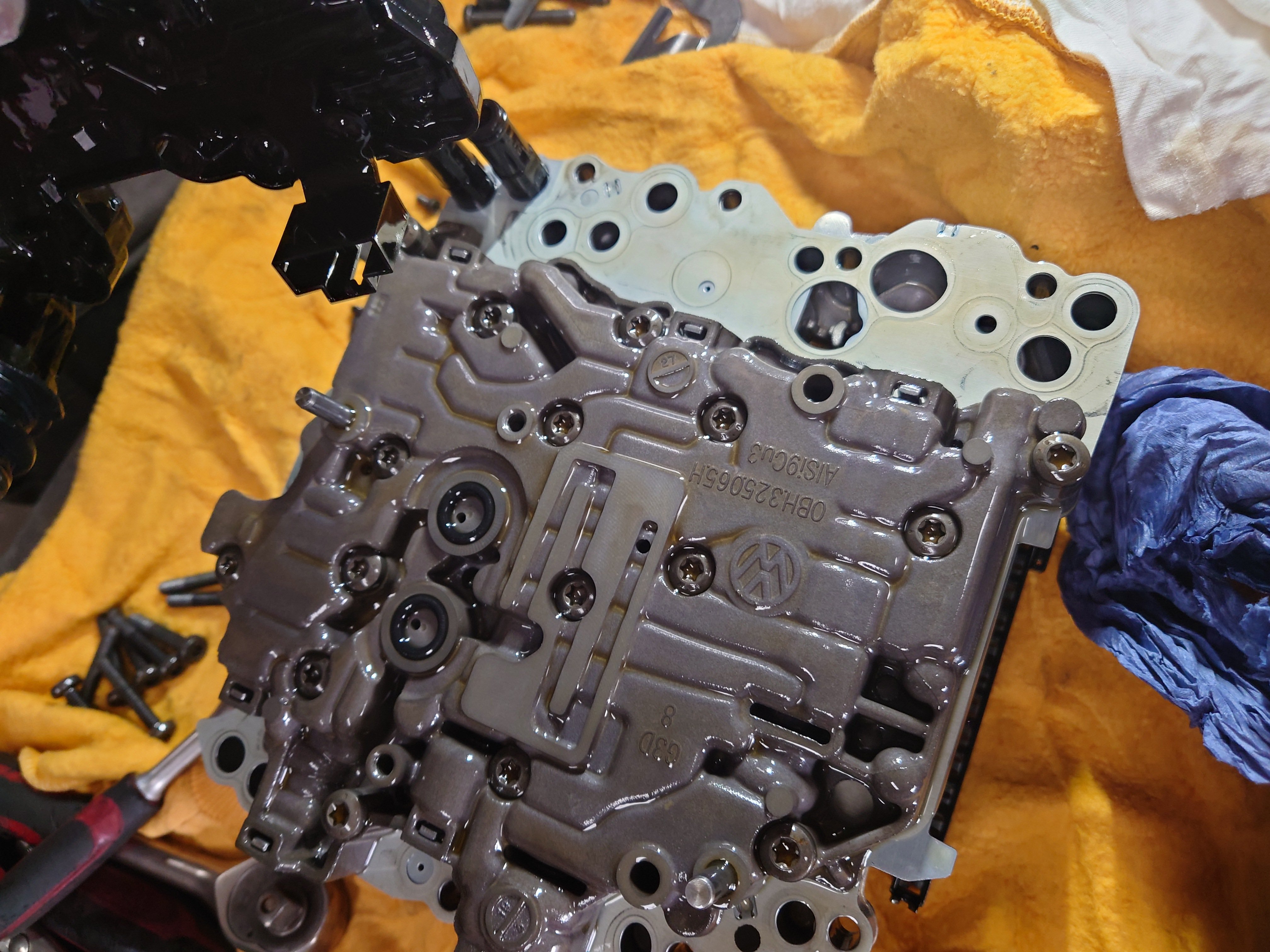

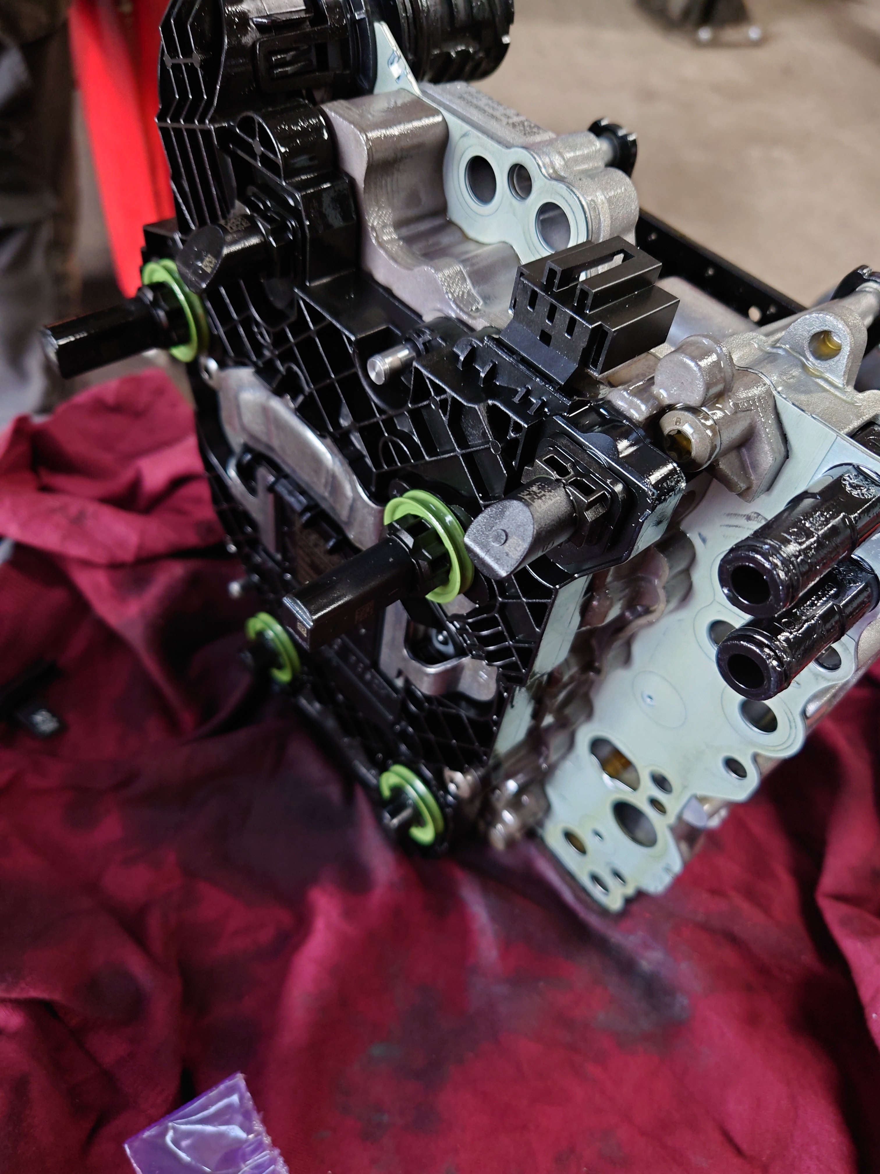

After receiving the MCU back from ECU.de in Germany on Tuesday, I scheduled the time to refit it this Saturday. All in for the complete job it took less than 2 hours.
We refitted the new supplied O-Rings on the MCU before install. Replaced the filter and refilled the DSG liquid gold AKA, Oil.
I'm under warranty still for this work, already agreed. I purchased and will be reimbursed due to the fact the garage I purchased from is 3 hours drive away. I said I'd do it locally and cover the labour. They would pay the parts.
20240727_171934.thumb.JPG.fa4dd61465633354991b56fda06ff576.JPG20240727_173148.thumb.JPG.b7c916146249f850a1cd3fa919ce17ee.JPG20240727_174900.thumb.JPG.521dfdc0ab80b0b85270cbe868362f17.JPG20240727_182626.thumb.JPG.87c1595252f931102eaefb6b0a98498a.JPG
Edited by defsix
And the total cost for parts... €861.93 Incl VAT @ 23%
20240727_2029332.thumb.JPG.672c6dd69ca954f720264d9c57660679.JPG20240727_202847.thumb.JPG.d0be5f9f24cfb4f723a69e83c8453a54.JPG
Plus my mechanic and my time.

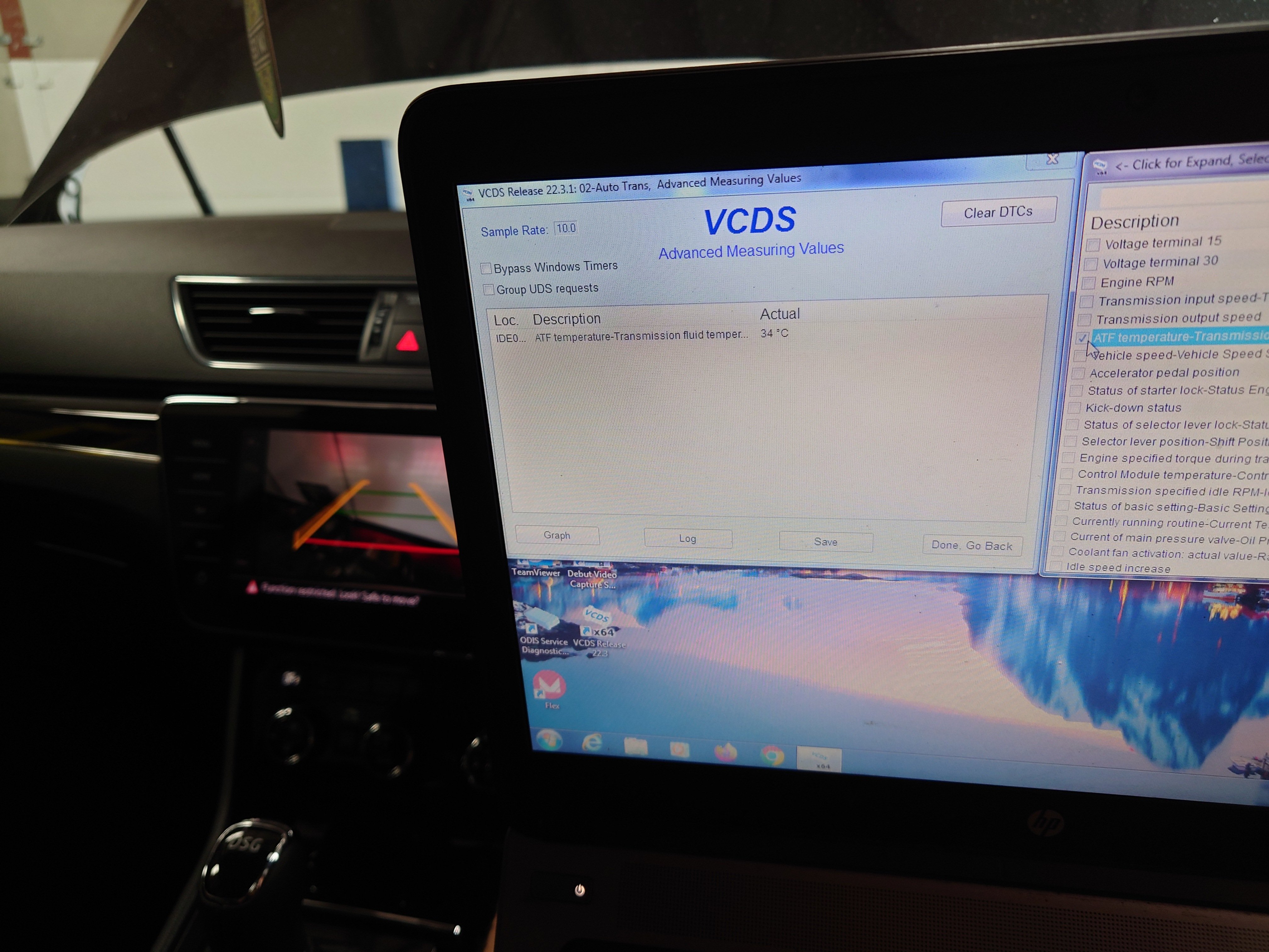

I got an error code and checked the pressures. It was giving me a minus value so I'll include all this when sending.

I used a launch code reader and recorded the values but I can't find the recording now.

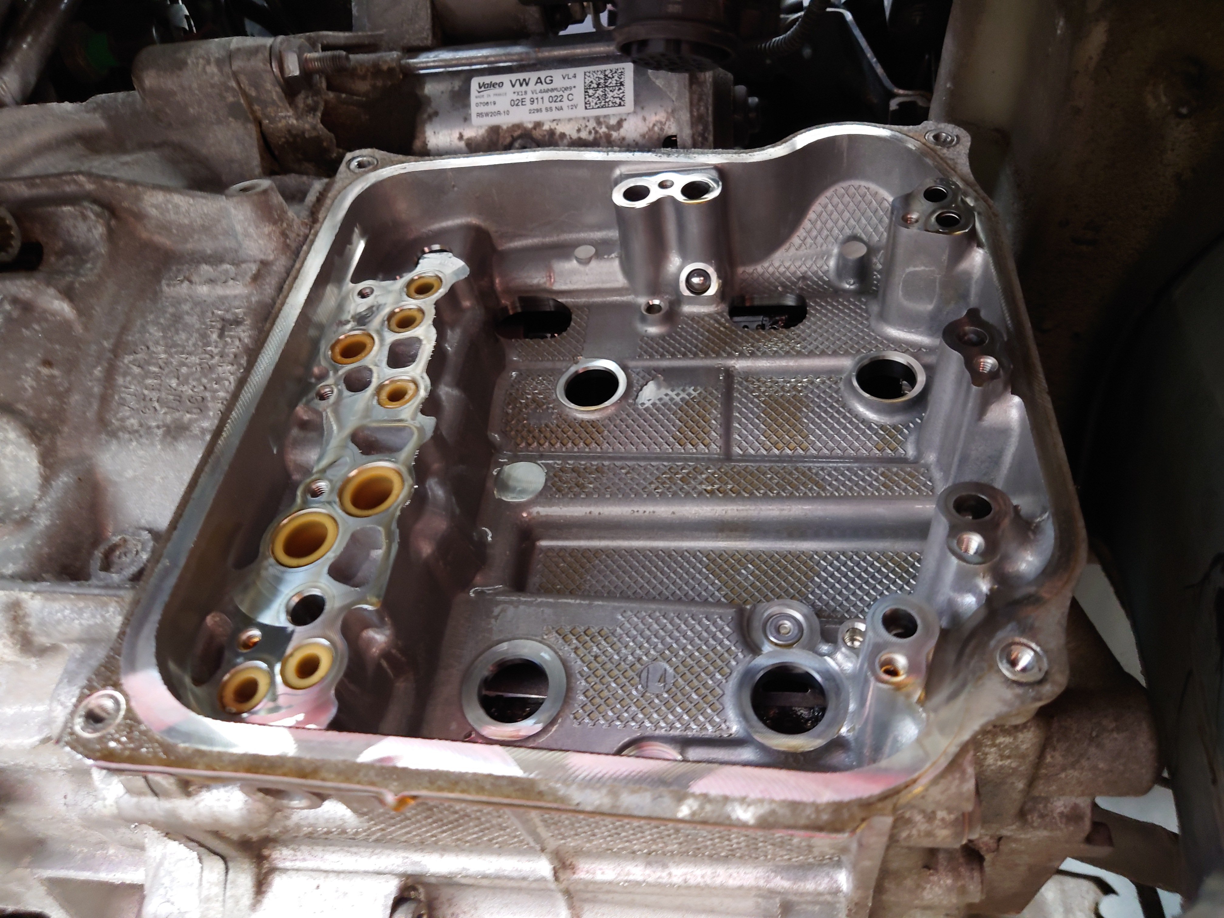

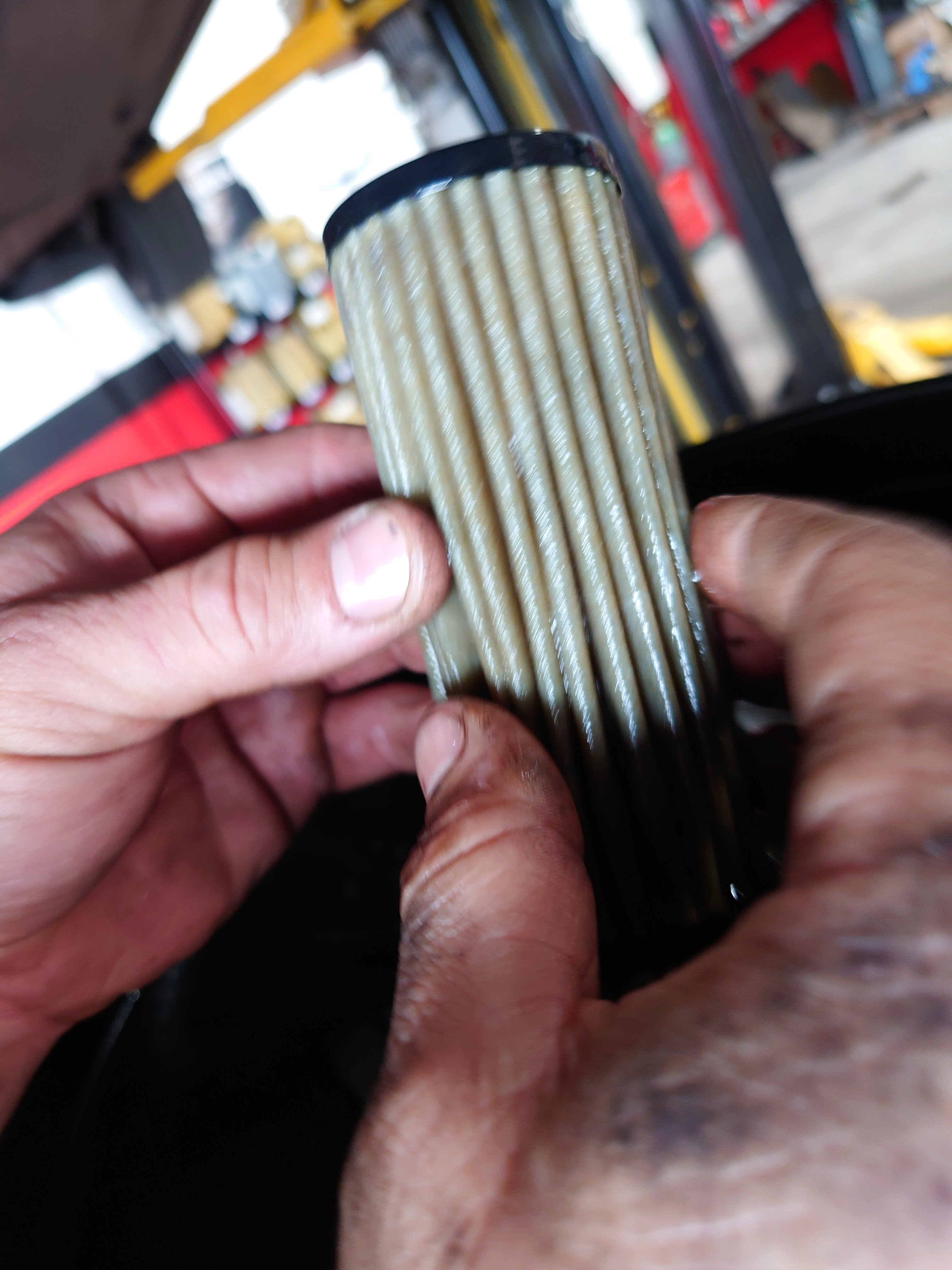

I Pulled a lot of bits to get to the filter easier and have a better look at what the top looked like.
Filter was clean so that's good.
I plan on doing the oil and filter when it's going back in. I've ordered a basic filling tool that screws into the sump drain and on to the 1L can. Gravity will fill it up.
It's on stands at the moment so I'll have to drop it. Let it drain fully and then service and test it.
