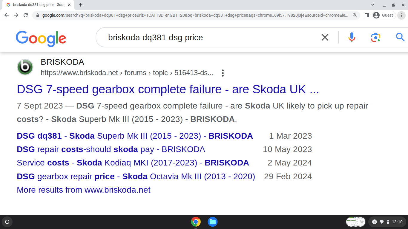

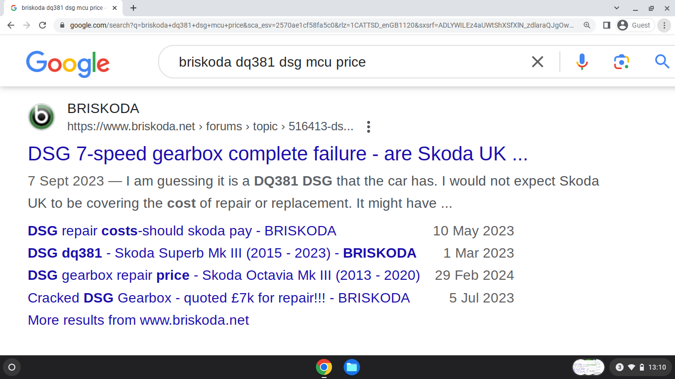

Good then that you have a DQ500.
DQ381,s MCU,s are failing in 2020,21,22,23 & even 2024 vehicles.
