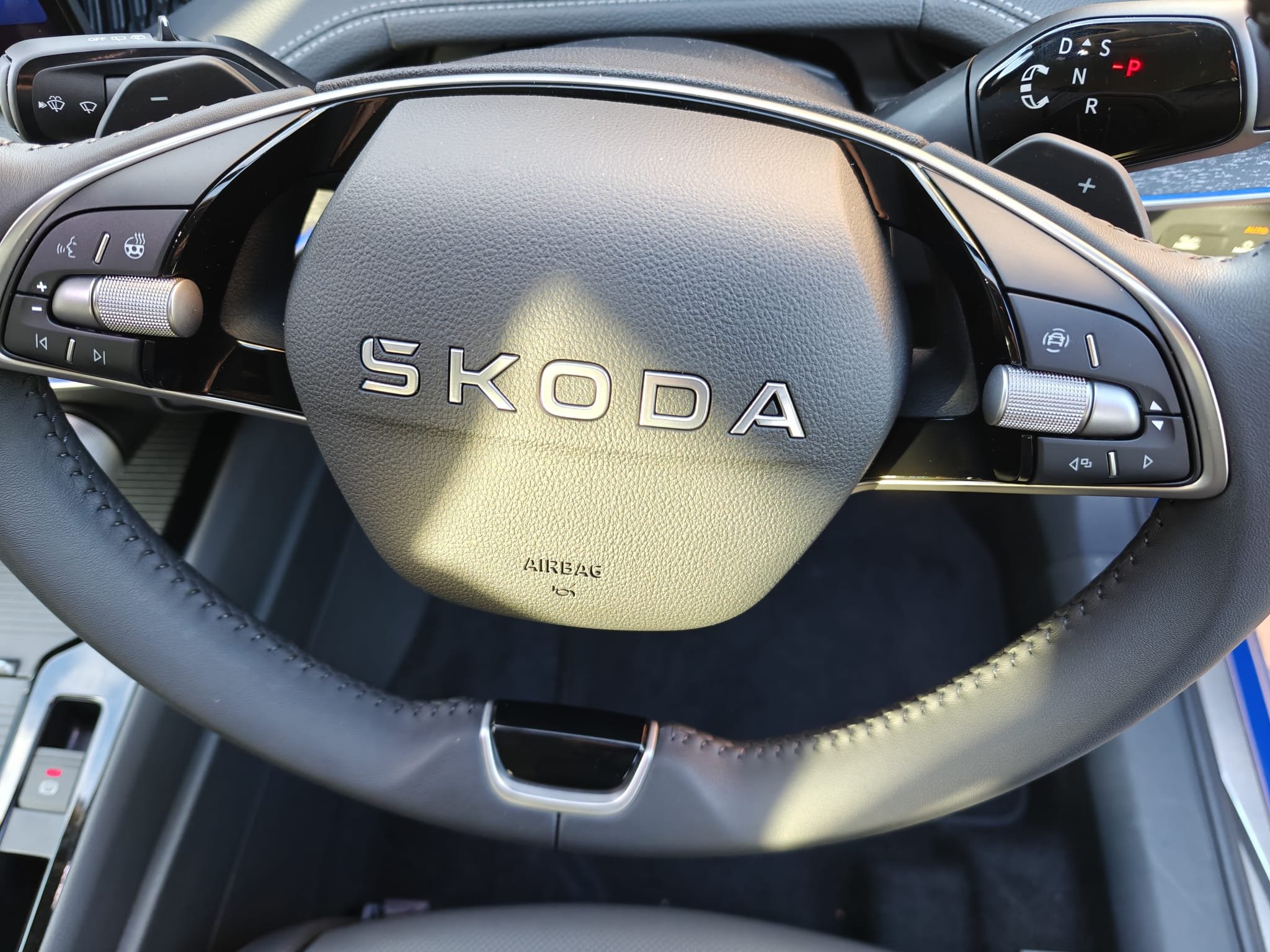

@CowsGoMoo  Waiting on delivery of mine should be sin a week or so according to the dealer. Out of interest. What steering wheel did you get?  Škoda logo or the word Škoda?
Good question, mine apparently was one of the first batches of the new Word Style logo'd steering wheel.
OOOOH,
Subtle is different... Is this the SEL steering wheel or will that be the one now? I am sure they could have got the lettering even bigger.
Software is definitely an improvement.
I've been told the same, so mine may be on the same boat  ... dealer has assured me that the software update will be checked
I did add the winter pack which changes the steering wheel from the stock to the two spoke one pictured.
