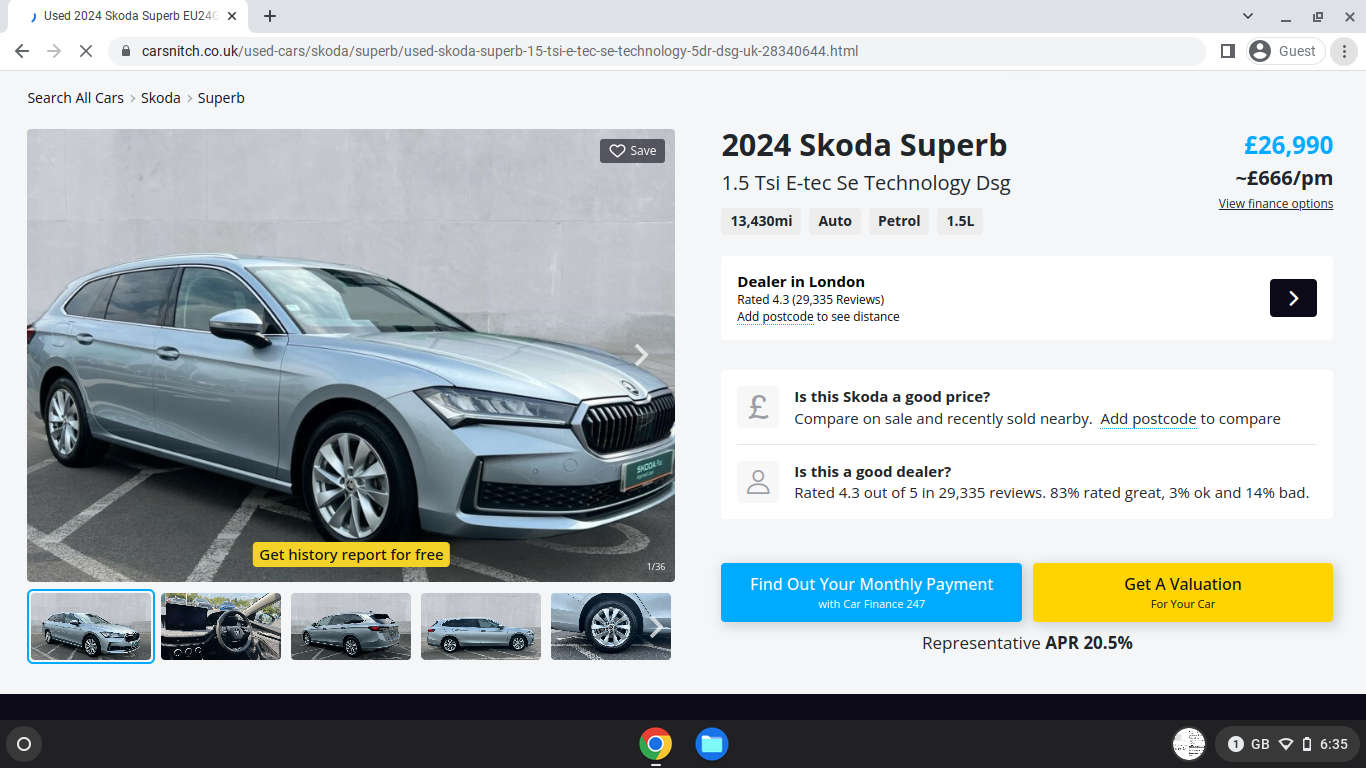

Can you please help me in identifying what gearbox type is in this 2 superb estates?
reg: EU24GFO
reg: EU24HFT
Thanks
Jon
Edited by kannanni
7 minutes ago, kannanni said:
Hi Pete,
reg: EU24GFO
reg: EU24HFT
Thanks
Jon
First one is a 1.5TSi etech so will be a DQ200
Second one is a 2.0TDi so will be DQ381.
For the Mk4 Superb.
1.5 = DQ200 7 speed dry clutch
2.0 = DQ381 7 speed wet clutch
PHEV = DQ400E 6 speed wet clutch and electric motor.
@Breezy_Pete should be able to confirm.
First one is a 1.5 TSI PHEV an iV so a DQ400-e DSG, 6 speed wet clutch. (oil and filter changes of the DSG @40,000 mile intervals.
the 2nd a
2.0 TDI so a DQ381 7 speed wet clutch DSG.

First reg is a DQ200, gearbox code WGS.
Second is a DQ381, code WFQ.
Lee wins the gold star for today.

VW Skoda call the DSG for the e-tech a DQ200-e
@kannanni the idea of the Mild Hybrid and the DSG was to get the emissions but to keep using dQ200,s.
