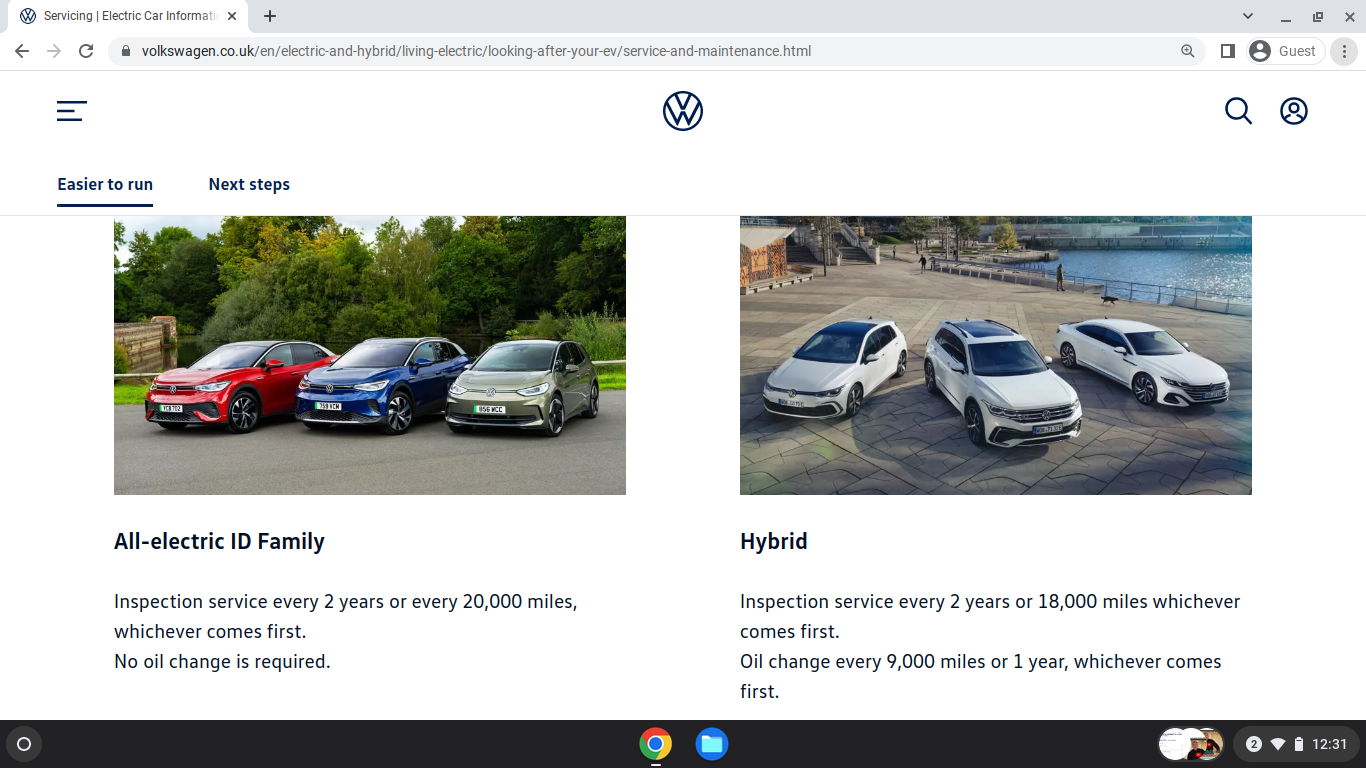

Read the Warranty T&C,s an then get in writing if the Servicing need not be by the Manufacturers Recommendation, Guidelines, Schedule or Specification.
It is fixed Oil & Filter changes.   VW have said 9,300 miles in the past and 12 months and Skoda 9,400, or the usual, they have no idea so say 10,000 miles.
DQ400-e DSG service every 40,000 miles or sooner.

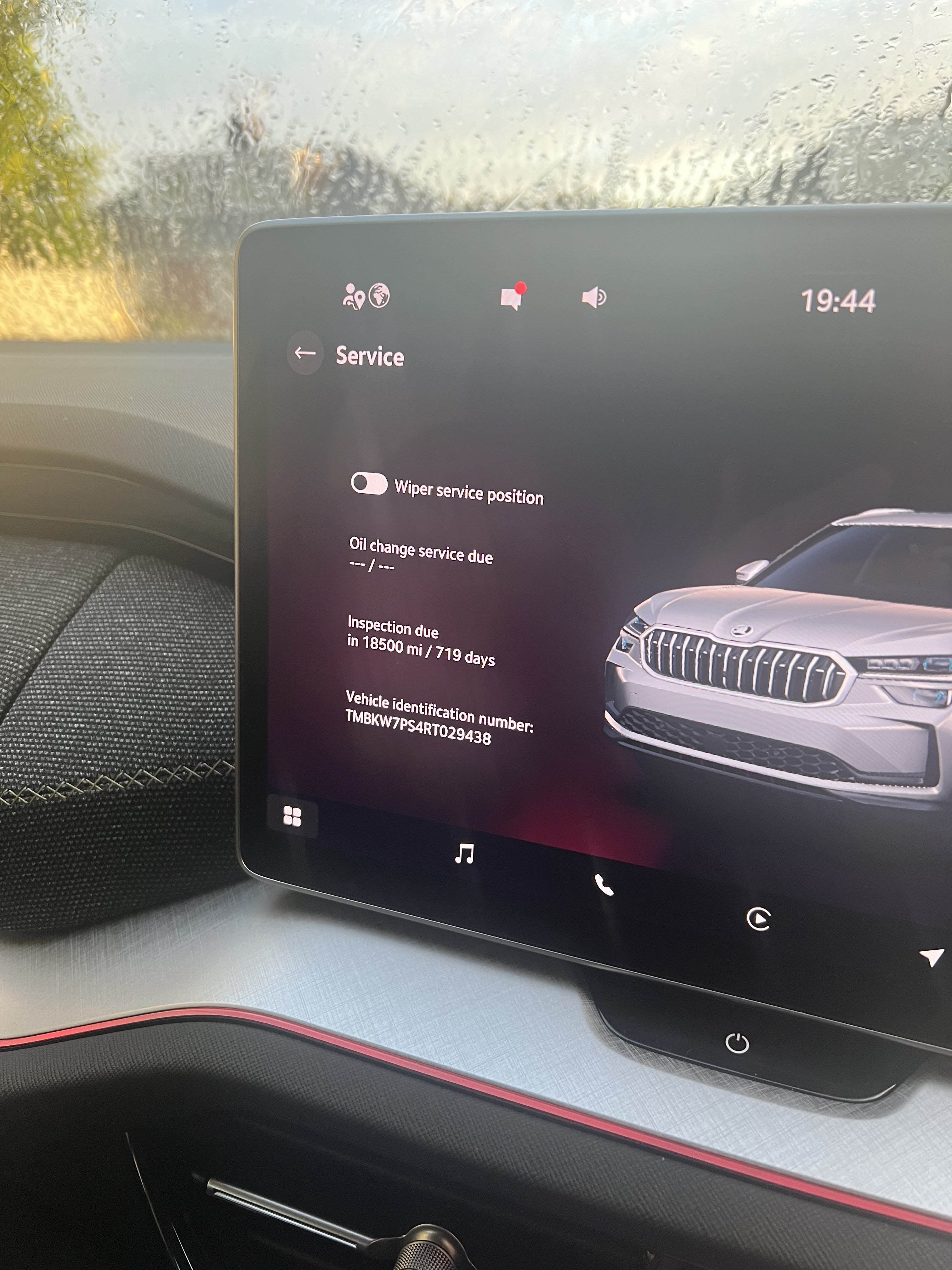

I guess I can wait for one year or 9000 miles to elapse whichever comes sooner and see what the car tells me as regards oil change and or service, and in the meantime I could contact Skoda support for their take on it
@Jimbobby12  Is you cars Service Indicator not showing now when the first service is due.  Miles & days?
If this crowd deal with your enquiry it will be interesting in the answer they come back with if they refer to a Technical Department (call a friend) or advise you ask at a Dealership.
Others will need to know the 'Official advise' on 1.5 TSI PHEV,s.

This is all I’m seeing on the service menu.
Strange.
All others leave the factory set on Variable / Flexible servicing but the PHEV should be on Fixed Oil Changes.
I wonder if it was reset at the PDI when changed from 'In transit' mode.
