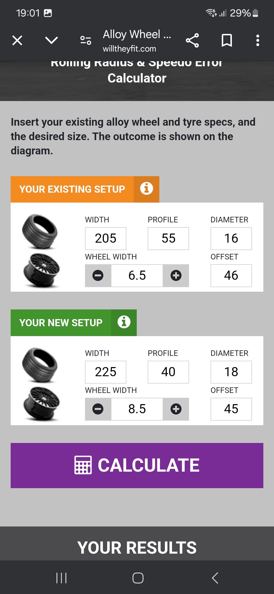

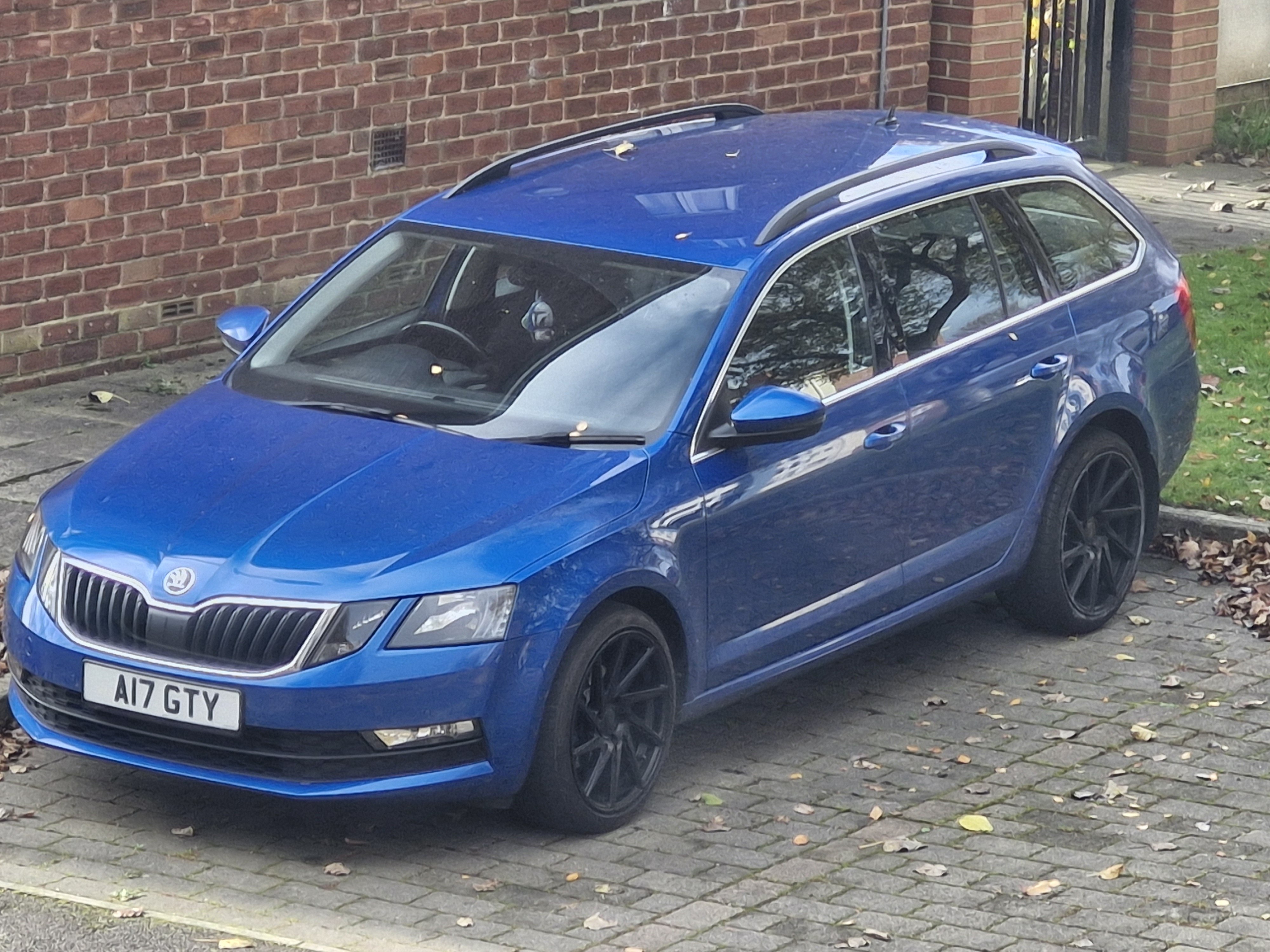

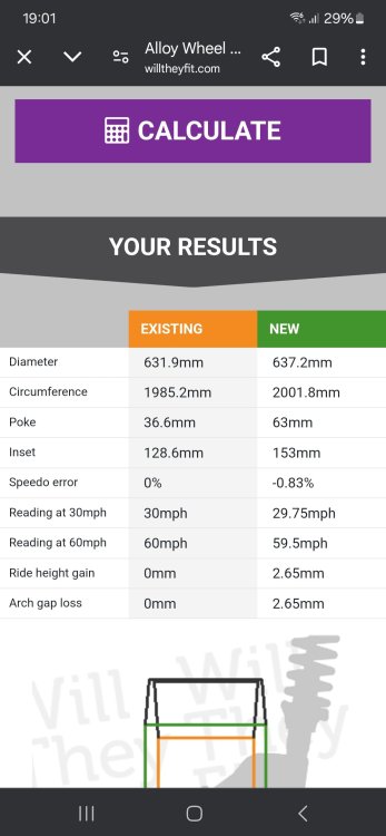

Hello can anyone help me with adjusting the mpg calculation on MK3 Octavia 2020? I've fitted larger wheels which I believe the car is going slower than it thinks affecting the readout on instrument panel.

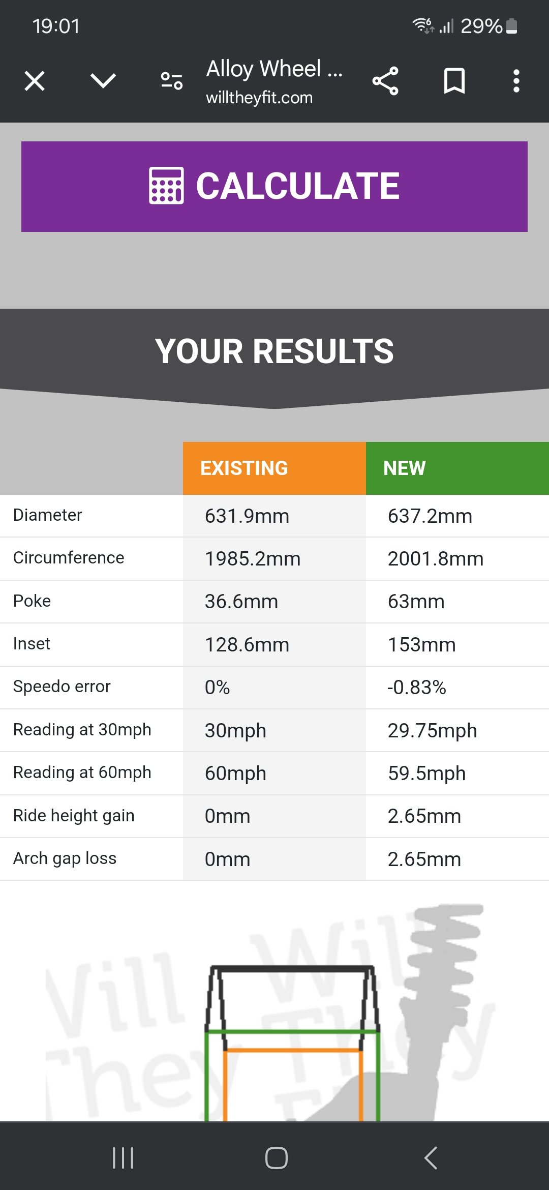

So, less than 1%.
Don't forget that the larger wheels/tyres will also increase you fuel consumption.

There are websites that give information to show how complicated this sort of thing is and at 1% change I'd guess you'd be within margins of error and variance.

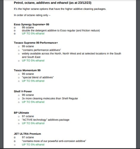

Can you do your car / engine a favour and use Tesco Momentum 99 ?, lovely stuff in the North East of England.
Shell V-Power is the same base fuel, just a different additive package and more expensive. Not superior.

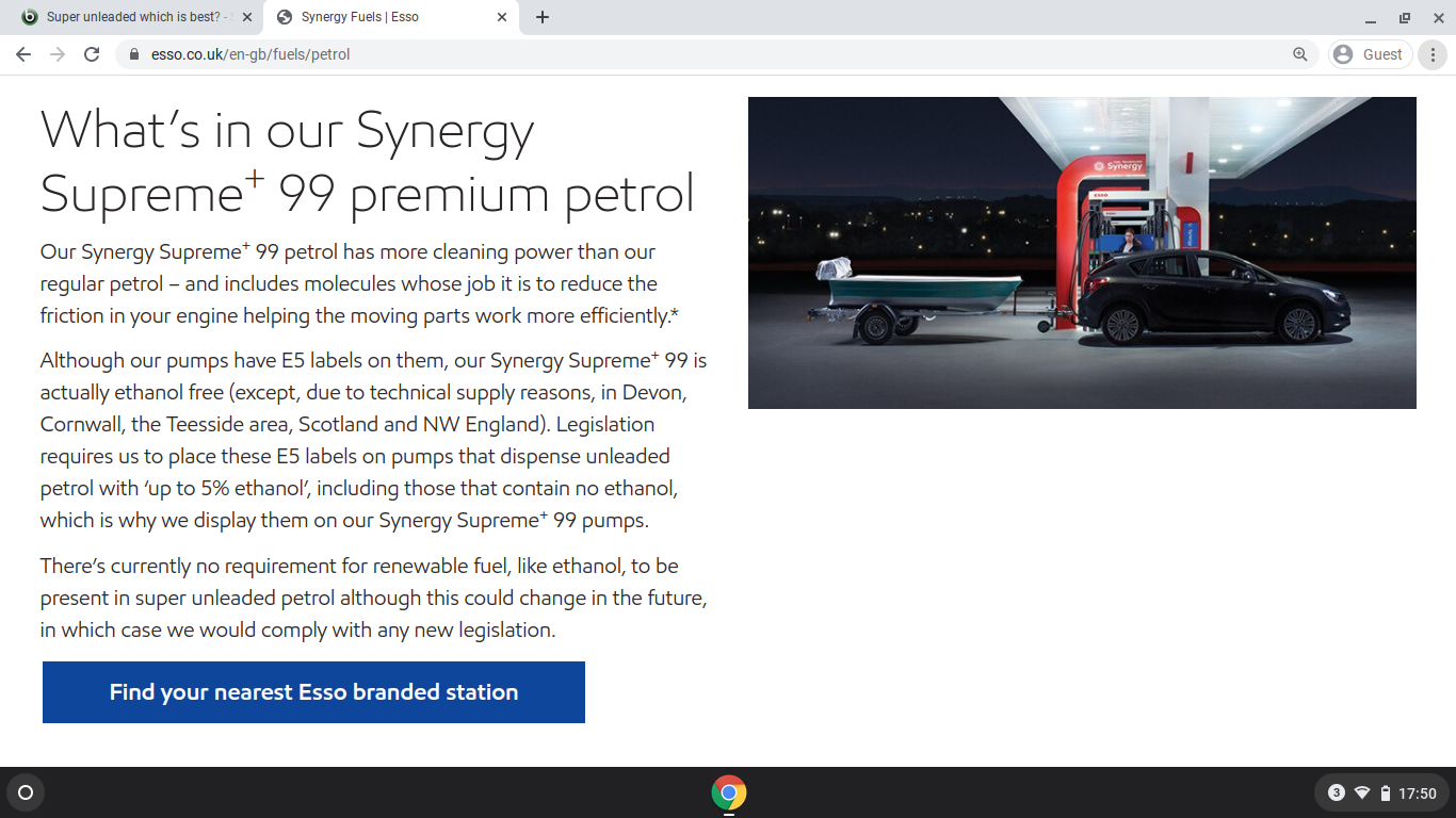

Esso where you are is delivered by Greenergy who produce Momentum 99.
Esso Synergy + 99 up north is not Zero Ethanol as in some areas of the UK.
TSI,s (Turbos love Ethanol, but it is Hygroscopic so less is in petrol in winter in the UK.)

Maybe in the North East they have it 0% Ethanol, and from a different depot, not from Greenergy.
622074614_Screenshot2020-11-26at17_50_05.png.4fb0d07c142f155cf5fe2ef5c30c0801.png.1190f853c596d950efe2fcce69af3c0c.png
E5 will meet the Minimum Octane it is sold at, but that does not mean all around the UK the same Super Unleaded is the same,
it can have a higher octane / ron than the Minimum it has to be.

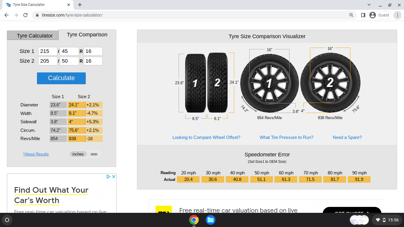

I currently have rapid 2014 elegance spec alloys with 215/45/16 tyres
which size tyres can i fit to this alloy that give a more comfortable drive

What is fitted now, brand, speed/ load rating, are they XL tyres.
A size change might not be more comfortable, depends that they are in the size.
Then as far as safety you might fit a tyre with more grip / friction / traction and be less economical but be more surefooted, safety over economy.
The guides are not always accurate when you put a tape measure around different tyre types / brands / tread depths.
