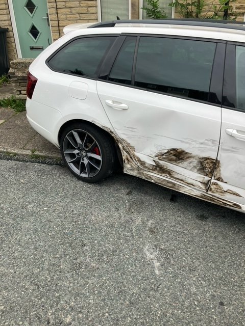

Ive got a 2018 Skoda Octavia 2.0 Tdi VRs Estate and have owned this since april this year. Unfortunately it was written off back in July this year and was declared a Category S. Now the insurance company offered me the car back for pennies, I couldnt refuse it
Now i have just picked it up from the body shop and it is all repaired (bump was OSR quarter and both drivers doors)

Yes it does not exceed 20 mph in any gear, its a 6 speed manual gearbox, it revs to 3000 ish rpm in neutral with no hesitation, i dont believe the crash sensor was activated, as the vehicle was parked up when the accident happened. No airbags were deployed as again the vehicle was parked up when the accident happened
Pic attached of damage sustained
