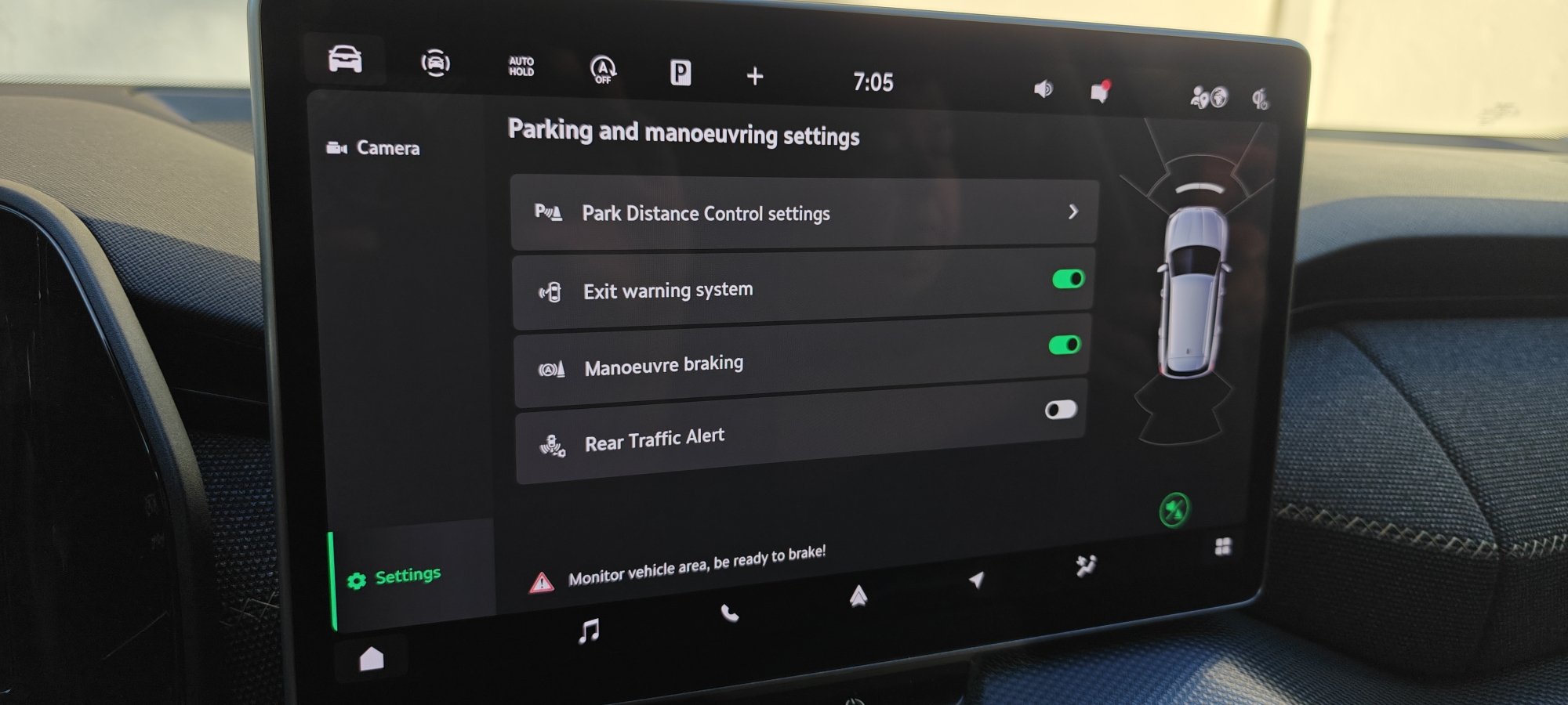

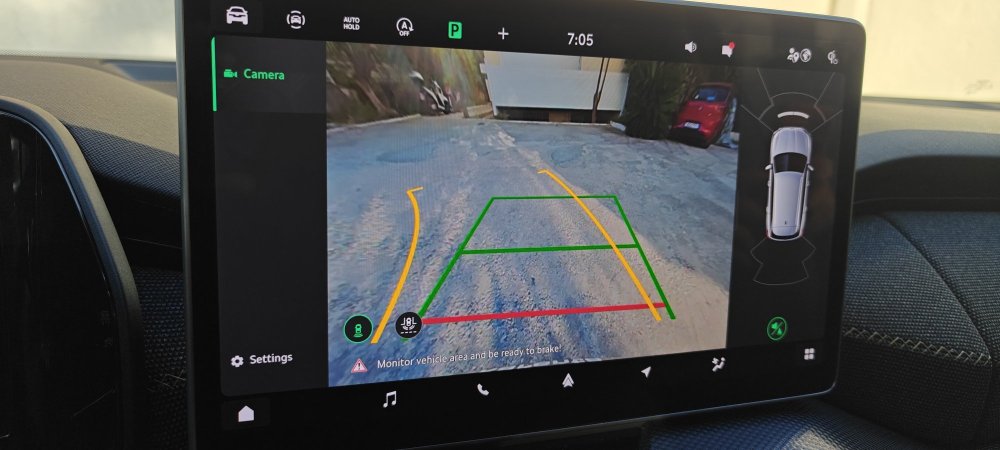

Here is how I did it. Actually, my dealer showed me.
  1. Click on the "P" option, or find it on the Car menu. That's the one that activates the rear camera.
  2. Click on "Settings" on the lower left corner
  3. Disable "Rear Traffic Alert"
That worked for me. Permanently disabled.
