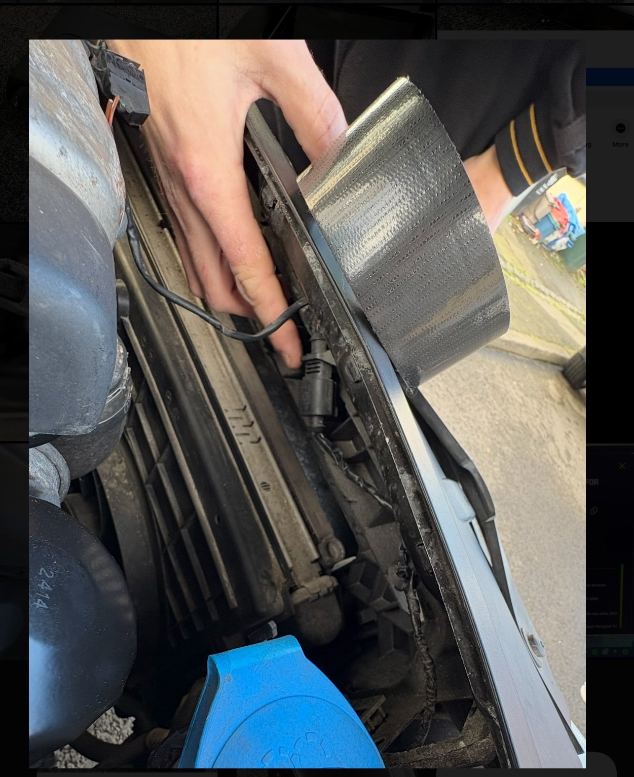

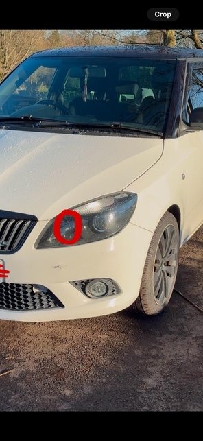

Anyone possibly know what this connection of for as there is a broken wire on it but I think it’s my side lights as they will not work any clues what it could be ? I have got a photo of the wire that’s broke but it won’t let me upload it you can see the connection at the top of my hand though

Do you mean the DRL / Sidelight units do not work?
Do the DRL,s work?
There are no Sidelights in the Head Lights.
From your other thread on Brake Lights the car seems to have a few issues with wiring and fuses.

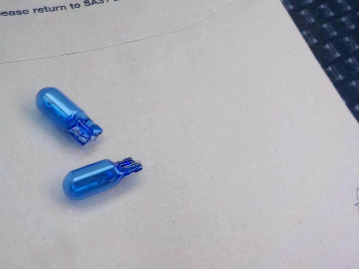

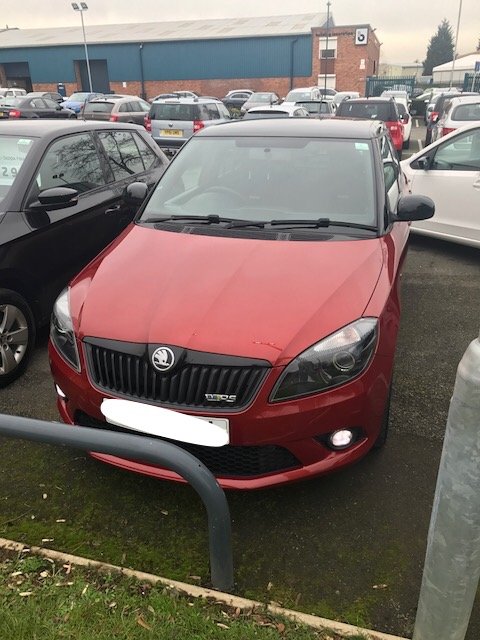

Yeah the DRLS work they are at the bottom of my car but in the headlight area I have 2 bulbs just the main beams work and not the ones next to them and just guessing there the side lights
There are 2 blue DUMMY bulbs in the headlights where sidelights would be.

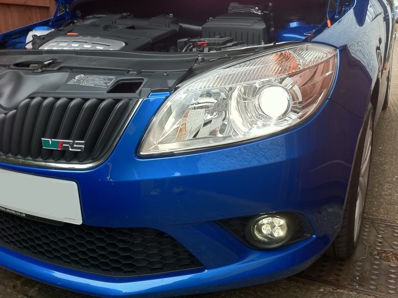

DRLs, on when no lights turned on just ignition on. and when on as sidelights they go dimmer.
The DRL,s are Sidelights and dim when you turn on Sidelights or Sidelight and head lights.

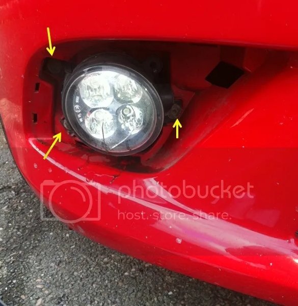

My bottom lights are LED Lights
It’s the ones in that area that don’t work
The Bottom Lights are LED units. That can have bad connections. You buy them as a unit.
They were bad for corrosion as much as a decade back so now that your car is 12 years old best look at the back of them.
They are the DRL,s and become the Sidelights.  Inless the car hasbeen modified like @UrbanPanzer did.
