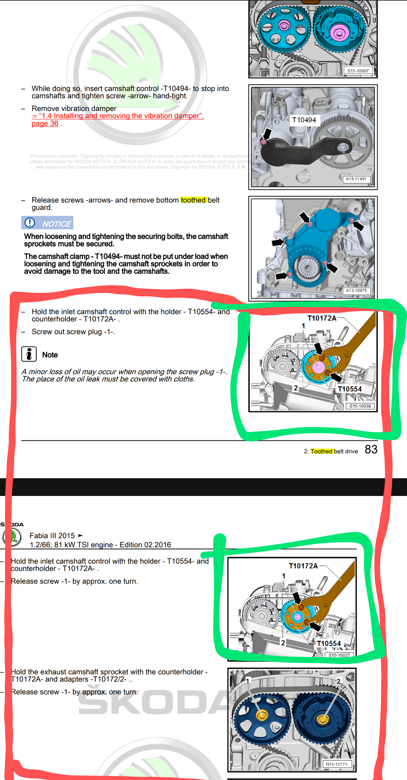

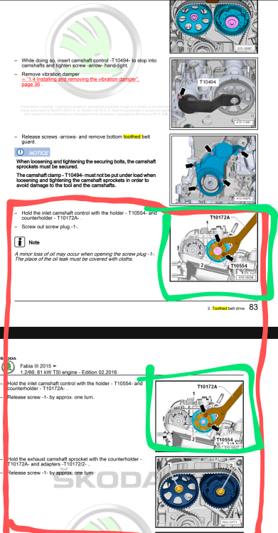

My question is about the tool used to hold the pulley for removing their attachment bolts. Is this tool necessary if I don't intend to remove the pulleys?
See this screenshot and the steps circled in red (and the tool in question circled in green):
They seem to suggest removing the pulley bolts but I'm not sure why this is necessary for replacing the belt and therefore I'm questioning if the tool used to do this step is necessary for replacing the belt also.

If it is not actually necessary to disturb or remove the cam sprockets, holding tools are possibly not required so long as the camshafts stay locked in position - but this is a job I would rather pay a tech for. I'll flag this to @ApertureS for advice for you.

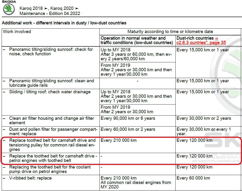

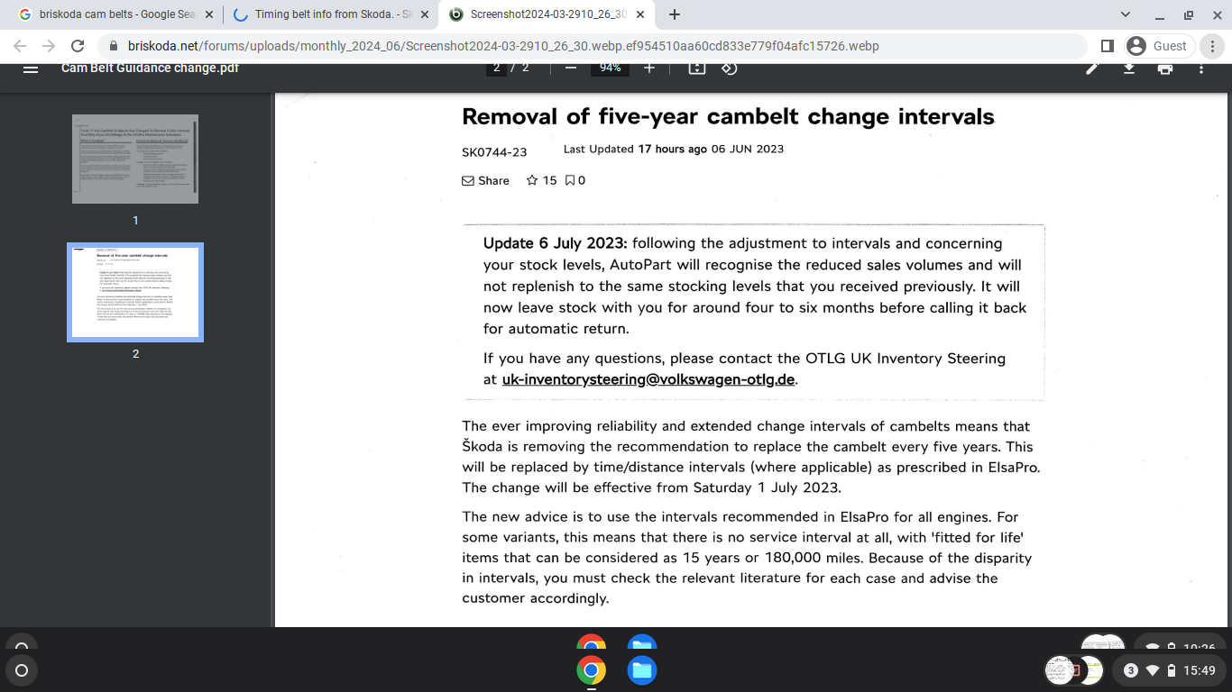

Up to you but 110,000 km might be a bit early, you could just give it good inspections until 150/180,000 km (IIRC even VW say 180,000 km or 15 years and IIRC some belt manufacturers say "life".

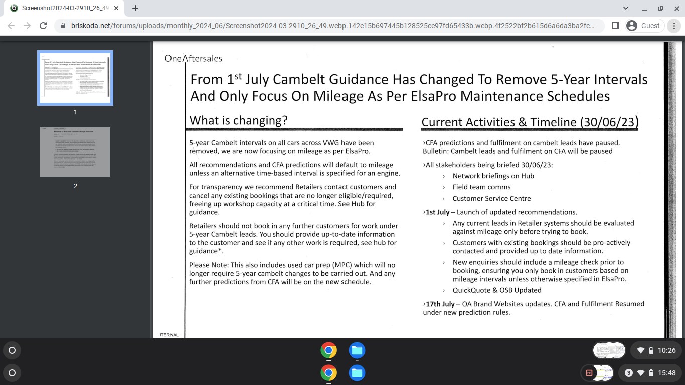

ETA: I couldn't find the details to post where VWŠkoda UK finally coughed up and admitted the belts didn't need changing every 5 years/ 50k-miles, too late for us as they robbed us of £430 ! (robbing !"£$%^& con-men).

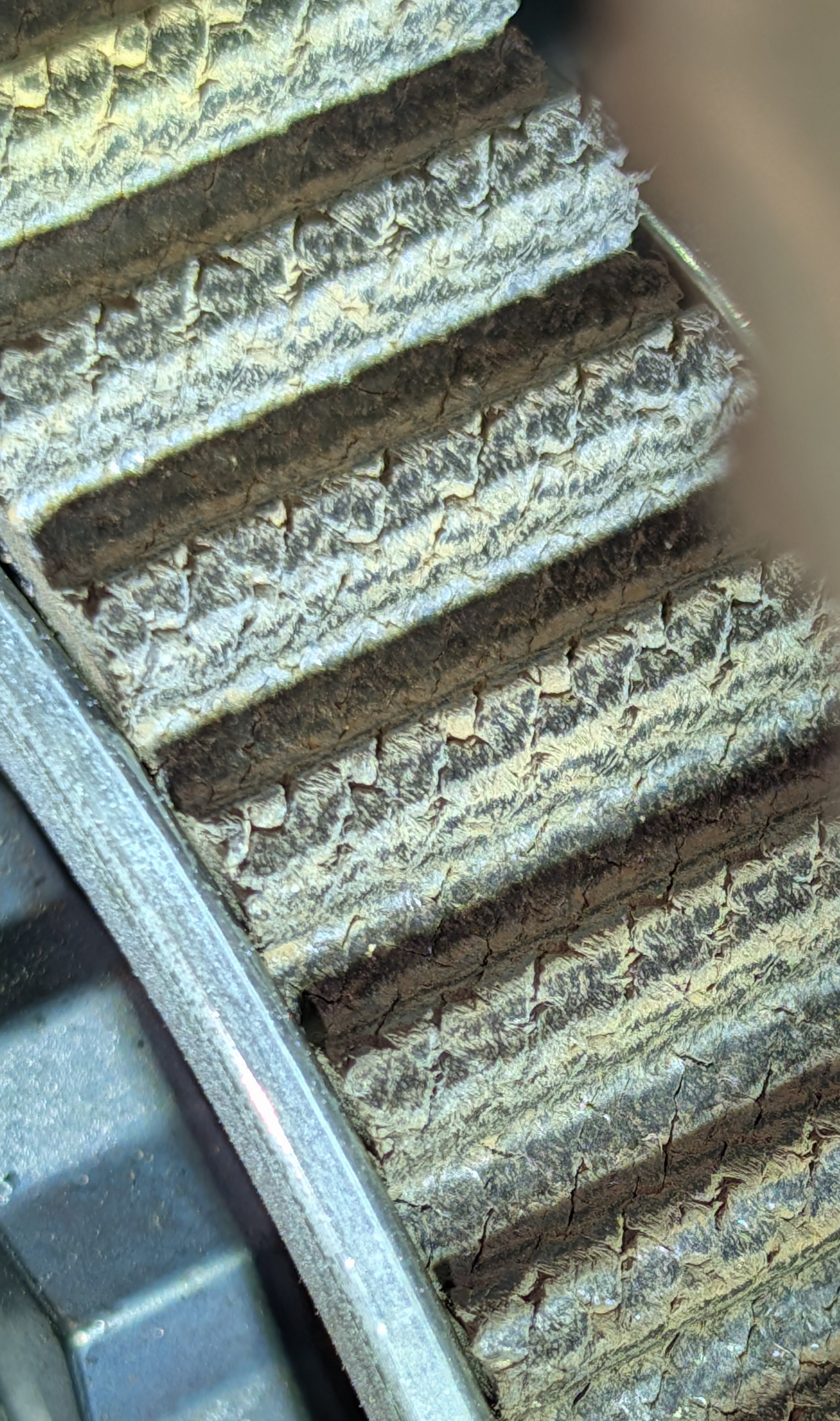

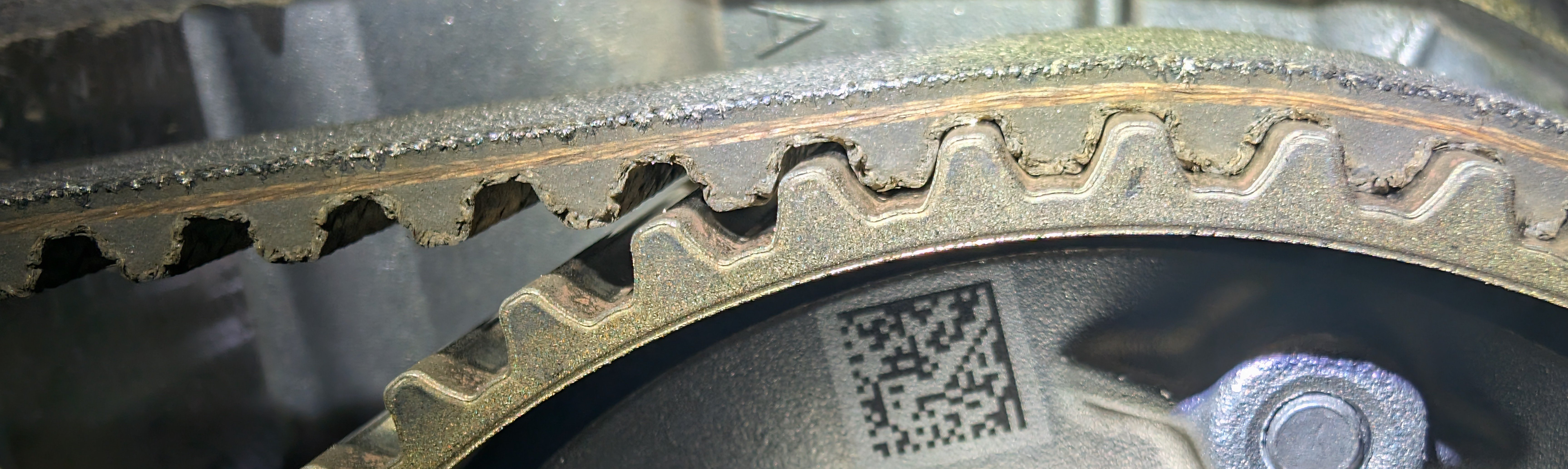

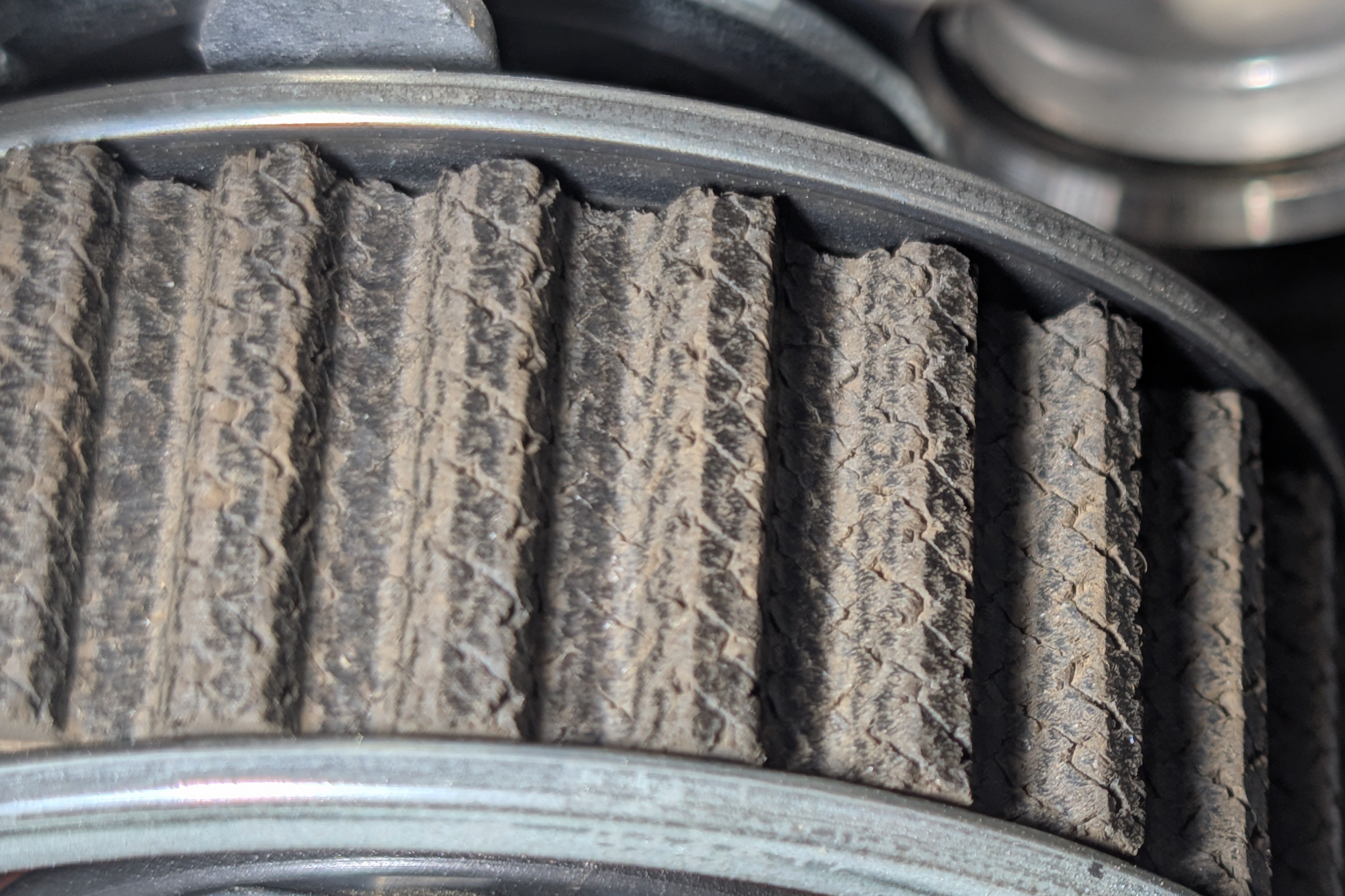

Yes. 1.2 tsi with the whopping 66 kw. In any case I've had a look at the belt and it looks to me to be a good amount of life left in it but you can be the judge because I took some close ups.
Skoda / VW UK were taking the pith.
The UK is counted as a Dust Free Country & should neverhave been @ 5 years / 50,000 miles.
But it was a money maker.
Then the 1.5 TSI ACT,s were 6.5 hours to do, £850- £1,200 quoted and not the £550 as before.
Not only were owners not doing them at 50,000 miles, they were trading them in and Skoda / VW Group then have Used Cars that they would need to spend their techs time doing. Even if quicker than in 6.5 hours.
If not done then FMDSH and stuff done to Guidelines was out of the door. So Simply Clever, change things.
Hey presto, no more 5 years / 50,000 miles. (Check different engines, eg TDI,s)

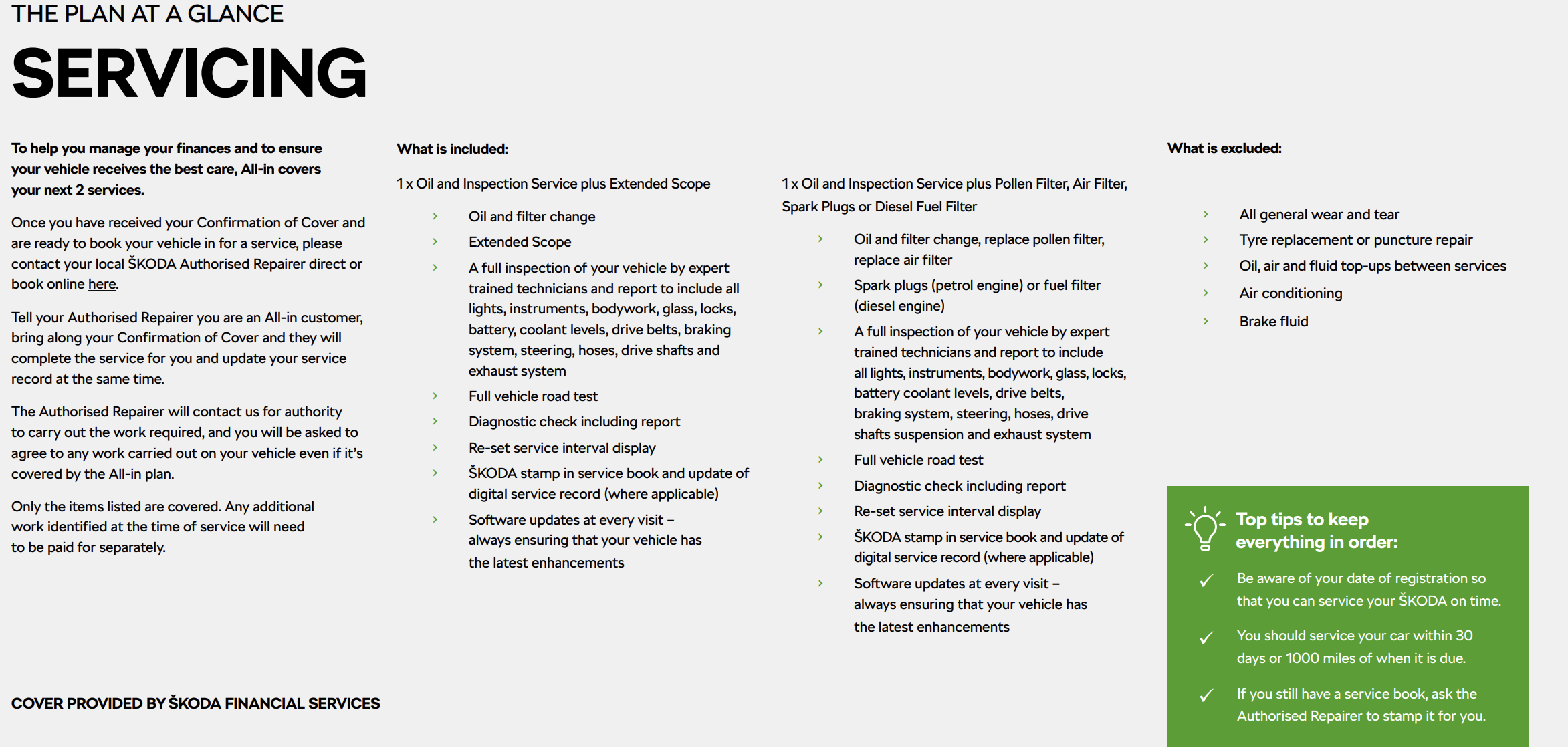

How it was pre June 2023. Just not according to UK Main Dealerships.
I leave those that know better to comment on the belt but don't worry about the 66kW most of the time not much (very little) hp (kW) is needed. Big/bigger hp figures are often more about willy-waving leave that to others, as long as the car can haul it's heavy structure, electrics/electronics/wiring/motors/heater/gadgets, big wheels/tyres, passengers, luggage/loads along and uphill reasonably. Plus you don't have to wear branded sunglasses on a rainy or cloudy day to drive your car. 😁

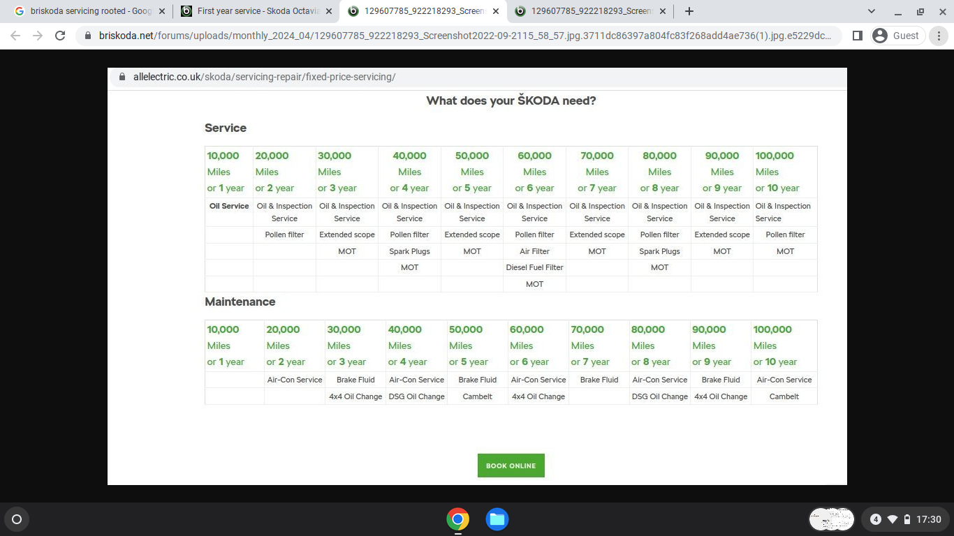

Air filter 90000 kms is too much. Half of that have no sense..

But the Skoda Schedule has been nonsense since they changed the Minor / Interim, Major to Oil & Inspection services and Extended Scope.
Check an Air Filter annually, or at Services. Just not as easy as the old days for many, even techs / fitters.
How many / few cars get the Roof Serviced or even told to.
