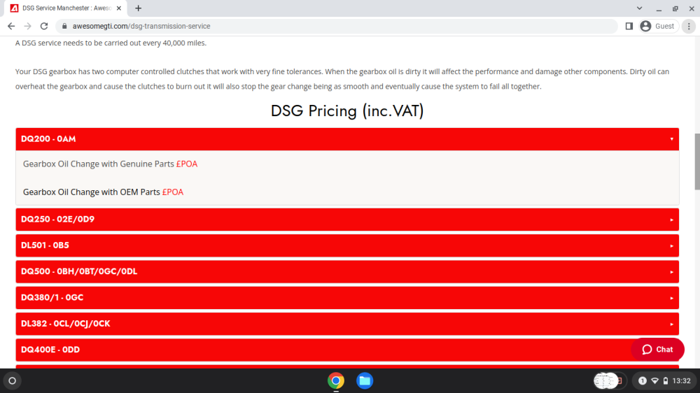

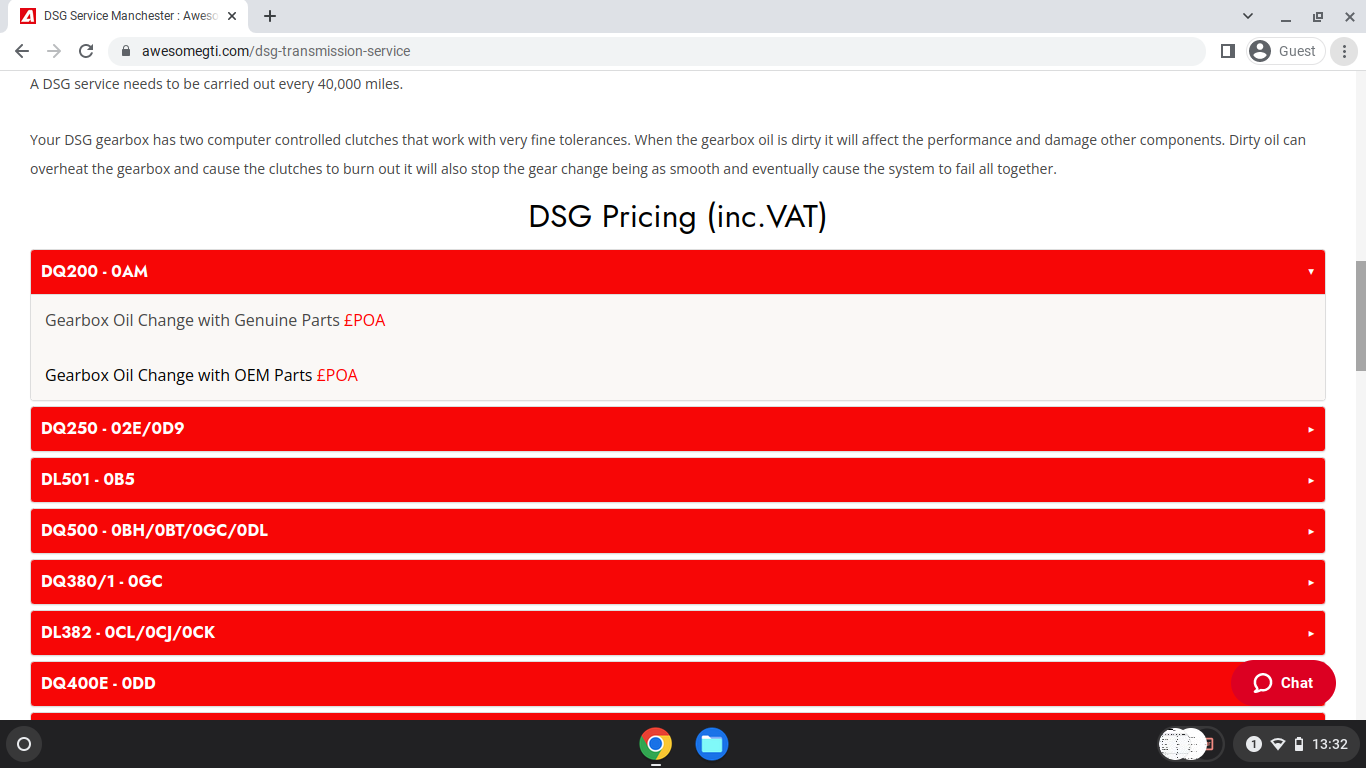

396170444_1405220667_Screenshot2020-10-16at17_25_09(1).jpg.329efe0695a8a0f4fa8725c4326b07a0.jpg.261327afafc0a4d91b2a6516585b45f1.jpg.7523967dafc236006f607ede73e30253.jpg
163686587_585848287_Screenshot2022-12-2814_19_08.jpg.a622554865cd35b0aa0635744f07aef0.jpg.e60e4108650178b3b9c52a5a8ae2dc18(1).jpg.9beece3b2b03366f7f7b8296a640e79b.jpg

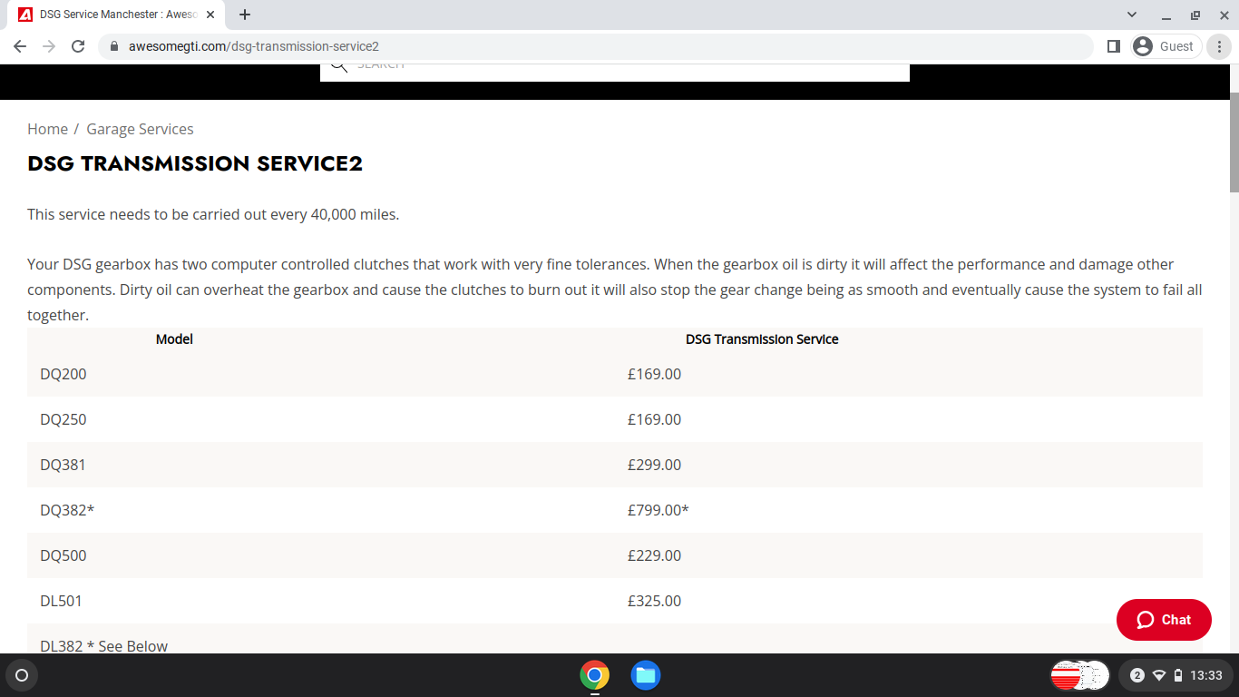

The DQ200 is sealed for life, but it isn't. As @Ootohere has said, both the box and MCU are serviceable. Without wishing to make one of the sweeping statements I advocate against, I would agree that inspecting the oil on a DQ200 every 20,000 miles is absolute rubbish.
The reason these boxes don't 'need' a fluid change is because, unlike the wet clutch boxes, these have a dry clutch pack. They aren't submerged in the oil, so there isn't anything getting in the oil, so there's nothing really to inspect.
The recommendation for all wet clutch DSG boxes is a fluid (and filter, cough) change every 40k miles, with the DQ381 being at 80k (although most, including myself, choose to do it at 40k). I find it hard to believe that anyone would suggest checking a DQ200 at half the interval for a DQ500!
As above, the interval for Haldex systems (be it AWD, LSD, etc) is 20-30k depending on the application, and they're a totally different ball game.
There is no recommended interval for DQ200 boxes. If you have an issue with it, do the service. If it's working and below 100k ish, leave it alone - there's nothing to be gained.

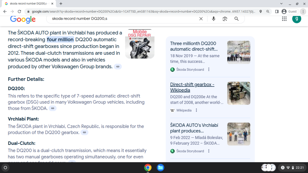

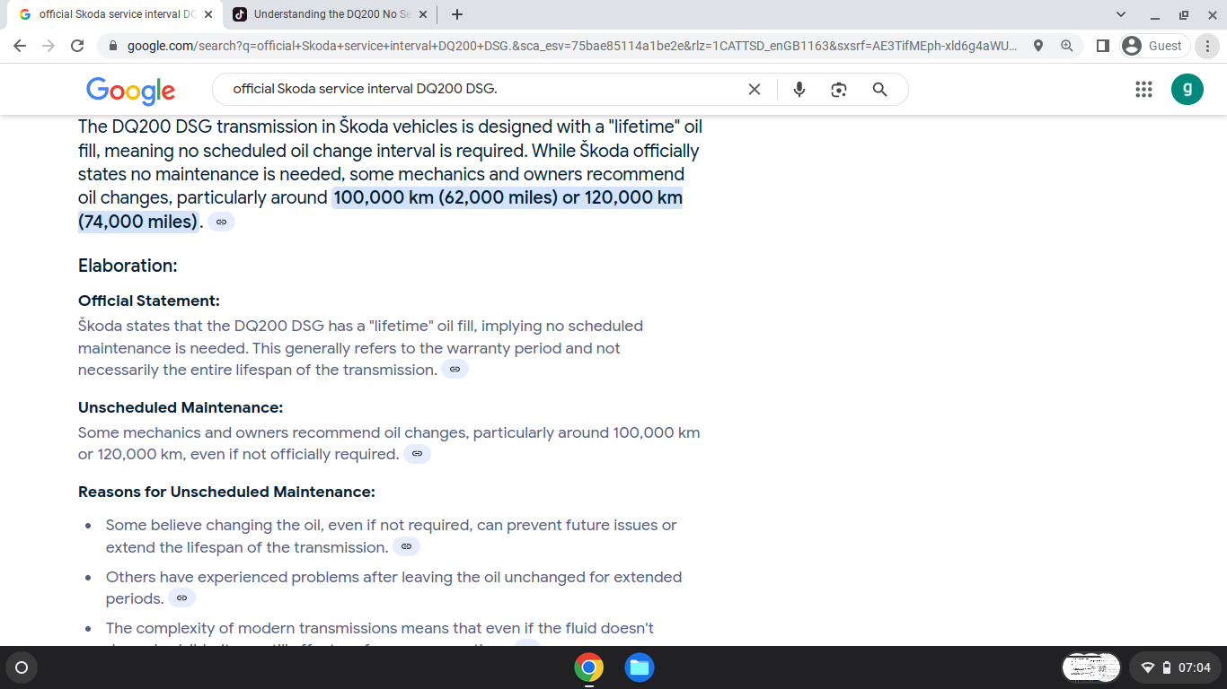

That being said, I think I've found the petroleum/oil company -
@super717 What is your reticence in stating which oil company gave this information? If they informed you, it is in the public domain.
If you genuinely have a letter from Skoda from Jan 24 stating what became the very purpose of you starting this topic, just take a pic of it and post it. Otherwise, I would suggest all you’ve done, however well intentioned (or not) is create a click bait thread.
This includes / refers to 1.5 TSI ACT,s
