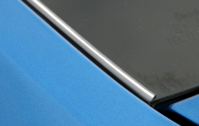

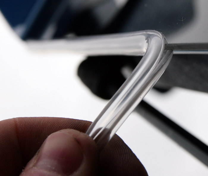

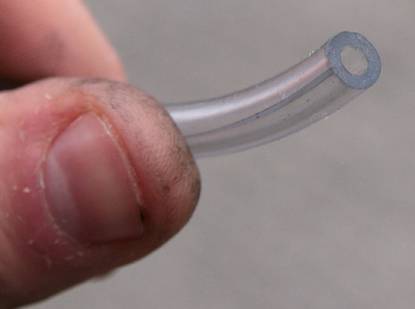

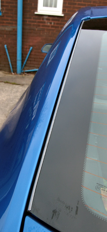

Sounds like the problem I am trying to solve might be different to what you guys have been describing above... When I open my boot lid and it's been raining, water sat on the rear window runs off sideways, over the edge of the glass and into my boot. I don't get any pooling anywhere...
Anyway, here's what I did:
Had to make a jig to ensure the tube (some brake bleeding hose at work) was sliced neatly, but took about 20 mins in total and came out better than I expected!
Adam
