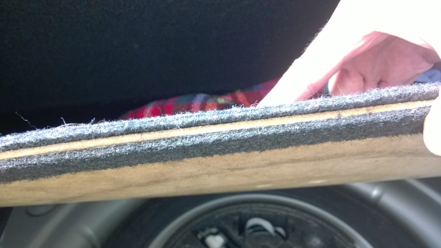

Can anybody tell me if the bottom panel is just flimsy thin material like the standard mat that comes with the car? Or is it a bit stronger? I want to use the bottom panel for the dog and keep the upper folding panel clean and hair free. But the dog collapses the standard mat into the wheel well... So will the bottom mat with the false floor kit be any stronger?
My Scout has the VBF and I do exactly that - dogs on the flat, VBF in when they're in the wife's car. I have two pointers of about 22kgs each - no issues on the flat floor.
The VBF is quite sturdy. Skoda do give a weight limit for it, 75 kg rings a bell but worth checking that; mines stood up fine to logs and bricks!
FYI, the standard Skoda VBF is well made.
I have sat and lounged in the back many a time on the VBF with no issues regarding weight and I am slightly over 75 kg.
I have also taken 3 suitcases each of 22 KG's for hours at a time which has also been fine. It is pretty sturdy!
Just read your question properly!! Mine is a pretty thin material on the bottom which is effectively the floor of the VBF. It would be a bit stronger than just a mat. I've put plenty of items in there and they have never deformed and ended up in the spare wheel well.  I wouldn't want to put too much weight on mine although, certainly not 75 kgs.

The bottom is pretty thin (1st pic) especially when you compare it to the VBF 'lid' (second pic).  Less than half the width perhaps.  Saying that, is is stronger than I remembered when you press down on it.
You could always whack another bit of wood under the whole thing to reinforce worst case scenario.
Thanks for the photos... It looks reasonably strong. Stronger than the one that is fitted with the car anyway. Can't wait to get it. I'm keeping an eye out for any deals on that slimline pioneer sub.
