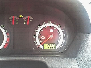

It looks like a little engine on mine IIRC. SWMBO's car has an 'EPC' lamp (Engine Power Control?), but I don't know if this is in addition to the engine symbol...
It's the one to the left of the speedo needle in the above pic...

Arh... maybe I have something like that. I'll make an effort to check when I start it up to go home tonight, but certainly don't recall having a light on when I drove it with the MAF disconnected.
I thought that was "engine management system"; I was wondering if the OP was referring to the glowplug light.
