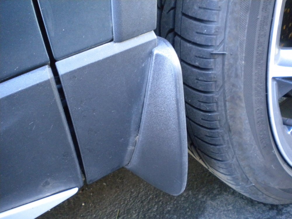

Well on mine the 111A set fits in the right places the centre hole lines up with the existing arch screw hole and the clamps underneath fit as the instructions maybe the 111A set fits on both but the 111 set will only fit with arch trims.
Anybodies guess what is going on!

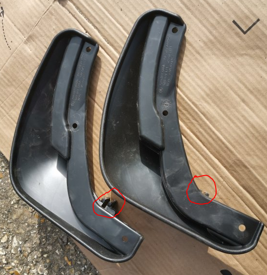

Am I reading you right? You're saying the lugs are the same?
Is it just the angle of the photo you took? The lugs look very different between the A and non-A version to me (circled in red)?
Did we get an answer to this?
If so then this will confirm the differences between the A and non-A versions...
Haven't managed to compare both A and Not A with and without wheel arch trims as still working. I have noticed that the small bracket underneath, as highlighted, is different between left and right on the Not A that are currently sat in my garage.!!! I don't know what's gone on. Mixed batch, production issues, incorrect instructions (as noted in an earlier post). I'm still confident that the A variant is for non trim fitted vehicles.
