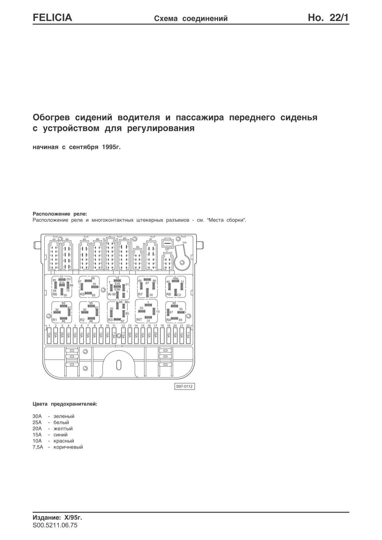

But I have some questions for the installation for the heating seats.
What are those relays for? What do they do?

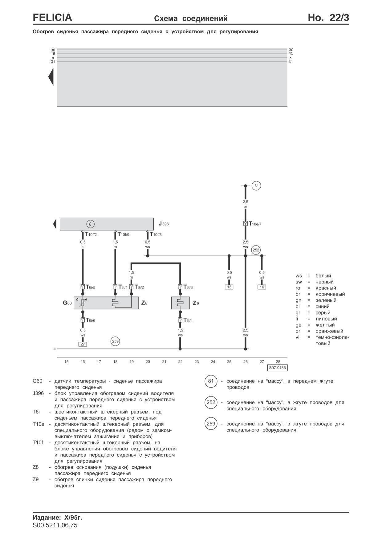

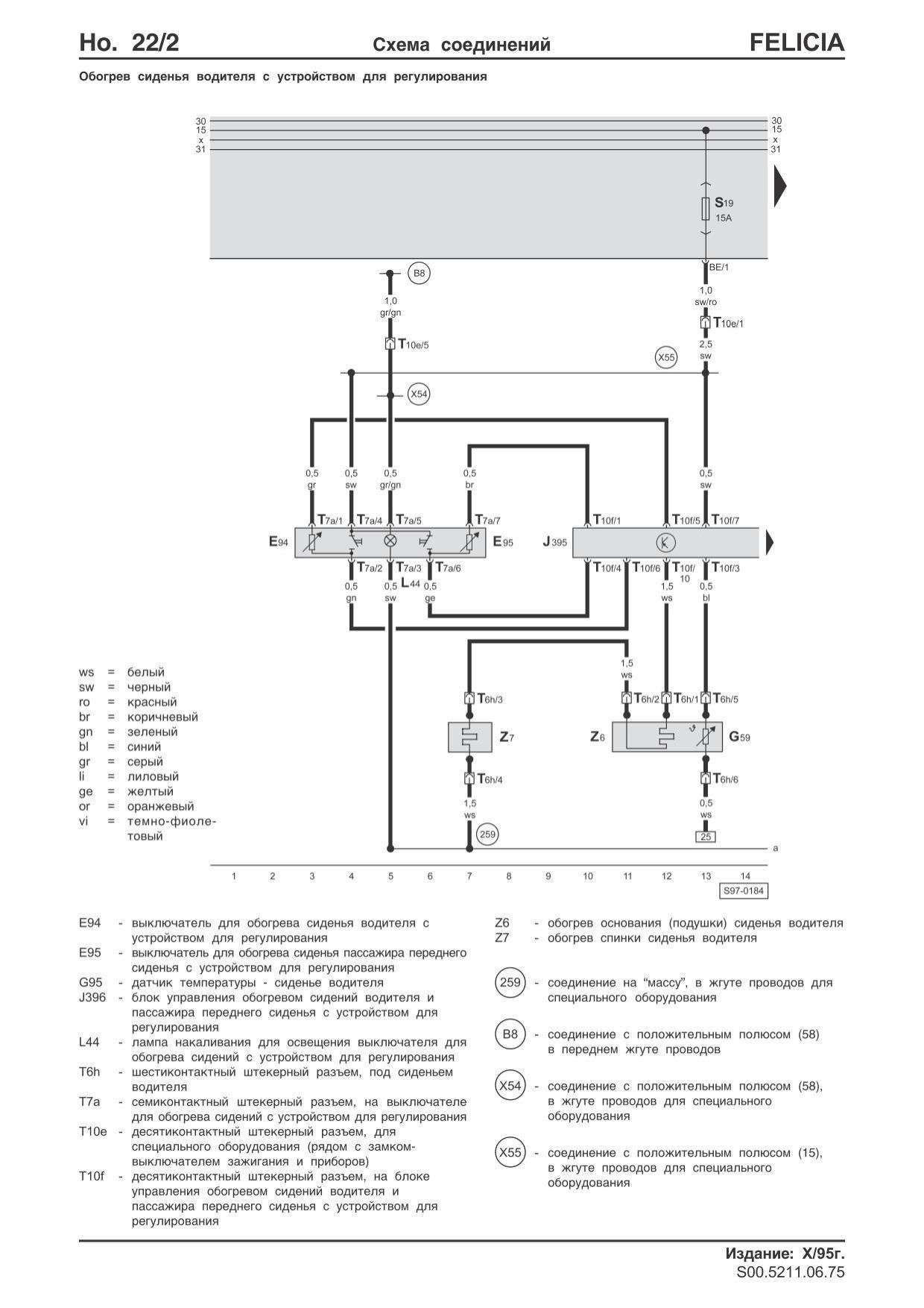

You have identified well the parts. The one for the front seats heating is called Control Unit with Regulator.
Wiring below.

The seats are already installed and everything is working.
I just used mine relay for the central locking and wired everything using the diagrams from the previous post.
