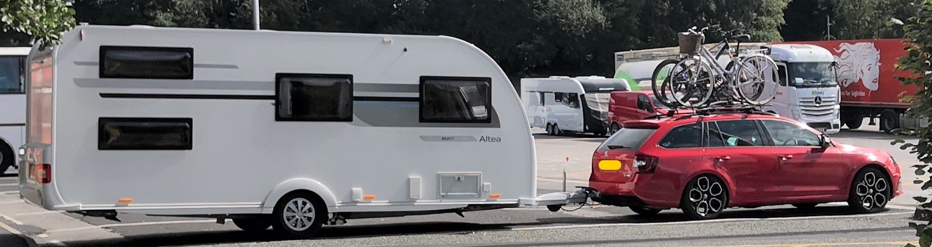

Fantastic tow car. I pull a 1420kg van with ease.
No real towing issues. Its got the typical estate car 75kg nose weight and I've had the jockey wheel strike a couple of times when fully loaded. It's stable and more than capable. Fuel consumption increases as expected and I get an indicated 20mpg at 60mph ish.

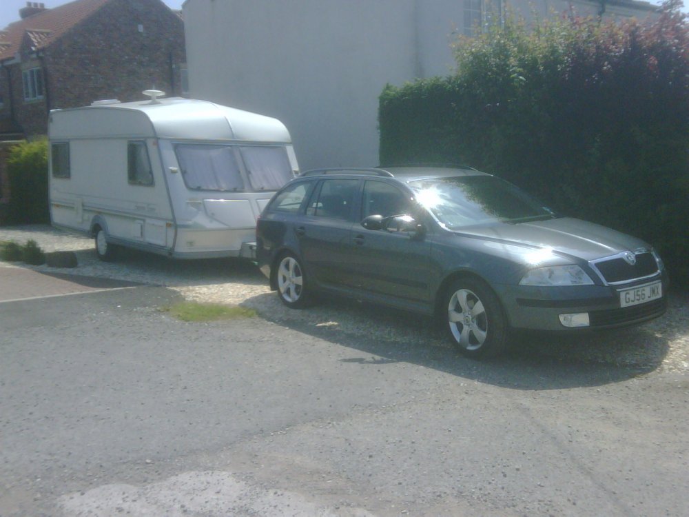

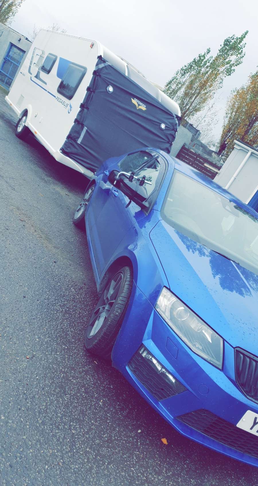

Looks OK once hitched up. It's only a Skoda estate, not an exotic sport car!

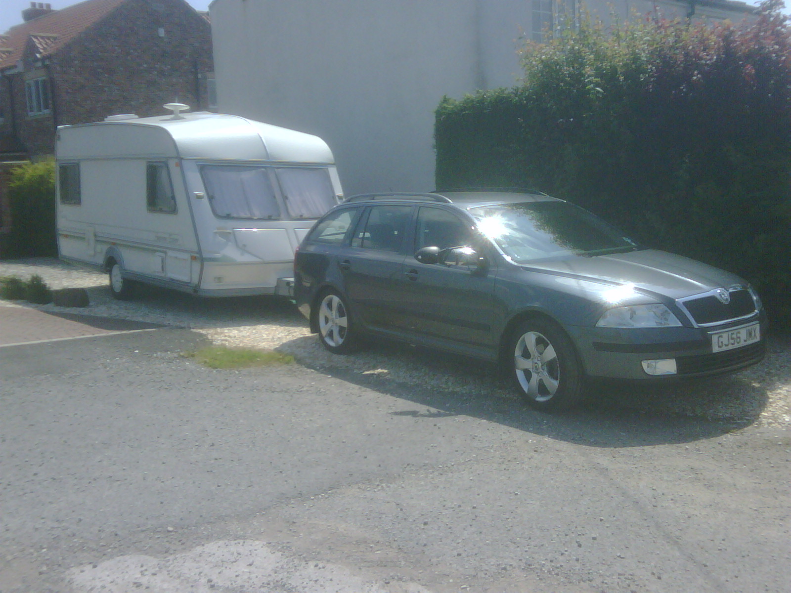

Truth be told i dont really know (being new to caravanning) but the plaque on the side has an MAW of 1100KG
I had a very old freelander that had no issues towing it.
Purchased last year during Covid so that we could have some way of getting away from the teenagers for a weekend :)

Lookin good for a '96'. 👍
Its a little minter, hardly used and been looked after, everything works, no rot or damp. at under £1500 with 2 awnings , water pumps, water and waste carriers it was a bargain
