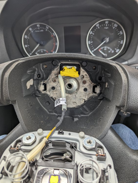

Update, I've looked behind the airbag and there is no harness connector for the buttons.
I tried activating MFSW on vcds to see if it would accept it if I got a new loom and installed it, vcds rejected the adaption as it's not set up in the module.
I'm guessing this will be a full retrofit job.
If anyone has any ideas on a retrofit kit that would be great

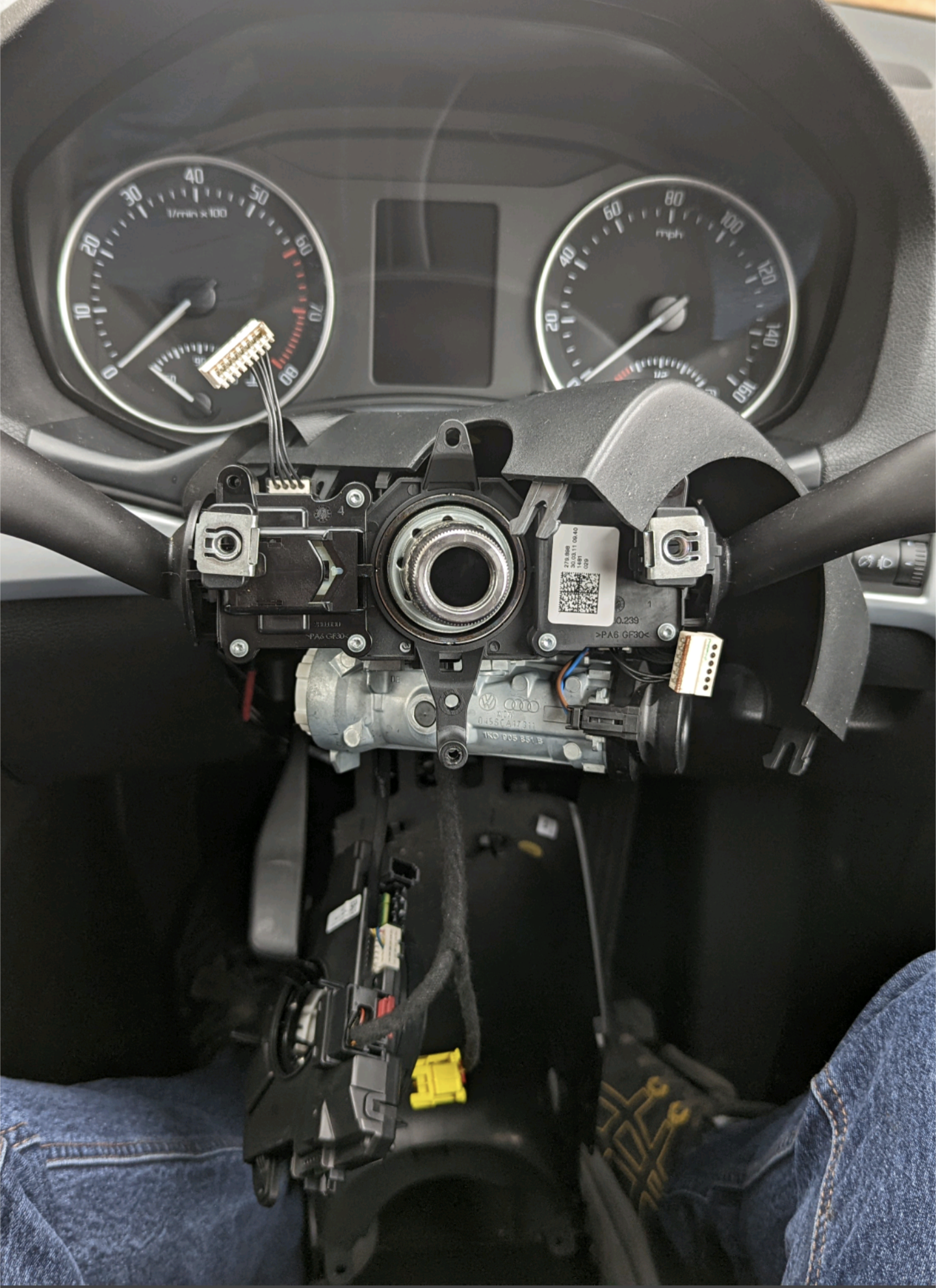

I decided to strip the column down to see exactly what set up it has. Looks like a basic one with no module underneath.
The clock spring is part number 5K0 953 569 C which I've read isn't for multi function.
I'd only be using the multi function for volume and changing the track, so it might be more hassle than it worth with how much it would cost too.
Thanks for replying :)
Sorry to be a pain, just looking looking at the steering modules. On ross-tech it's showing that module 5K0953569B supports cruise control, board computer and mfsw I'm guessing that fitting this unit plus coding along with a new wire loom for the airbag and steering wheel buttons should complete it, or would there be extra wires to connect for the mfsw
