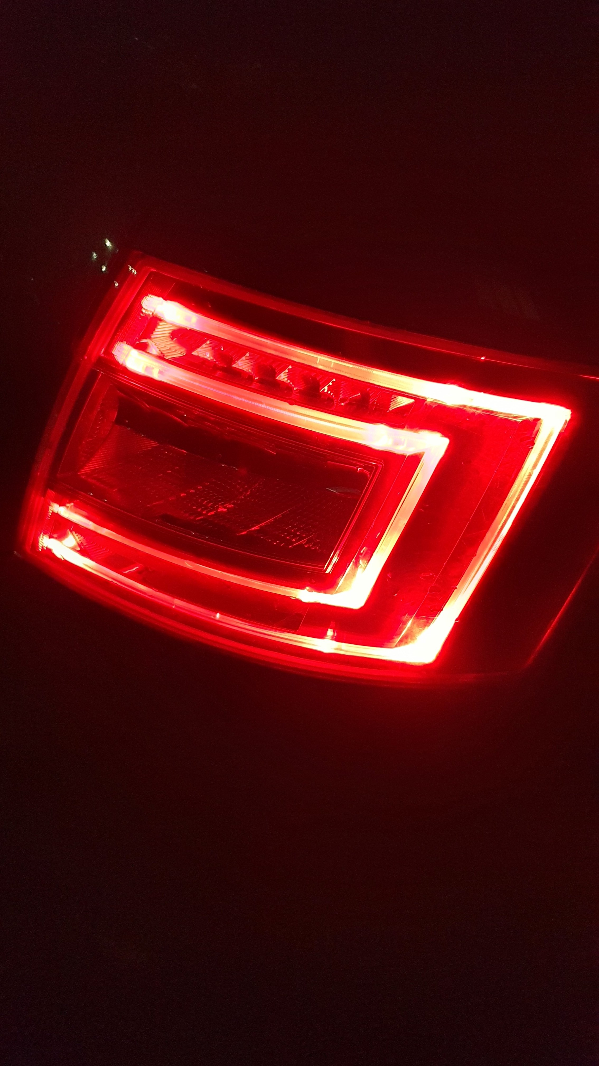

This is pretty stupid question but please don't get mad at me. I've just noticed that on rear lamp i got only one set of single bracket lights on all the time. is it not meant to be double bracket light like the other picture i shared here. I keep on seeing double in some cars. I just forgot how was mine at the beginning.
langers2k, I think it's normal, yes, but I haven't figured out if this double/single bracket light is programmable and has same physical light enlcosure or not.
I have in my 2015 MY those double bracket lights. But I have seen on facelift models even third variant of light.

That's right. I have seen this third variant light as well. My variant is the top of the rank SE L/ Elegance  which has intelligent headlight..not any other model including superb has this option by default. So, I don't think rear double bracket tail light depends on the variant. Probably i had it already and somehow i disabled it with obd11. Mine 1.4TSI DSG ..2017 model..can someone with same car tell us if your tail lights are as same as mine?

There were two types of pre facelift light and two types of facelift light.
Pre Facelift:
- filament bulb, single ‘C’ style light. Low functionality.
- LED, double ‘C’ style light. High functionality.
Facelift:
- LED, single ‘C’ style light. Low functionality.
- LED, single thick ‘C’. High functionality.
Both high functionality light types were standard on vRS and L&K models and an optional extra on other models (although they were possibly standard on SE Tech models too).
There is no differentiation between hatch and estate models.

is it possible to replace my tail lamp with the double C (Bracket) types of tail lamp?
Yes but it’s not a simple plug and play. You’d be fitting a pre facelift light cluster to a facelift car.  Suspect the pin arrangement and even the plug itself will be different. It’s up to you whether you feel it’s worth the effort or not. Even switching to the thick ‘C’ from the facelift likely isn’t plug and play and would at the least need some coding.

If it's of any use as a data point, my Mk3 VRS (PFL 66 plate/MY2017) has the double C style lights.
The top row of LEDs lighting up in between the top part of the "C" when the brakes are applied.
Edited by hhcd80

This is exactly what I was looking for. Mine is 1.4tsi SE L hatchback 67plate. I have single bracket (C) light. I know about brake light as you can change the bulb. But this cluster C shape, you can cot change the bulb.  some car has single and some car has double. I am just wondering if I can have double in my car. I don't know if there is any VCDs adaptation for it.
14 hours ago, langers2k said:
It's a different rear cluster.
You can fit pre-fl clusters but you'll need a wiring adapter and coding changes.
Most people do the opposite and fit fl clusters to pre-fl cars 😉
I am confused. cause i saw the newer number plate than me that car has double bracket (C) light. Probably it was different variant or as someone else said VRs. Next time I will keep my eyes open and update here.
