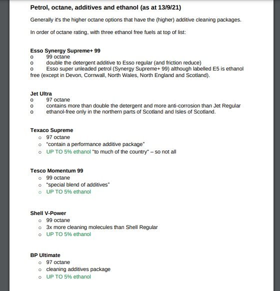

Maybe try a tank of E5 Super Unleaded as well.  97 or 99 ron.

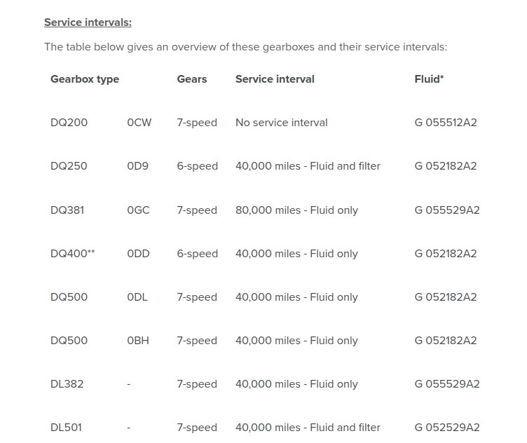

Hi, I don’t know about the service history specifically. It’s got full service history but I don’t know what was done. Skoda claimed they also serviced it for me but they didn’t supply me any service documentation. I asked them about DSG servicing but they claimed it’s not like the earlier models that needed doing every 40,000. My car has done 50,000 miles so far. I haven’t tried moving it into S but will give it a go. I the car has been sat at Skoda since around February. I drove it home which was around 70miles.
Whoever told you about the DSG knew nothing about them then.
The DQ200's were early DSG's and do not need oil changes.    So you are OK there.
(So it is wet clutch DSG's that get Oil or Oil & filter changes, early ones @ 40,000 miles, some now are first at 80,000 miles)

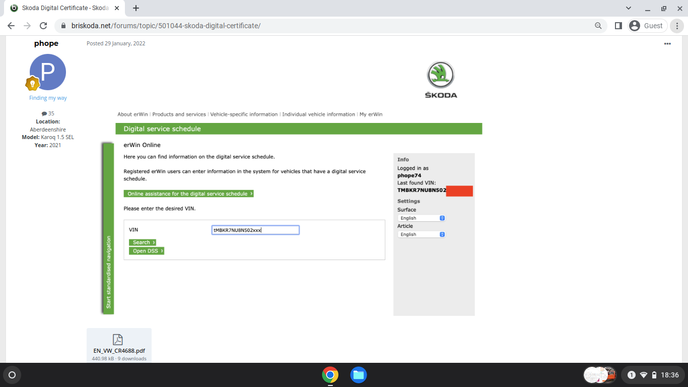

My understanding is that this was a former fleet car which generally have to be well maintained with manufacturers recommended servicing. I’ll chase Skoda and see if they have any other info. Why this stuff isn’t all digital like mots nowadays is beyond me. Out of curiosity how do you know my DSG gearbox is a DQ200?

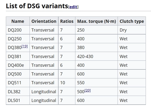

Your dsg is a DQ200 because it is FWD, no more than 192 ps or 250 Nm.
Fleets might well be serviced to recommended manufacturers servicing.
So if the spark plugs have not been changed or the brake fluid has not then you car has not been.
The record of servicing is digital and on the VW Group system,
So the dealer or any dealer or Skoda Customer Services can provide you with it, or someone on here will tell you how to find it online.

If the OP was trying a 1.5 TSI ACT with 150 PS which has the same DQ200 DSG it does move off different from the 1.0 TSI 110ps DSG.
Or from a 1.6 TDI and different from 2,0 TSI /TDI's.
That is why VW were intending by now dropping using DQ200's that were not fitted to Mild Hybrids or PHEV's but have not yet done that due to circumstances.
They will probably have to for the Euro 7 emission cars.

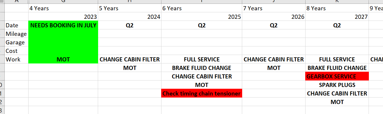

I have (perhaps unsurprisingly) got a spreadsheet for my car's servicing. (Servicing already done not visible, just upcoming work.)

I left the Skoda network as soon as my warranty expired because my nearest Skoda dealer has terrible access and my preferred alternative is miles away.
I use a specialist VAG servicing garage and they are able to access the Skoda online service database and update my service history.
They're not cheap, but they seem to do a reasonable job.
Edit: Just nipped out and checked the independent VAG specialist I used to service my car on Friday had reset my service interval indicator correctly, and they had.
That is better than the Skoda dealer managed first time when I took my car to be serviced there while it was under warranty. They sorted it out there and then when it was pointed out, but it's a rookie mistake that a main dealer shouldn't be making.

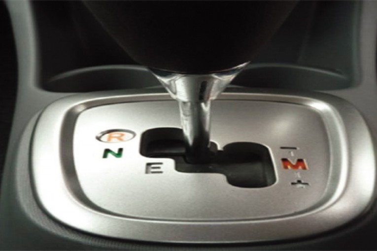

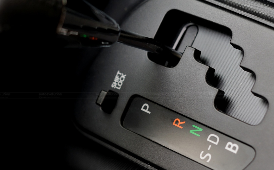

I wish there were paddles on the steering wheel for M mode (even my Aygo MMT had paddles!) then I would use M mode more, the pfaff of having to reach down to the gear stick means I just use S mode or kickdown.
I just use the shifter even when there are paddles.
I like to slap it to the left and up or down gears, usually down to slow down ten back to D for upshift, maybe back to S for just some reduction of speed when off the accelerator.
My left hand is doing little else really and i feel that it comes naturally like using a gearstick and no need to look at a gear indicator to see if the paddle did 2 down shifts if i ask it to or holding a paddle to go back to D.
Makes me feel like a driving god, not just like on a Playstation..
I'd be more likely to use the gear stick in M mode if it were more 'logical', IMHO VAG have got the "+" and "-" on the gear stick the wrong way round (unlike Toyota, I always drove my Aygo MMT in manual mode) with "+" being towards the front of the car and "-" towards the rear of the car.
Here's my thinking - when you're braking, and most likely to need to downshift, the deceleration force acts to shift your weight forward so it would be best if "-" was towards the front of the car as the deceleration force would help you downshift. Conversely, when accelerating, and most likely to need to upshift, the acceleration force acts to shift your weight backwards so it would be best if the "+" was towards the rear of the car.
A small point which many might not agree with or even see the problem, but one which matters to me.
I have driven only 2 pedal cars since i lost my right leg when 17 and like pulling the gear shifter back to a lower gear.
As i do with nearly every Auto, CVT or Senso Drive i ever own or drive to lower gears. Including the Toyota iQ CVT / MMT where B was back.
Electric cars as well for B / regen braking.
When i shift a shifter back it is to a lower gear to decelerate off the brakes, or dropping a gear or 2 before booting it without using kickdown.

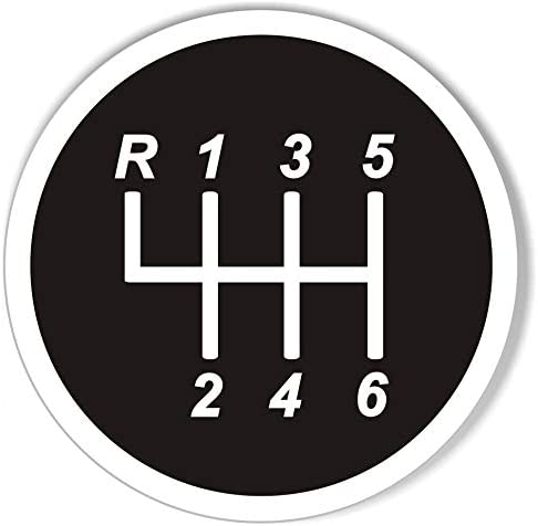

16 minutes ago, toot said:
On a manual if you drop a gear you move the gear stick back do you not?
Only for 50% of the gears - on a 6 speed extended-H layout when changing down from 6th, 4th or 2nd you move the stick forwards.
Aygo MMT shifter
