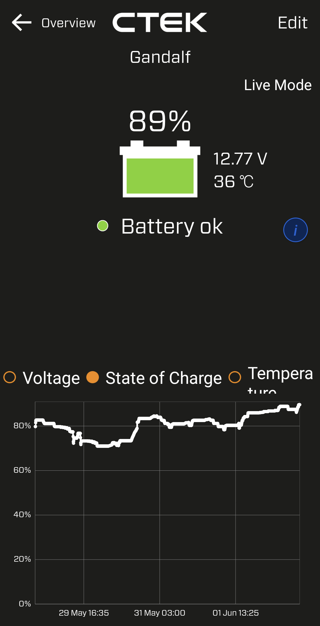

I got myself a CTEK Battery Sense monitor.
Connects directly to ur car battery and u can monitor (via Bluetooth) it live using an app on ur phone.
More for peace of mind as my battery is 3 yrs old now.
