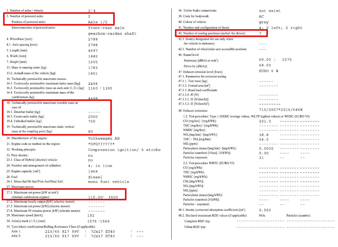

You could try asking Skoda UK for a "specimen" Certificate of Conformity.  They MIGHT e-mail you one.  The actual "proper" Certificate of Conformity is a very unassuming bit of A4, printed on both sides, but is actually the definitive legal document that nobody can argue with.  It is unique to your particular vehicle and will quote what it can and can't tow, braked and unbraked.  The manufacturer is obliged to issue ONE original, free of charge, to the first owner, but if the first owner has lost it, they can charge for a duplicate.  The "specimen", however, is just a scan of it, and has no legal standing, but does actually give you the data you need.

Just checked with the dealer and they confirmed it is rated to tow 2000kg so no issues with homologation.

You won't find a law that says you "can't" fit one, because laws are not written that way.  They usually tell you what you MUST do, and then if you're not doing those things, you're breaking the law.  You will, however, find the Construction and Use regulation on braking, which will say something along the lines of the vehicle "having to comply with the relevant provisions of ECE Regulation 13 or 13H or..."  (it will give various alternatives, depending on when the vehicle was type approved).
If the vehicle was never homologated for towing in the first place, then as soon as you attach a trailer to it, you will be in breach of the relevant C&U regulation (because you will not be able to provide evidence that the vehicle satisfied the requirements of those regulations with a trailer attached).  In a serious enough accident to get the Plod involved and go to court, that's what the prosecuting expert witness would pull out of the hat.
Of course, none of this means that the vehicle wouldn't meet the requirements (it probably would, with most trailers), but what you wouldn't have, is firm evidence of compliance to show a court.
Thanks for that.
I was taking issue with the assertion that anyone "fitting" said towbar would be breaking the law.
The secondary issue is the use of it to tow and I agree completely with your analysis, the only risk of a prosecution would be in the case of a serious accident but I think unlikely, I would be more concerned about my liability were my insurers not to pay out to the 3rd party.
