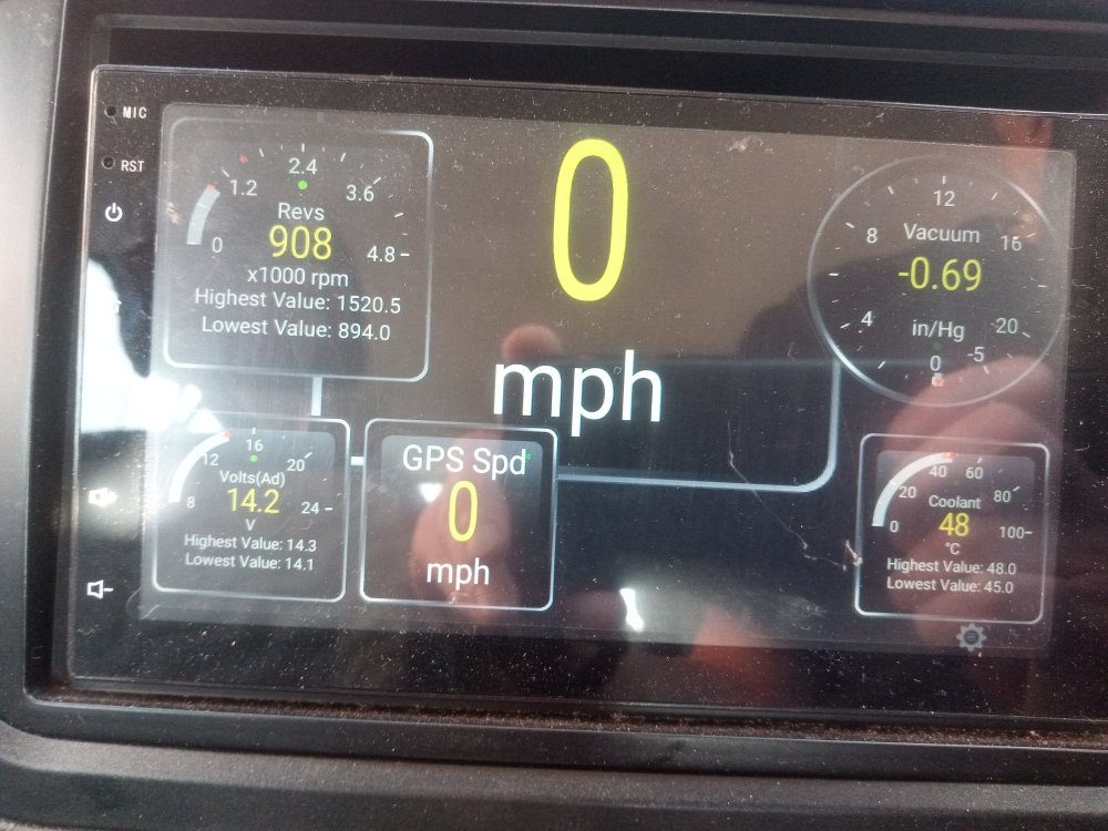

Bit late if going in tomorrow but are you sure it has been doing a regen of the DPF. On my Greenline the exhaust note takes a deeper note when doing a regen but does not indicate anything on the instruments. Had an issue a few years ago of not re-gening during the colder months due to a thermostat stuck open so never getting to required temp to initiate a regen. Lack of temp gauge (only blue light that extinguishes at around 45 deg.C), only identified by running Torque app on phone via a bluetooth OBD adaptor. DPF clean can be done yia an aerosol spray down the larger of the 2 pipes on the differential pressure switch accessible top rear of engine on drivers side. Theory - increased back pressure from blocked DPF would stop flowing as much exhaust gas reducing boost. Where the below says Vacuum this changes to boost pressure in psi generally showing around 18psi at full boost.
