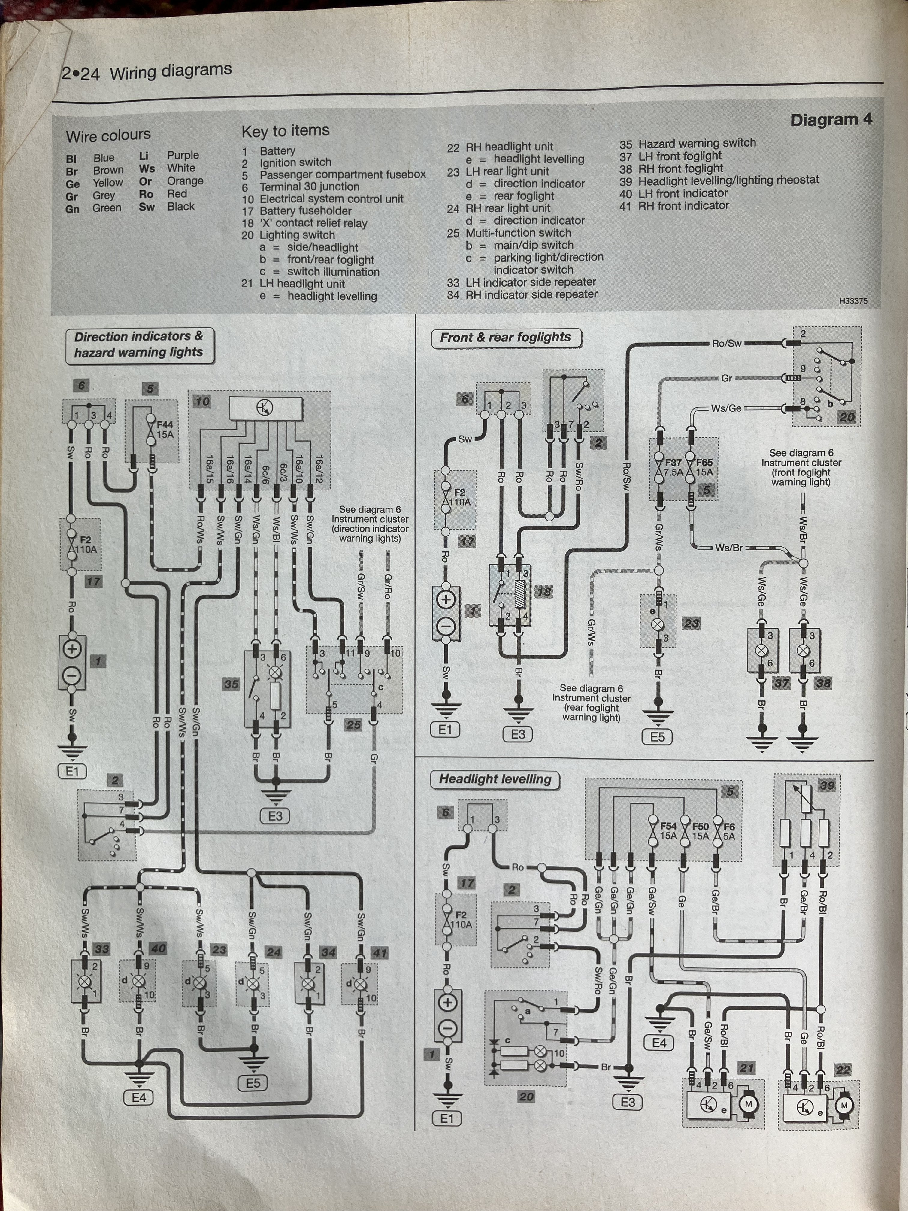

Thanks both.  Yes, looking at the wiring diagram in the Haynes manual, attached, suggests whatever the input, it’s the same BCM output (16 as labelled). And odd that I got it to consistently come on with the main beam flash action, though as I say that tactic isn’t 100% reliable.

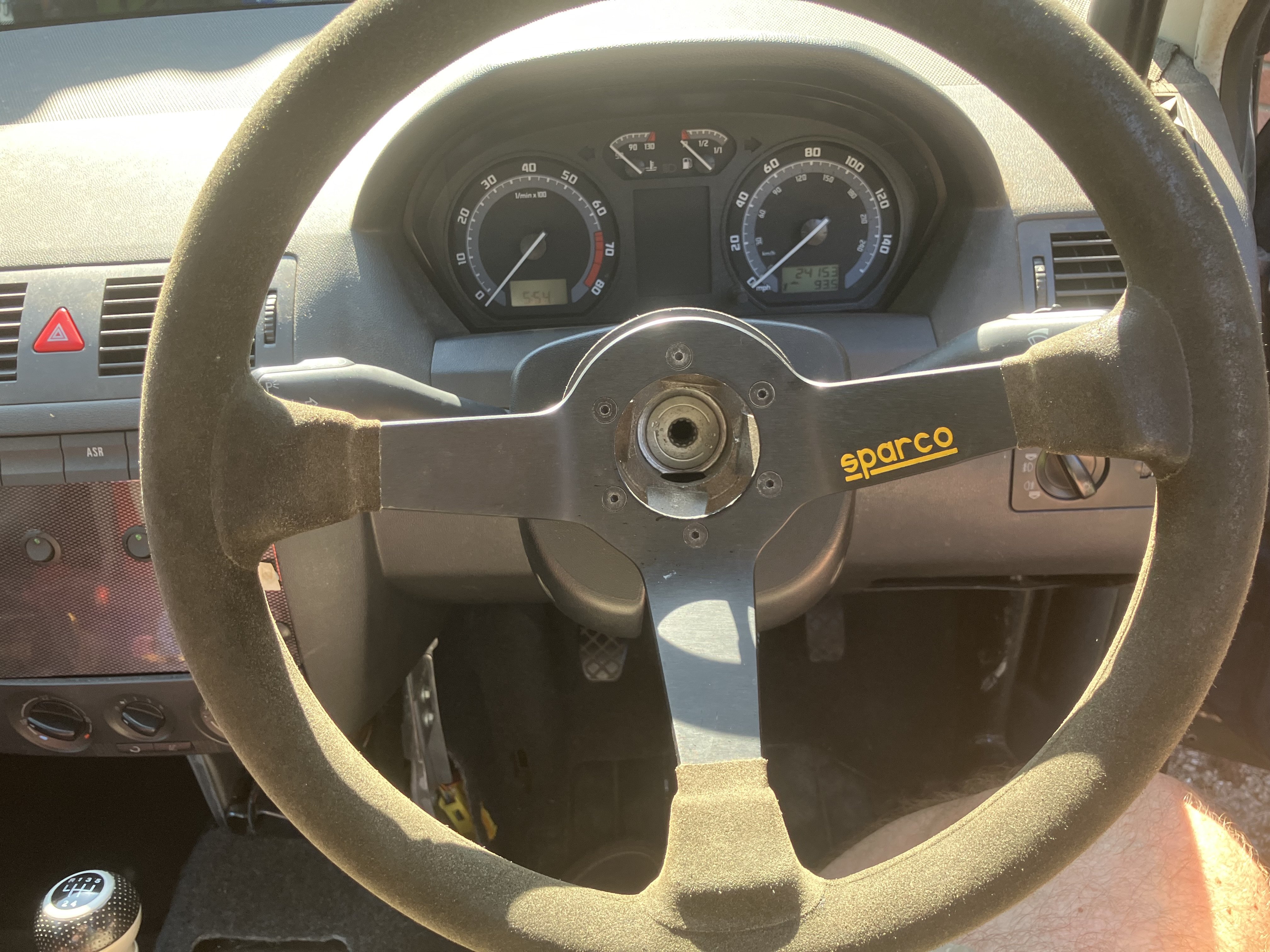

Just remember to mark your locking nut position on the steering wheel and be careful with the air bag lol.

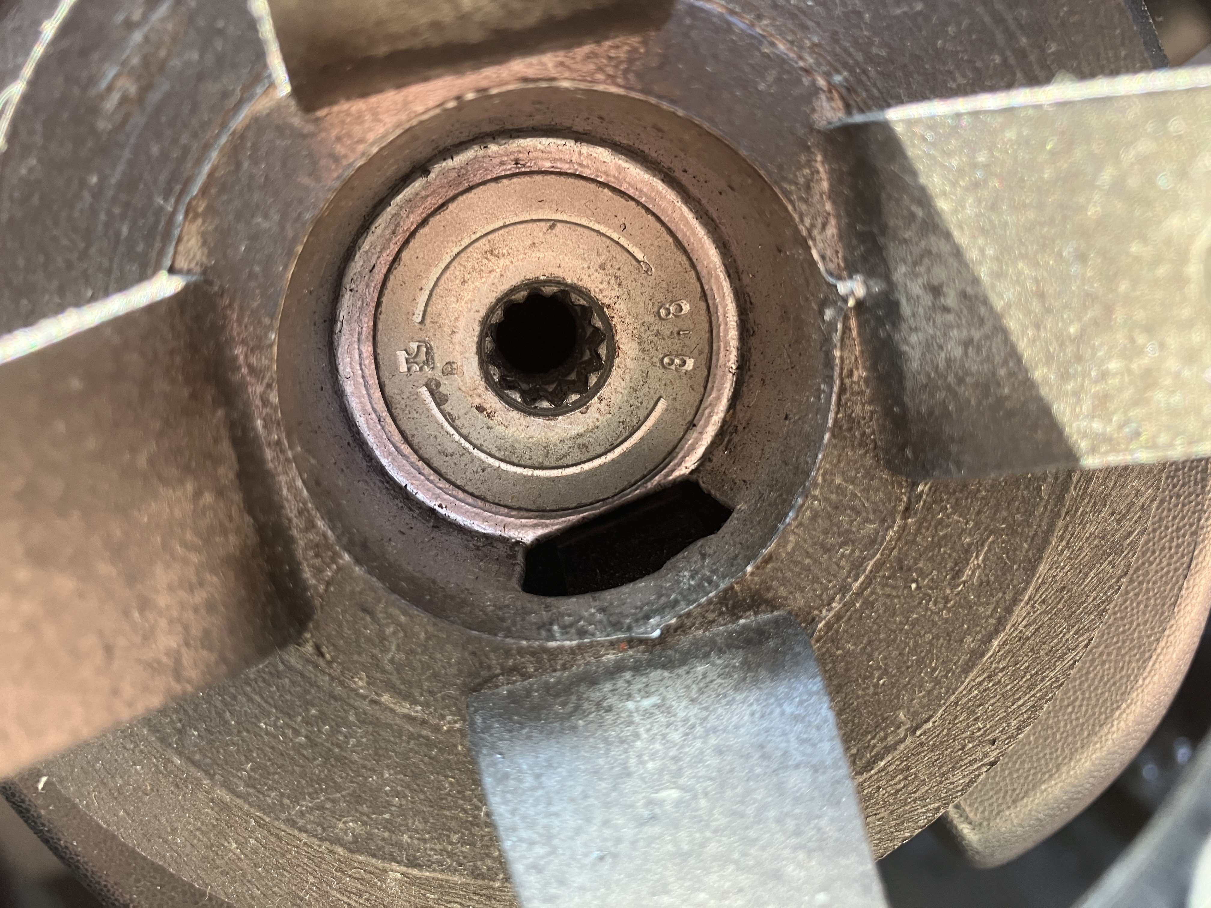

No airbag issues to worry about. But, this bolt should just undo, correct? With a 12mm spline socket on it.
Thought so. Neither my breaker bar nor my impact driver are shifting it, and I was reluctant to try the latter 😞
Ok, is it a proper rattle gun or a Fisher Price looky-likey?
Also, are you trying to hold the wheel or letting the steering lock do its job?
Use a tube to extend the breaker bar and use maximum effort.
De Walt jobbie. But, cracked it - neighbour on the breaker bar, me holding the wheel 👍

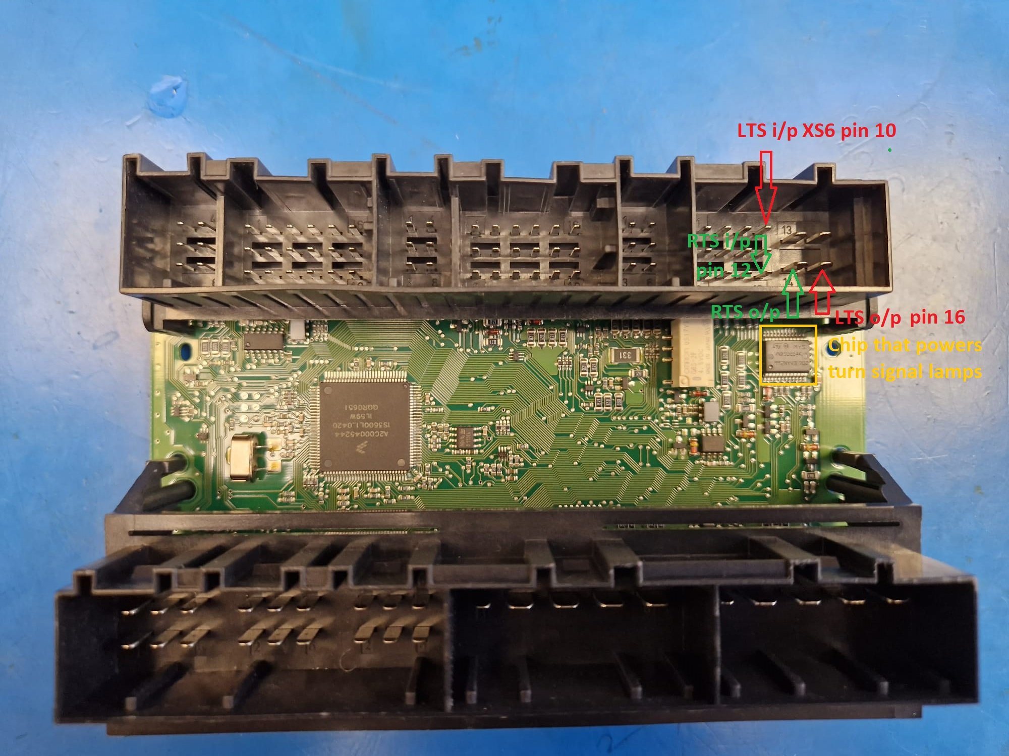

Made this little image just the other day for someone in the mk2 section. Your circuit board probably looks slightly different, but pretty sure the pins for inputs and outputs are the same.
If I were you I would focus on what the voltage is doing at pin 10 (LTS input) when indicating left, using stalk. Should be high (12V, I expect) when stalk is in neutral position.  Should go to 0V when indicating left.  LTS = left turn signal, RTS = right turn signal.
Hazards input will be on another pin, and seems to be confusing the issue a bit, by trying to operate simultaneously with stalk-controlled inputs.

Thank you @Breezy_Pete.  Just looking at your other post here (https://www.briskoda.net/forums/topic/440110-right-indicator-not-working-with-engine-running/?do=findComment&comment=4949991) on how to get at that, and the post above yours on how to conduct a voltage test with a multimeter.  I'll try and get a chance at the weekend to see if I can get to it to do some tests.
