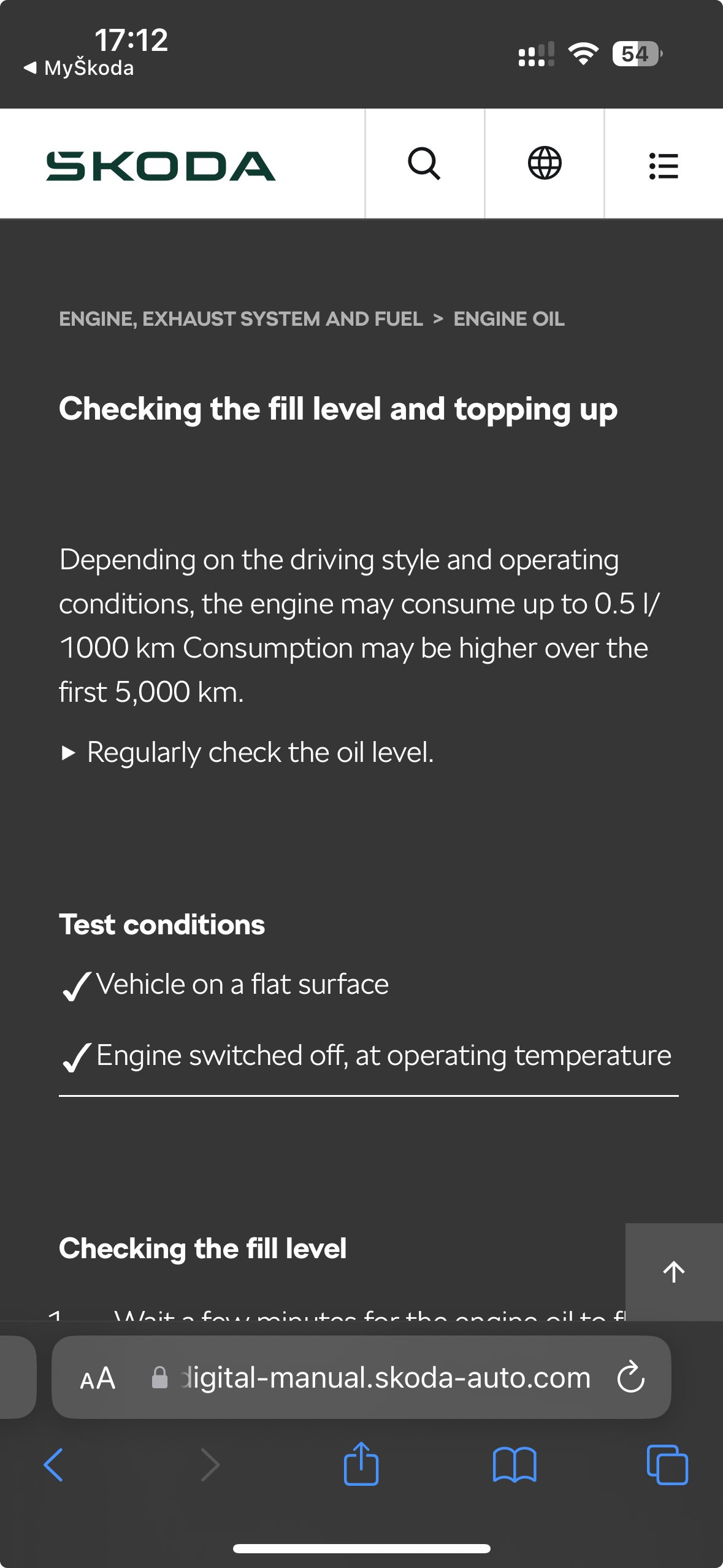

My manual says "up to 0,5 l/1000 km" which is 2,5l per 5k and 5L per 10k.. I know it's crazy hopefully you don't reach that level.

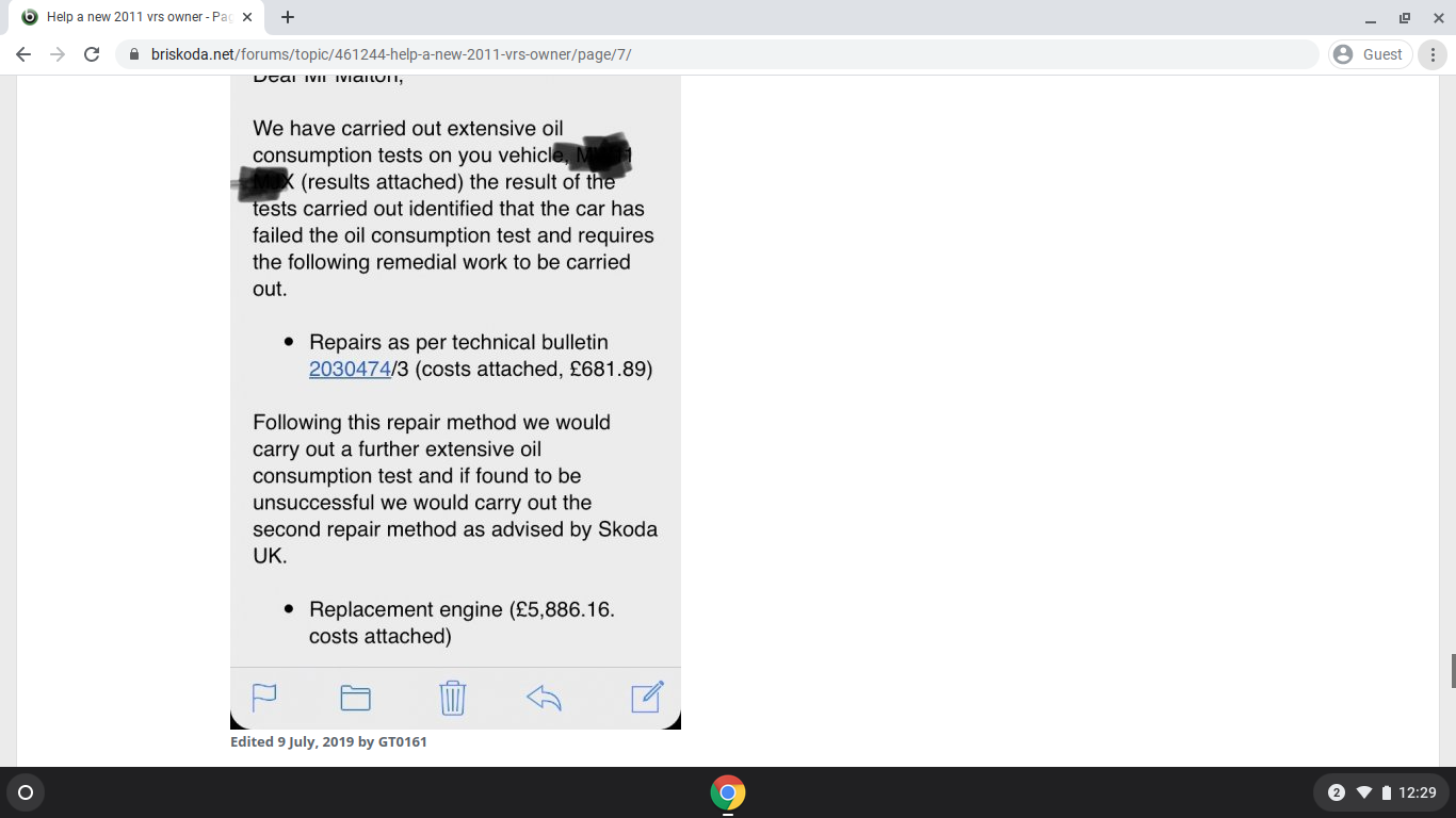

They messed about thousands of Mk2 vRS 1.4 TSI Twincharger owners with VW,s, Skodas, SEATS & Audi,s with cars in warranty, and they sometimes got away with it, but not always.
As to out of warranty, they were caught out by people with After Market Warranties because the Warranty Companies knew there were a Fundamental Design, Manufacturing or material faults, and VW Group did deals with Warranty companies. ie made sure they never took the financial hit.

The oil must be being consumed by the engine but they could not immediately do more because the official consumption figures from VW are 0.5L/1000km...
5L per 10k 😬
