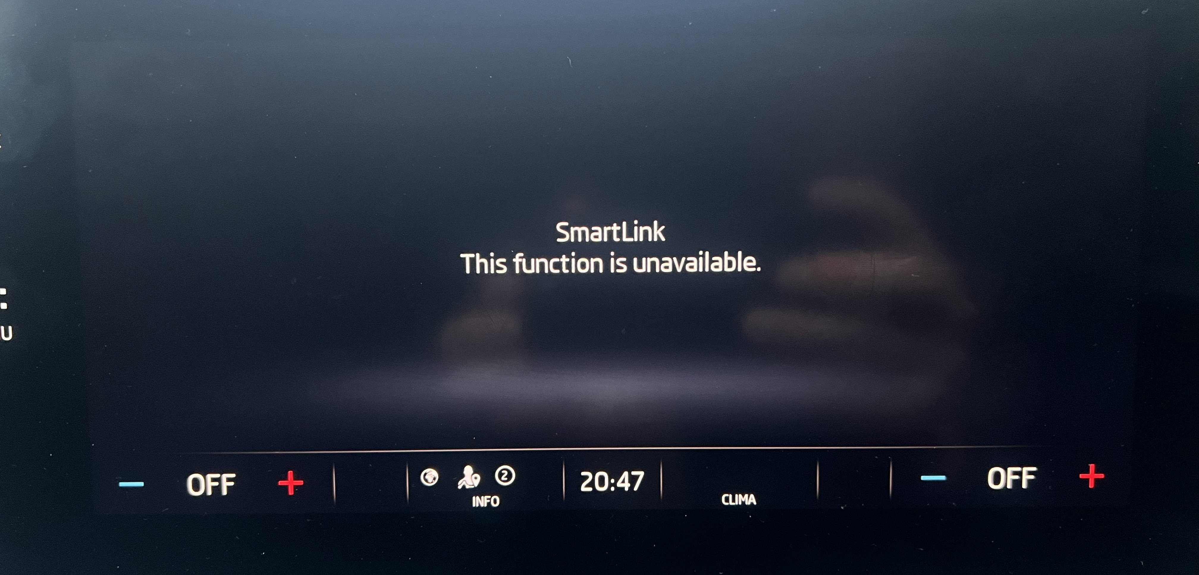

1. Carplay doesn't seem to work. The car connects fine via bluetooth and can do calls / play music via the Skoda system but no Carplay icon appears when the phone is plugged in via USB, despite registering as far as I can tell. When trying the SmartLink app it says 'this function is unavailable'

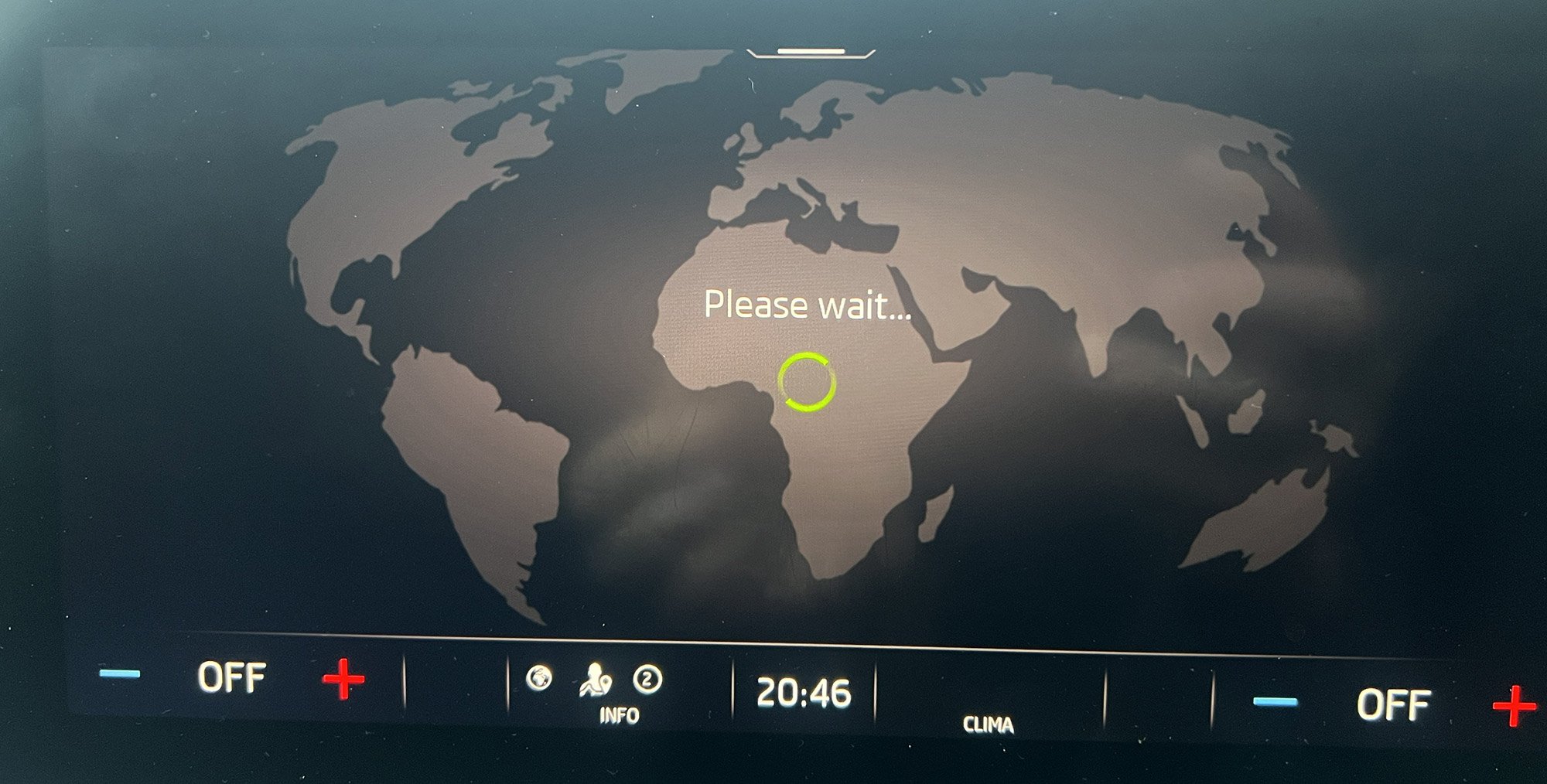

2. Possibly connected to the above - navigation doesn't work. Just constantly says 'Please Wait' when opening the app.

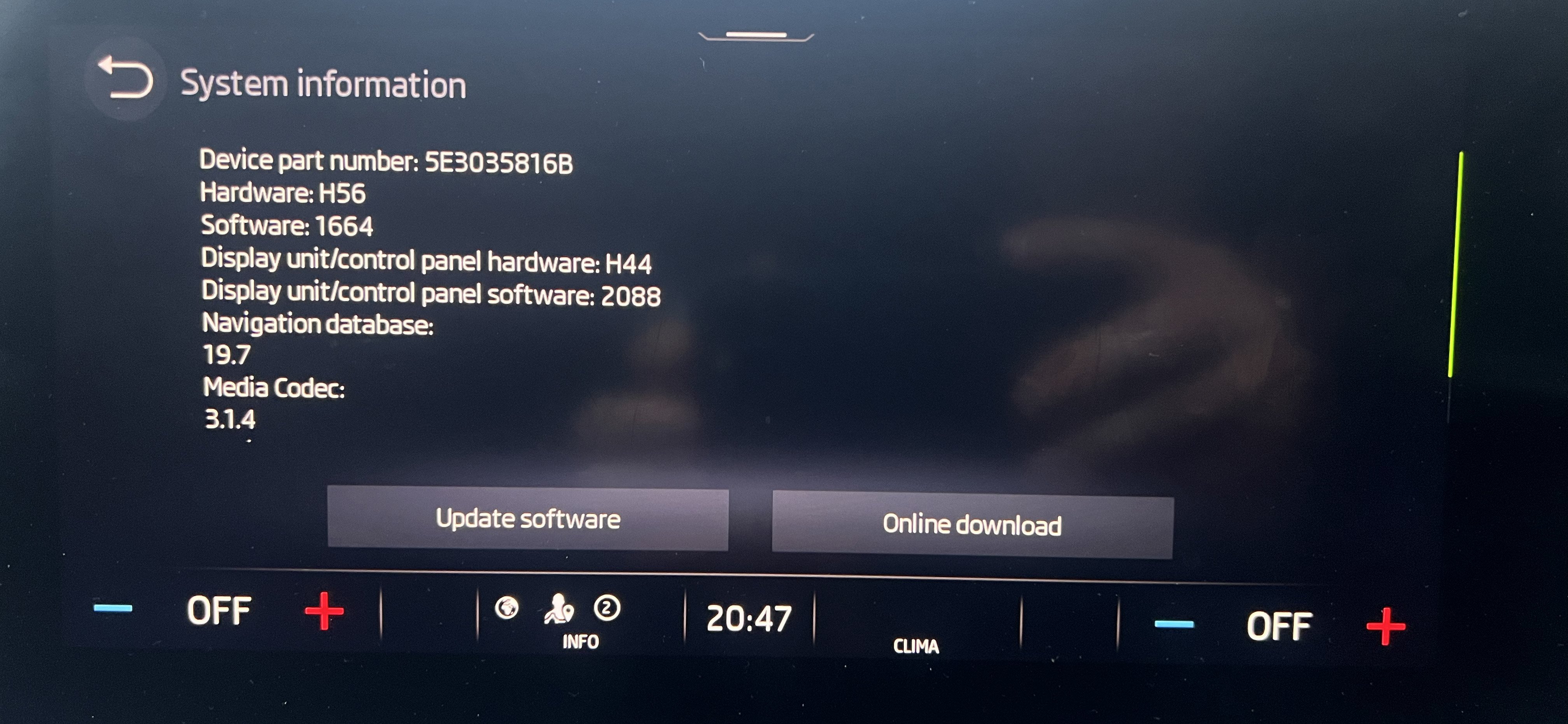

The car was supplied with only 1 key (thanks Big Motoring World) so I couldn't set myself as a primary user and I had thought once this was sorted I could install smartlink from the shop. I've finally got the second key today but this doesn't seem to be the case - Skoda setup the key and also did some free software updates earlier. I stupidly thought this would update the infotainment system which is on a pretty ancient version (1664) but they must have updated something else (Paket 7 on the work order?)

Been there and done that! you'll need to take it into Skoda to get the software updated to version 1941 or 1969 (depends on what they're doing now) which won't necessarily fix your issues, but is first step.
While they have it, get them to correctly activate Nav and Smart link which should work regardless of keys or SW versions, you may also want to check functionality of the adaptive cruise control (mine only had speed limiter until sorted) and mode button(ran pure EV until battery was dead then pure ICE, no option to use hybrid modes and consequently no ability to play with sport mode.

Since you are on a very old software version your first step must be to update to 1941 or 1969.  This will require at least 1 intermediate upgrade so will take several hours.  Once this has been done you can identify any remaining failures and work on them.
In addition your maps are July 2019 and should be updated.  This can be done by a dealer, or by you if you subscribe to the service or manually download and install the latest map version.
