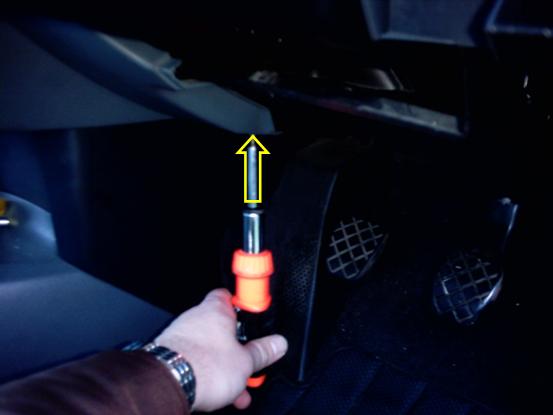

This job needs the entire lower section of the dash out, so start by following the Technical Guides for clearing the vent fan internals (link) and steps 1-7 of the one for evaporator temp sensor replacement (link). The latter tells you most of the tools you'll need, although you will also need a ratchet driver or a very short handle for your Torx heads, as some of the screws are in tight spaces. The part number of the heater / air con panel is 6Q0 819 445, and I got mine for about GBP60 delivered from a scrappy. I apologise for the rubbish cameraphone pics, however as some on here will know, my decent camera's in the shop... :doh: There is a printer-friendly pdf version attached at the end of this post if you need it. :thumbup:

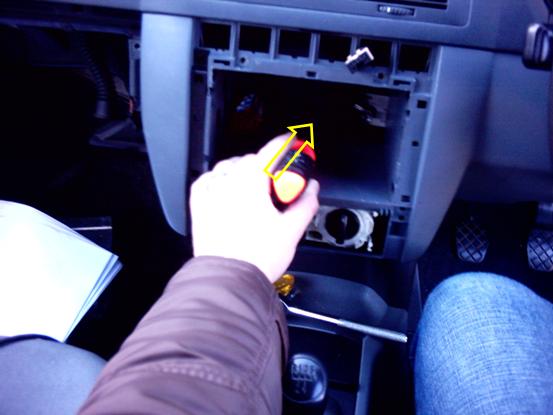

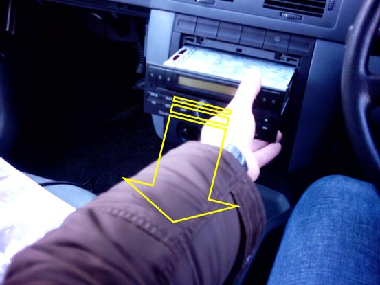

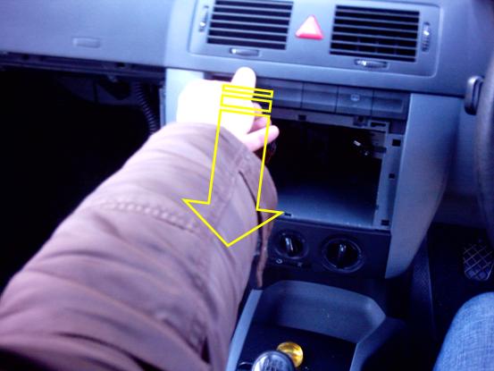

1. With just the centre section of the lower dash remaining, remove the stereo and tray / cupholders underneath. I won't tell you exactly how to do this as it's a minor security risk, but it's easy enough:

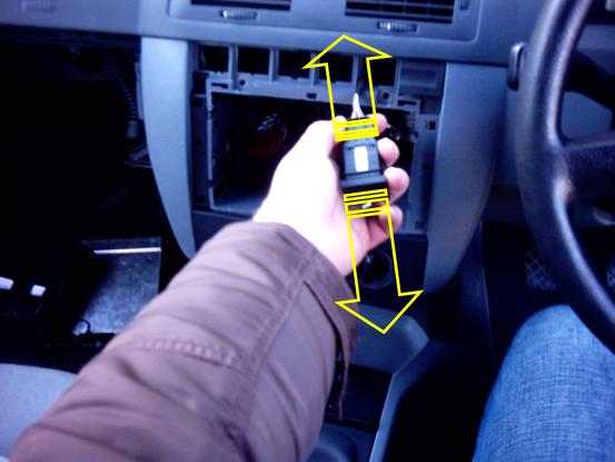

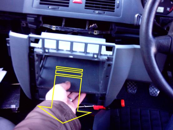

2. Next, pull / push out the trim either side of the stereo, and the blanking plates above it:

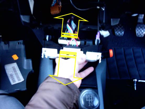

3. Take care to disconnect any switches:

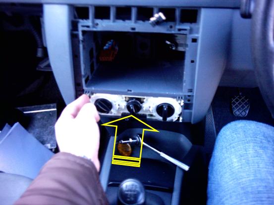

4. Undo the two retaining screws for the heater / air con panel:
5. ...and carefully pull the cover of the panel off, pushing the panel itself into the dash:

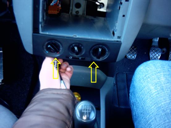

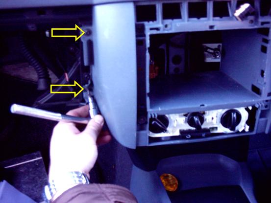

6. Unscrew the two screws shown:

11. Put the bit of dash somewhere where it won't get in the way or get damaged, and swap out the heater / air con panel:

On the first photograph I had a couple of screws to undo just underneath the blanking switches - on your photograph you don't appear to have any screws in those holes.
Lastly I undid all 4 screws on the underside at step 4 although I'm not sure if I needed to.
