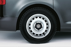

Aha, I thought I'd seen caps like that but couldn't track them down, so thanks for that info.
Hmm, I've just checked eBay and the only ones available are silver and they're asking £23 for the set. Heavens, I might even have to pay full price for them. :o
I think I might try taking a knife to the T5 ones first. Actually, come to think, I wonder whether they'd fit if I did put the wheel bolt head caps back on? Sounds like a bit of a bodge, though.

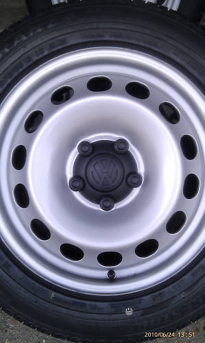

Could someone post a photo of the back side of one the T5 centre caps which does actually fit, so I can compare them to the ones I have? Alternatively, the part number of the correct T5 centre cap would be handy.
My wheels would seem not to be Skoda ones as the centre caps I bought off eBay (which were described as T5 centre caps) simply do not attach to the wheel.
The idea behind my thought of leaving the plastic caps on the wheel nut heads was that the centre caps would clip on to the plastic wheel nut head caps, as they are larger than the heads of the actual wheel nuts. However, a quick check of a wheel nut head cap against the supposed T5 centre cap shows that this would not work since the clips on the centre cap are significantly larger than the wheel nut head caps - and thus larger than the wheel nut heads themselves.
I begin to suspect that the centre caps I have wouldn't clip on to the wheel nuts even if the wheels were proper Skoda ones. It looks to me like I've got the wrong centre caps. One of the risks of buying off eBay, I suppose. Still, they were less than £10.
When I fitted my T5 caps with the platic caps still over the nuts they T5 caps did not engage fully and there was a gap all around. You could prise them off very easily and I suspect any bump would send them flying. Took the plastic little caps off and voila the T5 sits flush with the steel wheel and you need to use the bendy tool from the boot to take the caps off (via one of the little holes in the cap).
You can see the back of the trims in this post:
Superb, many thanks! I'll compare that pic with the caps I have when I get home tonight.

On a related note, is there likely to be any problem with running without centre caps?
The Caddy caps seem to be significantly more difficult to locate than the T5 ones. Mind you, if it turns out that I actually have the wrong "T5" caps then maybe those ones aren't as easy to get hold of as I thought...
The Caddy caps are very, VERY scarce. See lots of T5 drivers upgrade to alloys. Caddies are mostly just vans and not used privately much and thus don't often get alloys retro fitted. It took me months to get them.
Running without caps? I don't think there will be a problem but your hubs will be exposed to the salt and grime and your car will have that I’ve-just-had-four-punctures-and-am-running-on-four-spare-wheels look about it!
Right, I've just compared the wheel caps I have with those in the pics and they're definitely not the same. Mine have a VW logo in the centre which you can see on the back of the cap as well, whereas Niall's are plain. Mine have ten holes around the outer ring whereas Niall's only have nine. Perhaps more importantly, Niall's look a lot flatter than mine, which have a pronounced bevel to the outer ring. That probably explains why the clips on my caps don't manage to engage with the wheel nut heads.
Looks like I shall have to start trawling eBay for some like Niall's, then.
FWIW the part number on the ones I have is 7H0 601 151 B.
Bother! I could have sworn the ones I bought looked identical to some others I'd seen on here. In fact, Mike's are very similar to mine (with a VW logo under where he's fitted the Skoda badge). Never mind, though, it's not too expensive a mistake and it's a lesson learned.

I suggested Niall get those sans logo. They are the same as yours bar the logo surely? My car also has these smooth ones and they fit perfectly. As does Mike's as you say that are the other type with a VW logo.
I suggested Niall get those sans logo. They are the same as yours bar the logo surely?.
As well as the logo, there are only nine holes in the outer ring on Niall's as against ten on mine. More significantly, I think, Niall's don't seem to have the pronounced bevel on the outer ring that mine do (although it's difficult to be sure just on the basis of those pictures).
Another thing occurs to me. How are these things supposed to attach to the wheel? I thought that the five part-circle clips on the inner face were supposed to fit snugly over the heads of the wheel nuts. But on mine, the part-circle clips are much bigger than the wheel head bolts, so there's no way they'd stay attached that way even if the wheel geometry did actually manage to allow them to engage. I think I'm even more confused than ever...
Maybe you got ones for a VW truck!
Those part circle clips indeed just snugly fits over the standard Yeti Alloy bolts. Nothing more to it than that.
