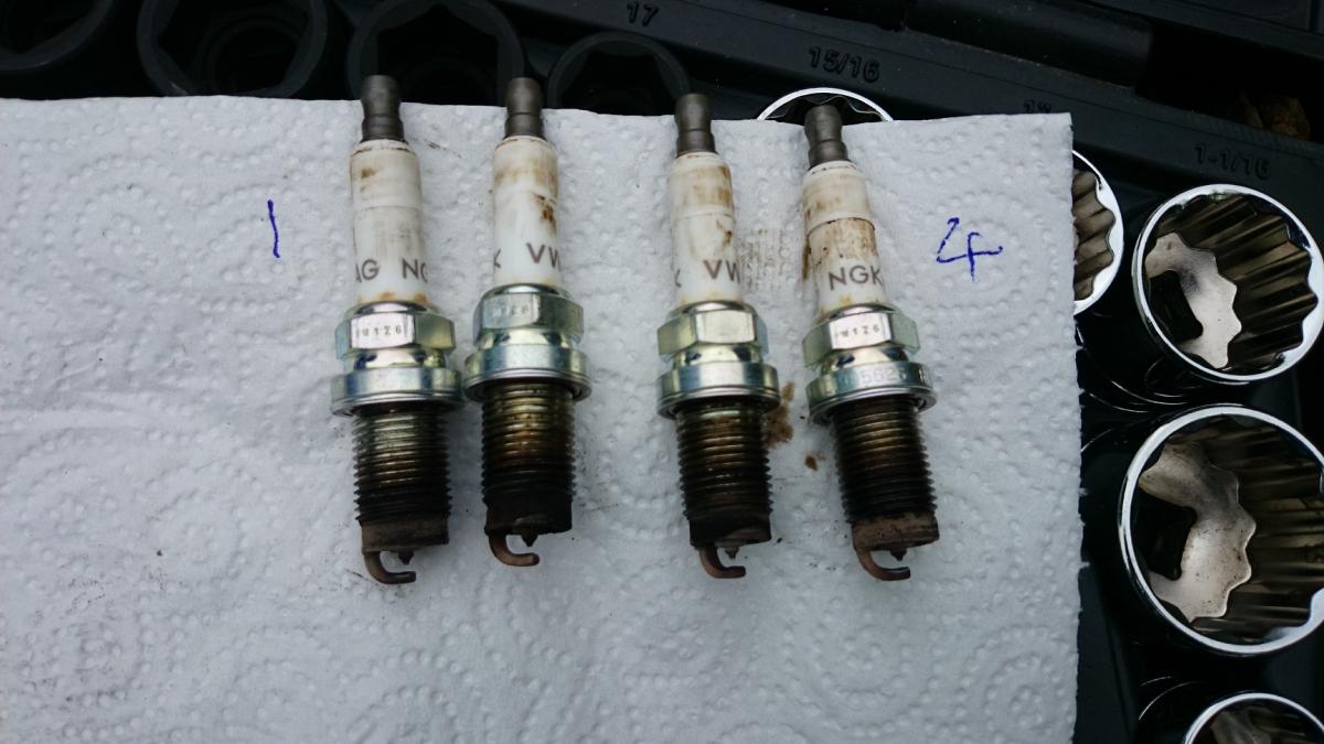

  • New plugs in this morning, old plugs were not looking too healthy although at least all of them appeared to still be intact.
They checked them apparently!
Best ask again, were the plugs out, & why did they not replace with new ones.
Not a huge cost for 4 plugs, compared to the failure of one.
They would have to check very very closely, the tracking can be seen, but i have checked plugs that someone only looked at the tip and missed sign of tracking.
What mileage have the plugs done.?
They would have been as well to have been changed while out,
Looks to be a piece missing from cylinder 2's plug? The very tip. Good thing you've changed them. I'm going to ask to see my plug(s) if they were the cause.
Just had a check of the #2 plug, it is all there Matt.
Must have just been the angle of the photo and the light.

Sorry, the poor picture. (i must take better pics of some plugs.)
This is how they go after the tip has gone first then the plug starts to burn out.
But you can even see tracking on the plug in cylinder 3 when you look close.
It really does get cooked.
