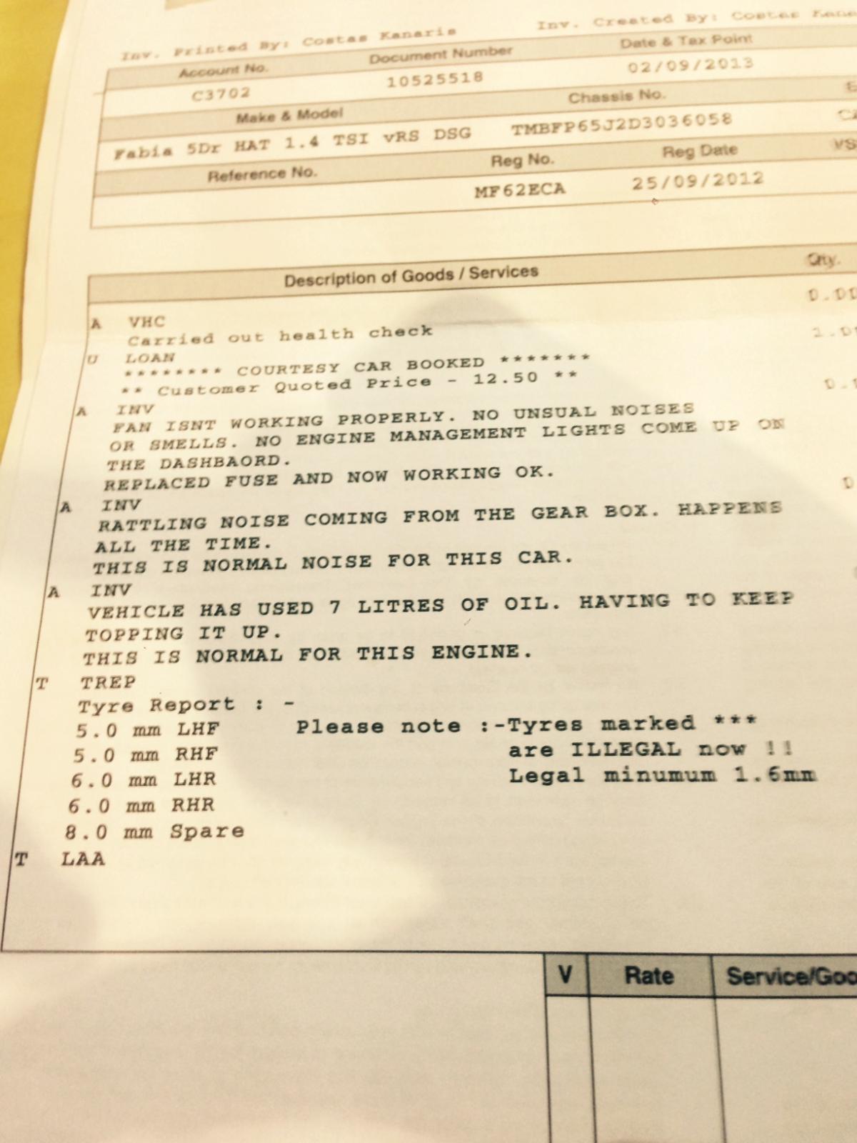

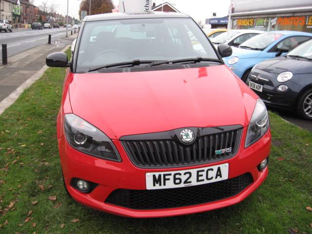

hey gang just managed to grab a 36k skoda fabia vrs mk2 1 previous owner in red at £8000 cash 2012 cave engine skoda warranty until september 2015 was looking over all the services until 36k and at 15 i noticed this so it looks like in 15,000 miles its used 7 litres of oil i asked about the dsg recall and skoda uk checked there system and told me my cave was not in the dsg recall band yet i noticed this on the log report,  it looks like skoda uk keep trying to palm me off what do you all think made sure skoda LOGGED my oil consumption concern in there records not having any messing from a company who keep trying to hide a engine issue ill fight the system if it comes to it! i no all of briskoda will have my back if it comes down to it!
Unreal that someone has committed in writing that this is normal oil use for these engines.
 & the gearbox rattle is normal.
Only normal on ones that are not right,
and thats VW / Skodas fault.
PS.
Skoda never did a Recall, only a 'Service Campaign',  but they never published which ones require it
or not,  you need to trust to their system saying which between 2010 require the Synthetic Oil changed
& the ECU update on the DSG ECU.

i will be checking oil periodically this was the first service , another two services were carried out after that with no mention of oil usage or anything what are we saying fellas bad engine or just running in ?

thats the next step keith just wondering if these engines tend to use more oil when bedding in ? i mean i don't see a mention of anything after that
What i am saying is,
the things said by Dealership employees as Normal are why so many of the 1,800 cars with CAVE engines never had the Warranty Work carried out,
they tried to hold to 0.5 litres in 1000 km as the acceptable oil use.
You have the Warranty, so many engines did reduce oil use over time.
So do not Overfill with oil,  and monitor how much oil is used.
Please do a 'Cold Dip' tomorrow,  on the Flat, stone cold engine.
& let us know where the Oil is on the Dipstick.
If it has 3.6 litres in,
it should be above the top of the Cross Hatch tomorrow morning.
Both my old 2010 CAVE and my partner 2011 CAVE never used near to that amount over the first 20000 miles .In my opinion it will get worse. .
When I sold mine at 28000 ,mine was border line, my partners - new engine at 43000
However, happy to be corrected!

looks good , enjoy your new car :)
Hi congratulations on your purchase! Welcome to a rare breed of Fabia vRS owners  who must have the best 'value for money' performance cars on the road today ...Yes,there are good ones and bad ones but try not to get too engrossed in all the problems or it will take away all the fun you should be having. You're warranted til September 2015 so that's good news so just keep an eye on things for a while,log every phone call,get things in writing and more importantly enjoy this little car!
