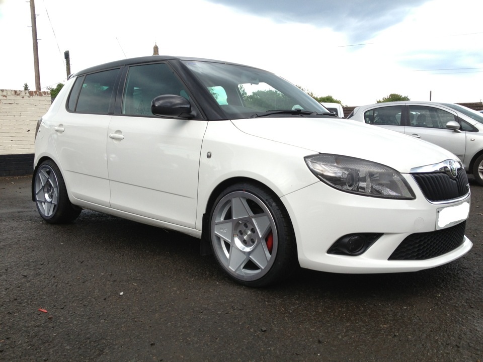

needs to be 215/35 tires or you will rub your arches off . best bet is falken or toyo tires since those are pretty slim on the side .
521893_433024200057584_1615587565_n.jpg?
12987060_1312350308791631_3644584351134712987173_1312443925448936_82331882966211
fabianoh5n1 is your Vrs Lowered?
KW var2 around 55mm lower
2 awesome pictures right there. :)
