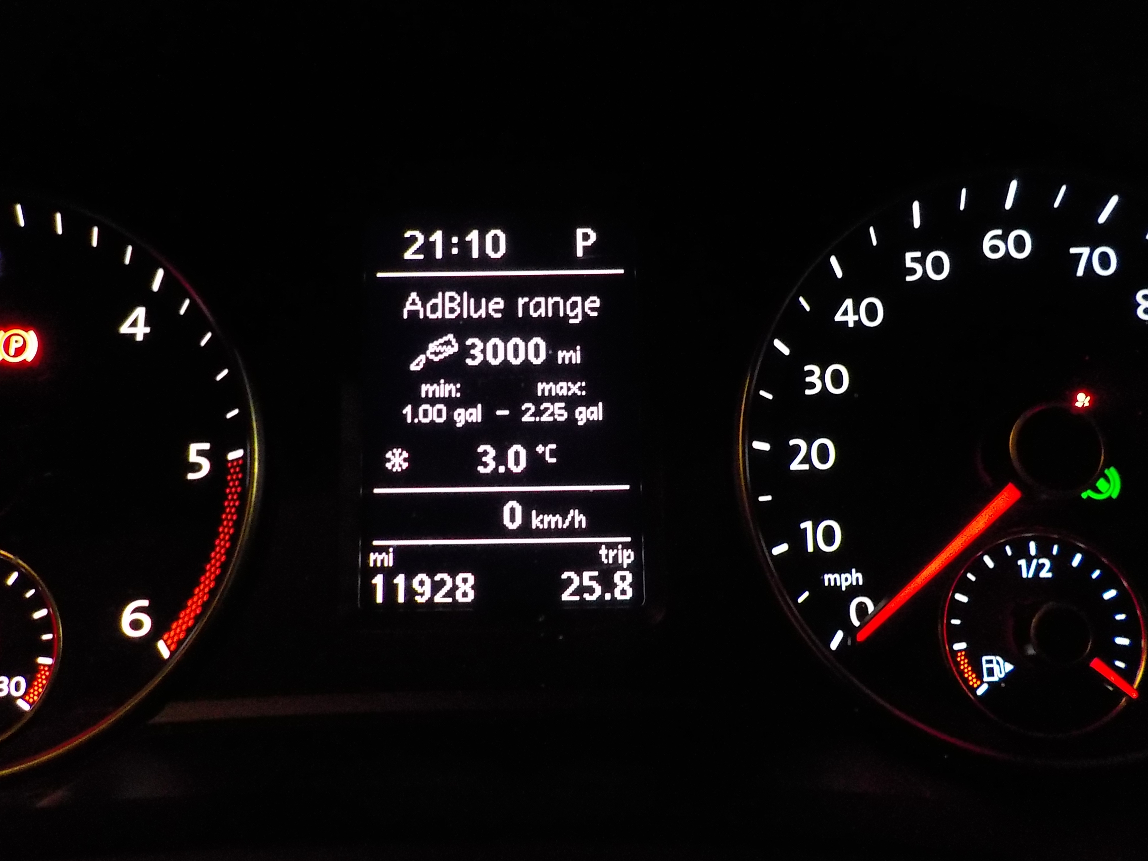

My SEAT has a 16 litre Ad-blue tank and it shows 7,000 mile range when full.
here it shows max Ad-Blue to add is 10.2 litres (2.25 gallon) when showing a 3,000 mile range.

56 minutes ago, AwaoffSki said:
What did the screen show at the time as Max you should add?
1 gallon to 1.5 gallons, so I added 7 litres. Left the car for 5 minutes with the ignition on, and engine off, as per the handbook. Still no clearing of the warning - still said add 1.5 gallons when you turned the ignition on. Left the car overnight. No difference. Drove it for 20 miles - no difference.
Assumed I needed to add more, so I added a further 2 litres, making 9. this brimmed it and this is why the dealership said I'd overfilled it. Since then, its been drained, refilled, new knock sensor, new injector and a new tank/piping/sensor fitted (well, a donor from a working car anyway). Still no difference.
