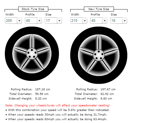

18" Wheels and tyres on the MK2 are not reducing the gap if the tyres are the same circumference.
You would need to be fitting a bigger outer circle obviously, not just a bigger circle inside the tyres, ie the wheel.
http://kouki.co.uk/utilities/visual-tyre-size-calculator

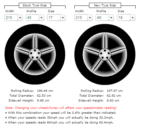

So a potential change would something like the photo attached:

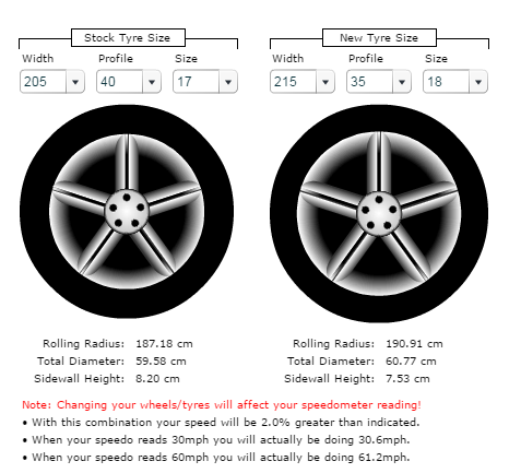

Surly you would have to go to 35 to keep the rolling radius the same? Would a 40 put the speedo out?
so this may be better then
That is what you want.
& then measure side by side in the real world, because the numbers on the side do not tell the whole story as Brands and tyre can change that a little,
but you are not going to have issues with 215/35 R18

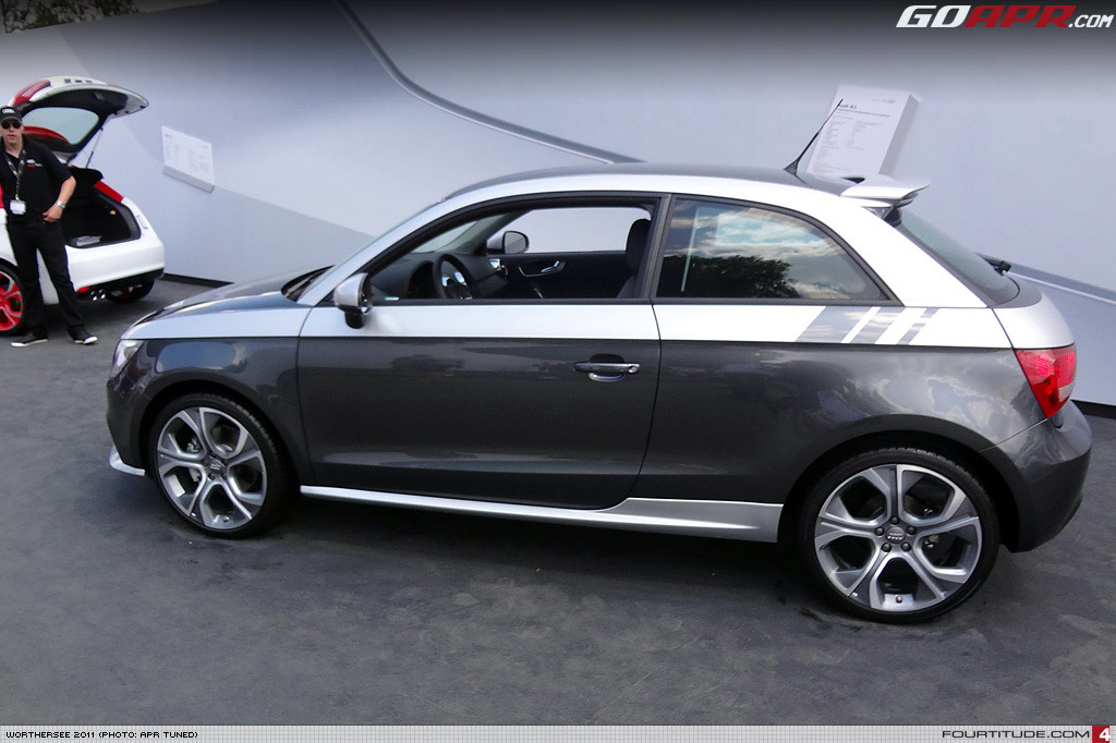

(Audi fitted bigger on the A1 Sport Competition or what ever and i tried them on a Fabia and they fitted.)

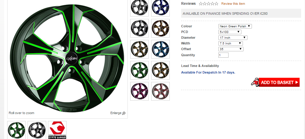

sticking with 17" and coilovers is another option. Car definitely needs lowering that's for certain now ive started modding things.
Really bored of black alloys and they are chipped, so cant think of another colour!

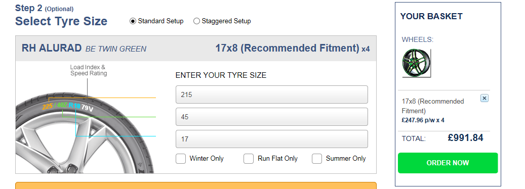

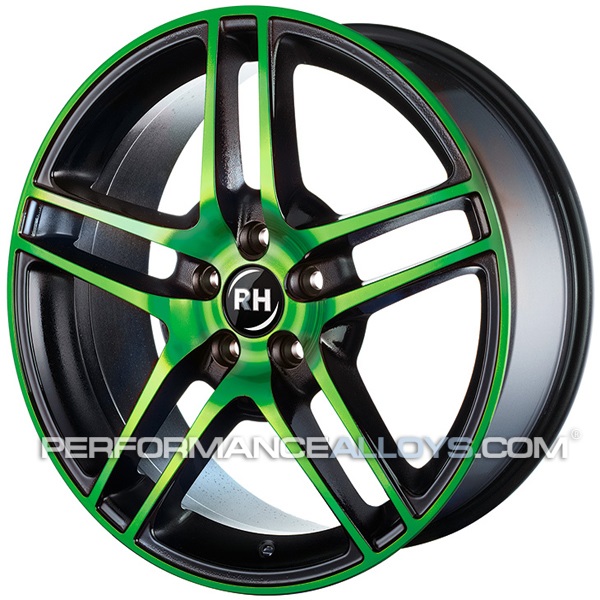

Really struggling to find some Green / Black Alloys that dont break the bank.
Found these 17" Alurad ones £1000 for 4, without tyres but worth saving for looks wise but the size is 215/45/17 (17 x 8 fitment)
Would 45 even fit on the VRS MKII?
The third photo is almost exactly the look i am after black/ green alloys but not lowered as much as photo.
205/45 R 15 is OK but not any use for putting on 8 x 17 rims.   215/45 R 17 are just too tall.
Not sure how you would get on with 225/35 R 17's but they are available in good tyres.
or just go 215/40 R 17
Edited by Awayoffski
There are alloys available that have removable metal inserts, which you could paint the right shade of green.

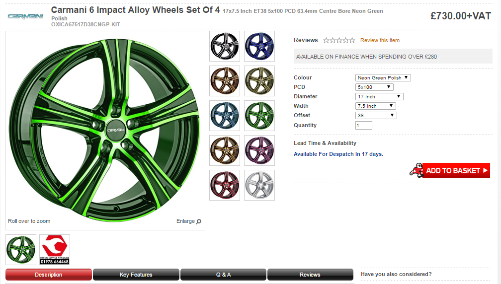

Finally found some but had to increase the width of Alloy to 7.5" from 7". Gigaros are offset 41, these are 38, cant see 1/2 inch causing a problem?
These will allow a more standard tyre spec of 205 or 215/R40/17 , Roll on my 40th birthday next year as that how long its gonna take me to save up for these!
