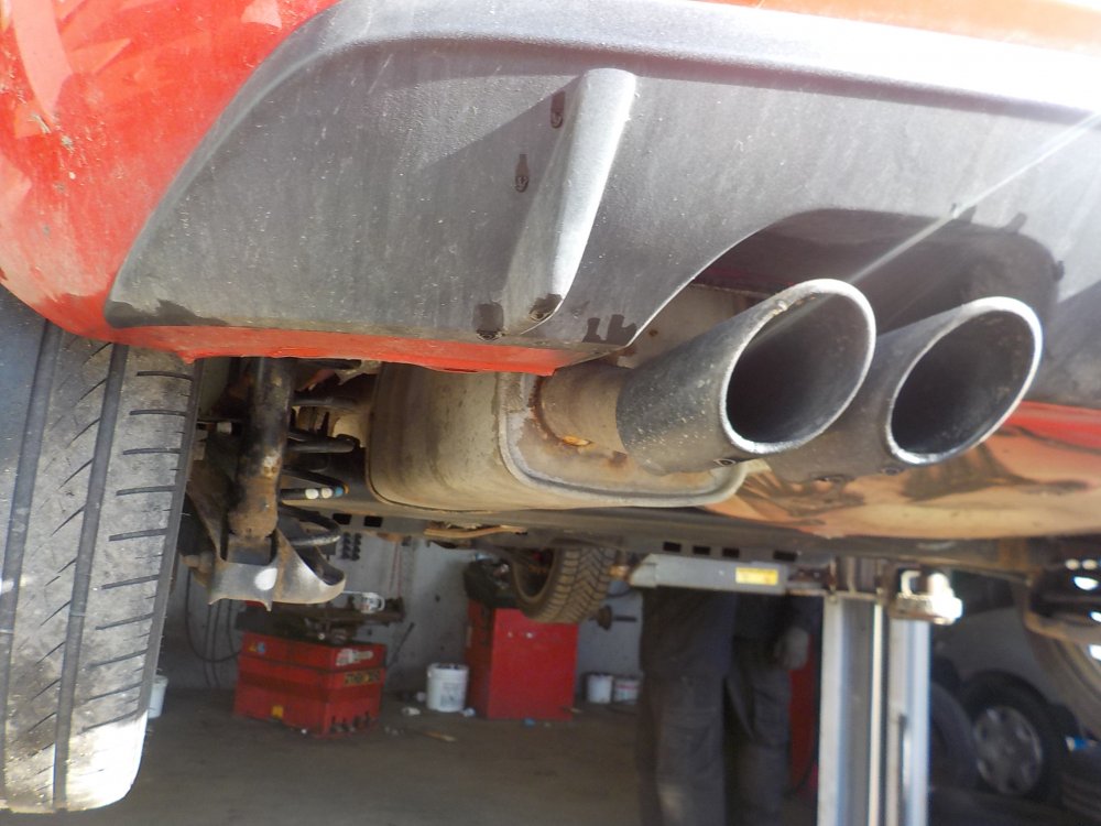

Cosmetic and Surface Corrosion is very common on the Twinchargers back box of the OEM system and it can be there from year 1 to now.
Just treat the seams with some rust inhibitor then paint with Silver Manifold Paint or the likes,
or replaces as needed or wanted or as you can persuade others that it is necessary.

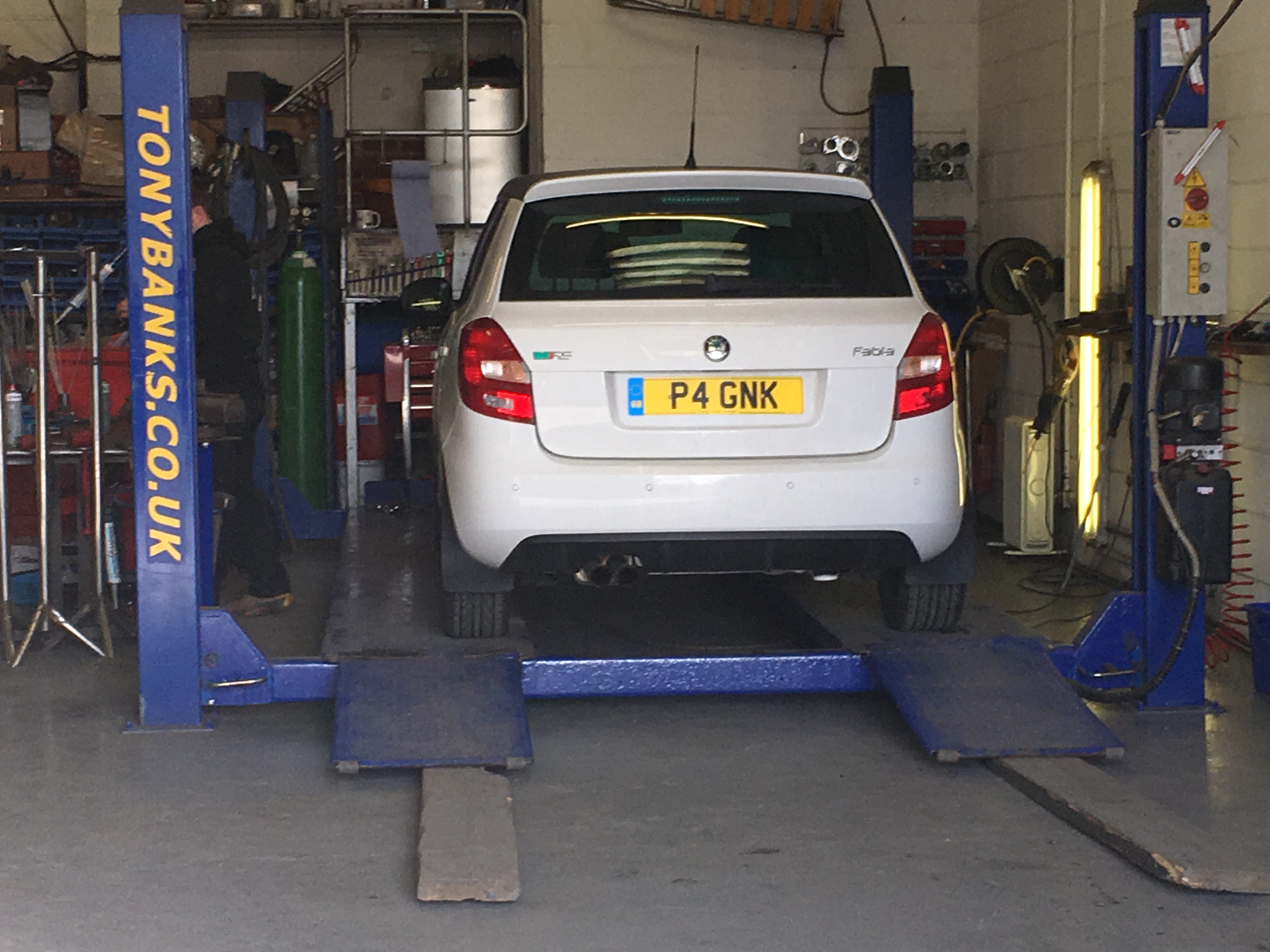

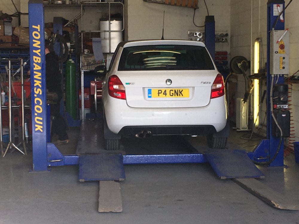

Car now on the ramps at Tony Banks. Chosen the tailpipes - double oval which fits the bumper cutout nicely. Now off for a walk for 2 hrs.
Had a call from them in less than 2hrs to say it was ready. Looks good from behind and fills the gap nicely. Fired it up and you can tell it's different. A deep note on tick over and then onto the ring road. It isn't too loud to be overbearing at normal speeds and it seems to pull better. Now to join the dual carriageway and past the speed camera. Ready in sport mode and we're off (up to 70mph of course!) - it sounds well and still not too loud.

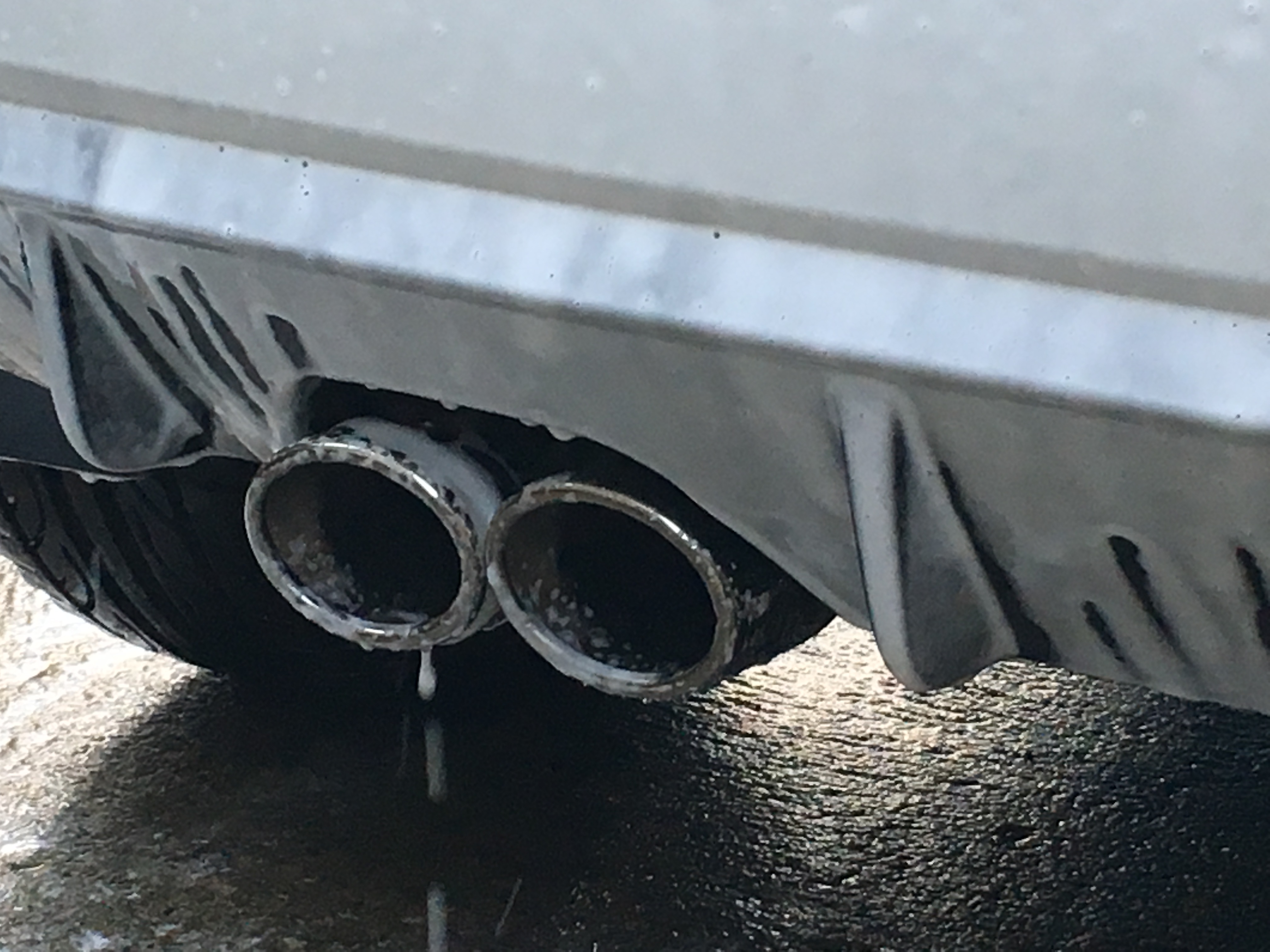

Gave it a quick wash. Rinse, snow foam, rinse then wash with lambs wool mit and final rinse!
Picked up wife who liked the look of it. Driving home she commented it was a bit louder than she expected but would give it a couple of days to get used to it.

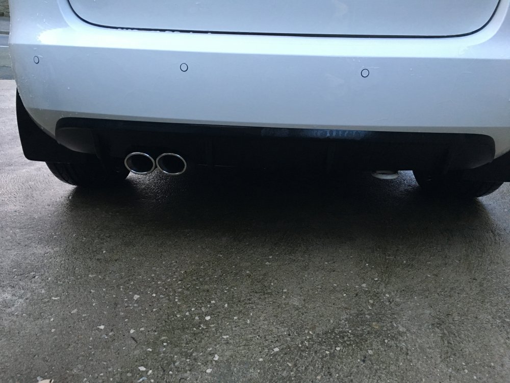

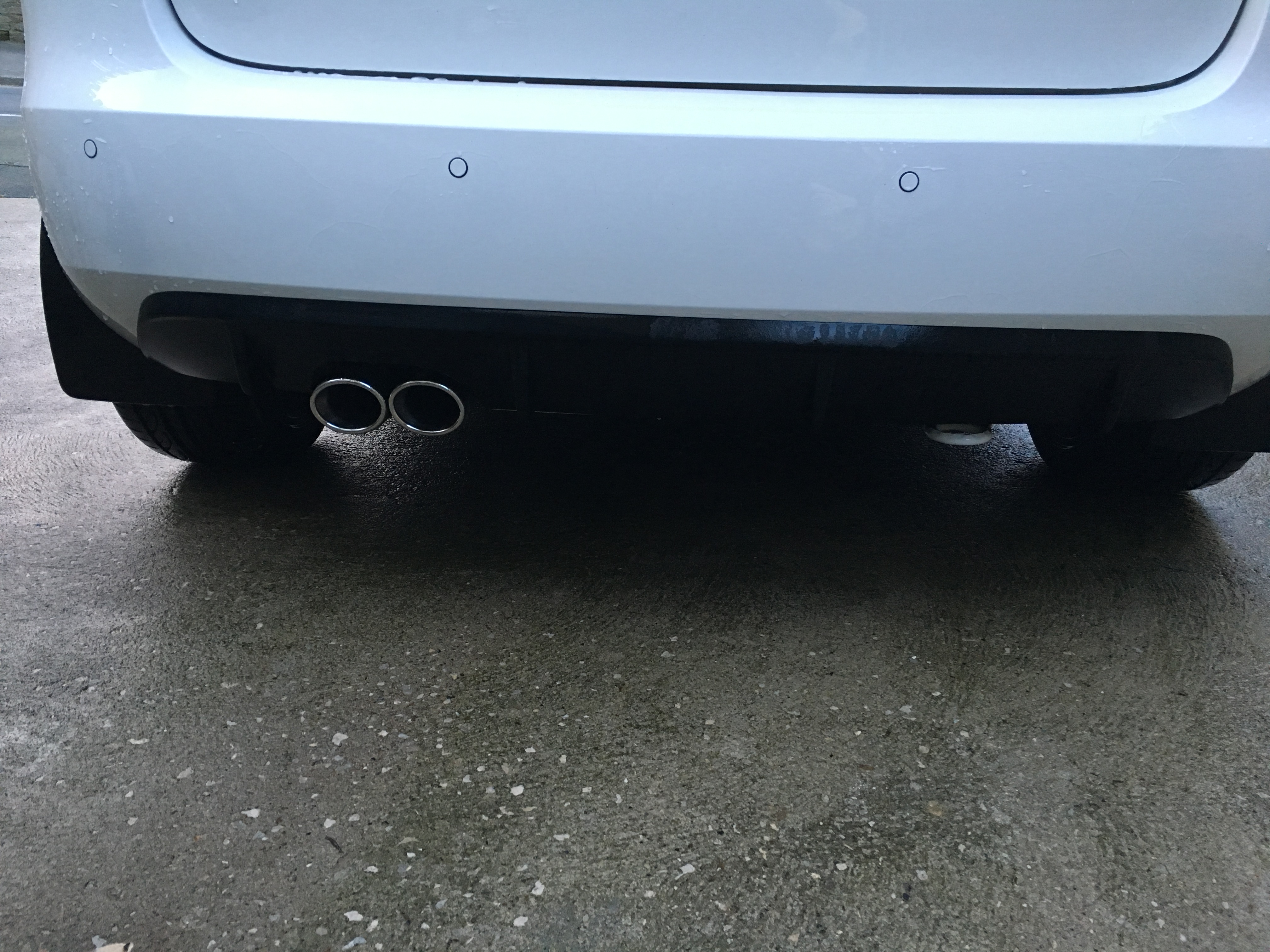

i haven't seen he whole system yet but the tail pipes are shown.
When you buy a cat back system you get it from the rear of the front silencer, which is actually part of the cat pipe. He cut the silencer off and made a stainless pipe to replace it therefore reducing back pressure. It now has a single pipe running from the front with a silencer and the twin oval tail pipe. You can hear it at 70mph on the motorway but not too loud to deafen you or become annoying on a long journey.
