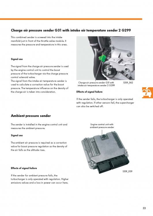

4173 - Manifold Pressure / Boost Sensor (G31)
          P0236 00 [096] - Implausible Signal
          Intermittent - Not Confirmed - Tested Since Memory Clear
             Freeze Frame:
                    Fault Status: 00000001
                    Fault Priority: 2
                    Fault Frequency: 1
                    Mileage: 80713 km
                    Engine speed: 794.50 /min
                    Normed load value: 32.9 %
                    Vehicle speed: 255 km/h
                    Coolant temperature: 81 °C
                    Intake air temperature: 36 °C
                    Ambient air pressure: 990 mbar
                    Voltage terminal 30: 10.860 V
                    Unlearning counter according OBD: 1
                    Adjustment requirements for basic setting-Bit 0: 183
                    Charge press. ctrl.: spec. value: 5.1 %
                    Charge air pressure: actual value: 1290.86 hPa
                    Charge air pressure specified value: 438.83 hPa
                    Intake manifold pressure before 2nd compressor: raw value: 988.36 hPa
                    Engine torque: 71.2 Nm
No expert on this but the boost sensor G31 could be getting dodgy info or it is part of a bigger problem (Vehicle speed 255km/h?)
Usually when sensors are playing up this is what cause EML lights etc..
