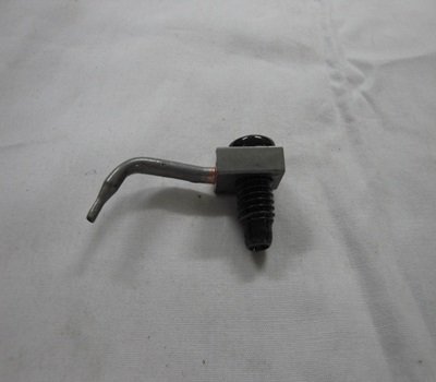

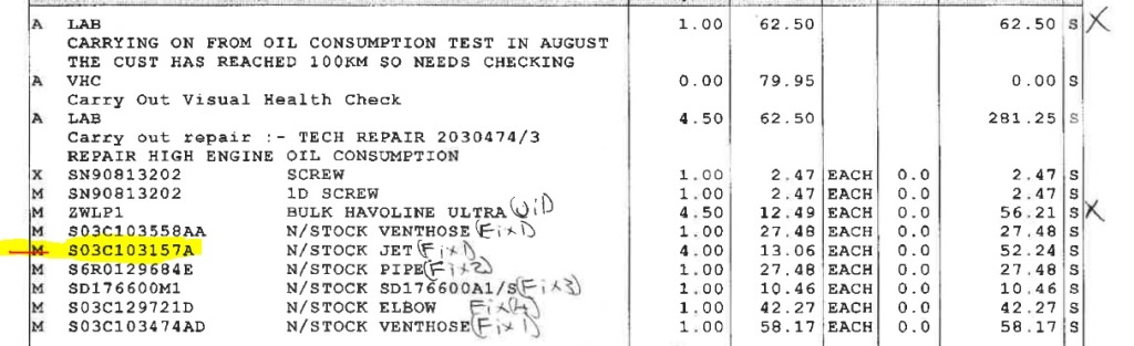

Also you might be able to prove your car has the wrong badly designed oil jets on as others users cars have had oil jets replaced (in warranty and out warranty) and charged for the oil problem. 'Bad oil spray pattern' being 1 of primary causes for premature failure of plugs.
The code is below and my bill showing the parts for the CAVE fixes. The part comes from the CAVD engine. The earlier VW Scirrocco.
Definitely get them to check which oil jets they have on your CTHE.
