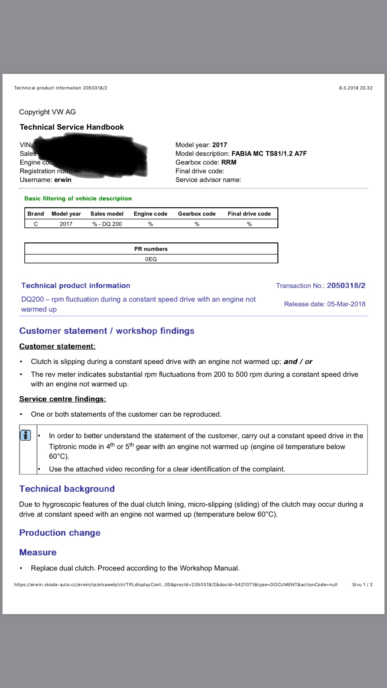

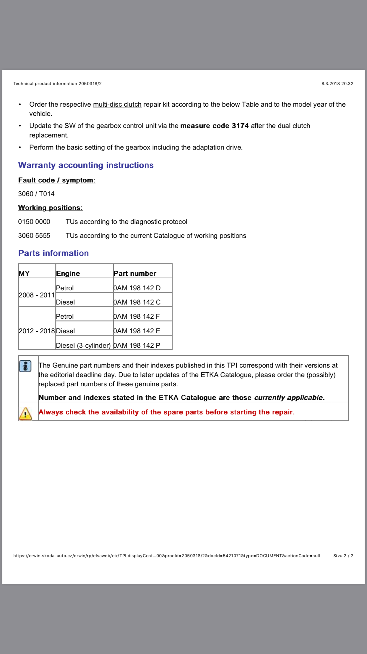

Is there a TPI on this - perhaps it is the 2050318/2 - does anyone know what it says?
Mads - you can PM me if you like (in danish) but i think people here in the blog would like to see it too.

12F7B9D5-DDB7-4BC7-B915-3D40B054607F.thumb.png.ae28a79317a4230b4bd90a8e4cc9ceae.png71E5D253-7E87-4DAD-81AB-168242BD5561.thumb.png.5b143b30dab217c5c6f4b2358931340e.png
Edited by fabiamc
But this description is not accurate. It does this during acceleration...
Does anyone have the video mentioned in TPI...?

I saw this new TPI 2050318/2 then I contacted Skoda and with no hassle at all they ordered a new clutchpack and booked the in for 4.april.
Out of the blue I got a mail from Lone (chief tech) FDM that skoda was in the progress of installing new clutches that reportedly will fix the sliding clutch problem

Video is ok, and it also shows acceleration, so it is just described falsly.
Ok, time to persue the TPI...
