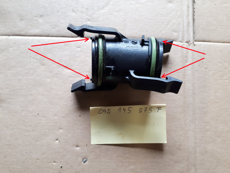

  • Hi again...   Another note... At the lower picture, please notice the small plastic spacers that are molded into the adapter hose. Mine were rubbed off to quite an extent due to vibration of

Another note... At the lower picture, please notice the small plastic spacers that are molded into the adapter hose. Mine were rubbed off to quite an extent due to vibration of engine, so in order for this fix to work, I had to cut them off to achieve a full smooth surface to which the newly inserted gaskets would sit on.

Congratulations on your diagnostic work, and fix.
A sketch (or photo) showing the gasket arrangement you've made might be a useful addition to your verbal description.

I will do this next time when I will dismantle this on my car, after I receive the ordered springs and possibly new o-ring gaskets of larger thickness, if i will source one out.

Please also verify that the longer hose seat is not damaged in the place where the original gasket seats. Mine has a grove in that place.
