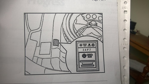

If done as a Service Campaign, as per the 'VW Instructions there should be a sticker in the Spare Tyre Well,
or Skoda UK should have it on the system, they were paying.

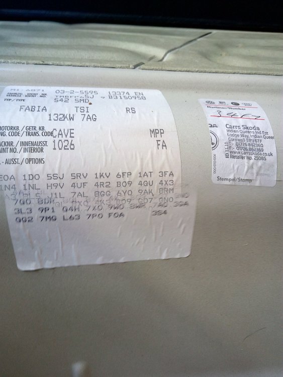

Me just failed two nights ago has the sticker in the boot

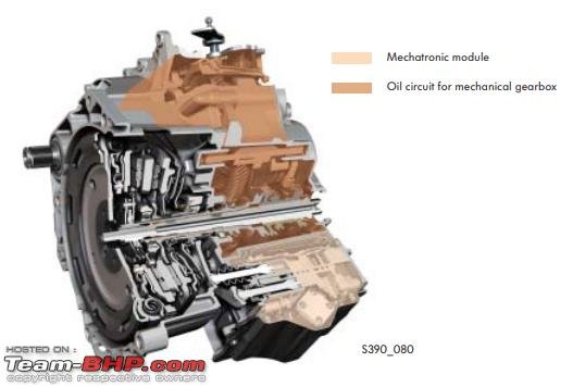

How much has leaked? The mech unit only holds 1 litre of oil that is separate to the main gearbox oil that is 1.7 litres.
1474754515_dq20020oil20circuits.PNG.b5c693598561a61ac660fe3041e63045.PNG340459383_mechatronic20sensors.PNG.3eef00fd5380f7beea979389c4c9b5d1.PNG
Ask your mechanic where its leaking, its pretty uncommon for these to leak, usually the hydraulic pump goes in the mech unit but no leaks. The mech unit is sealed by rubber and torqued in so get that seal checked out.

The New Zealand Service Campaign had all the cars with a DQ200 DSG get a 'new Mechatronic Control unit, and Mineral Oil & the Software update.
The World Wide Recall had other World Regions get an extended warranty to 10 years / 100,000 miles.
So VW / Skoda can say you do not get a guarantee for the life of a car, but you get an Extended Warranty when they sh!t themselves in other world regions.
Skoda / VW UK / Europe / Globally know the DQ200 2009-2012/13 issues are due to their failings so take what they say as the usual panning you off.
They filled with Synthetic Oil, they had to do changes to Mineral & Software changes, they are not just able to then say tough luck, bog off, tough titty.
