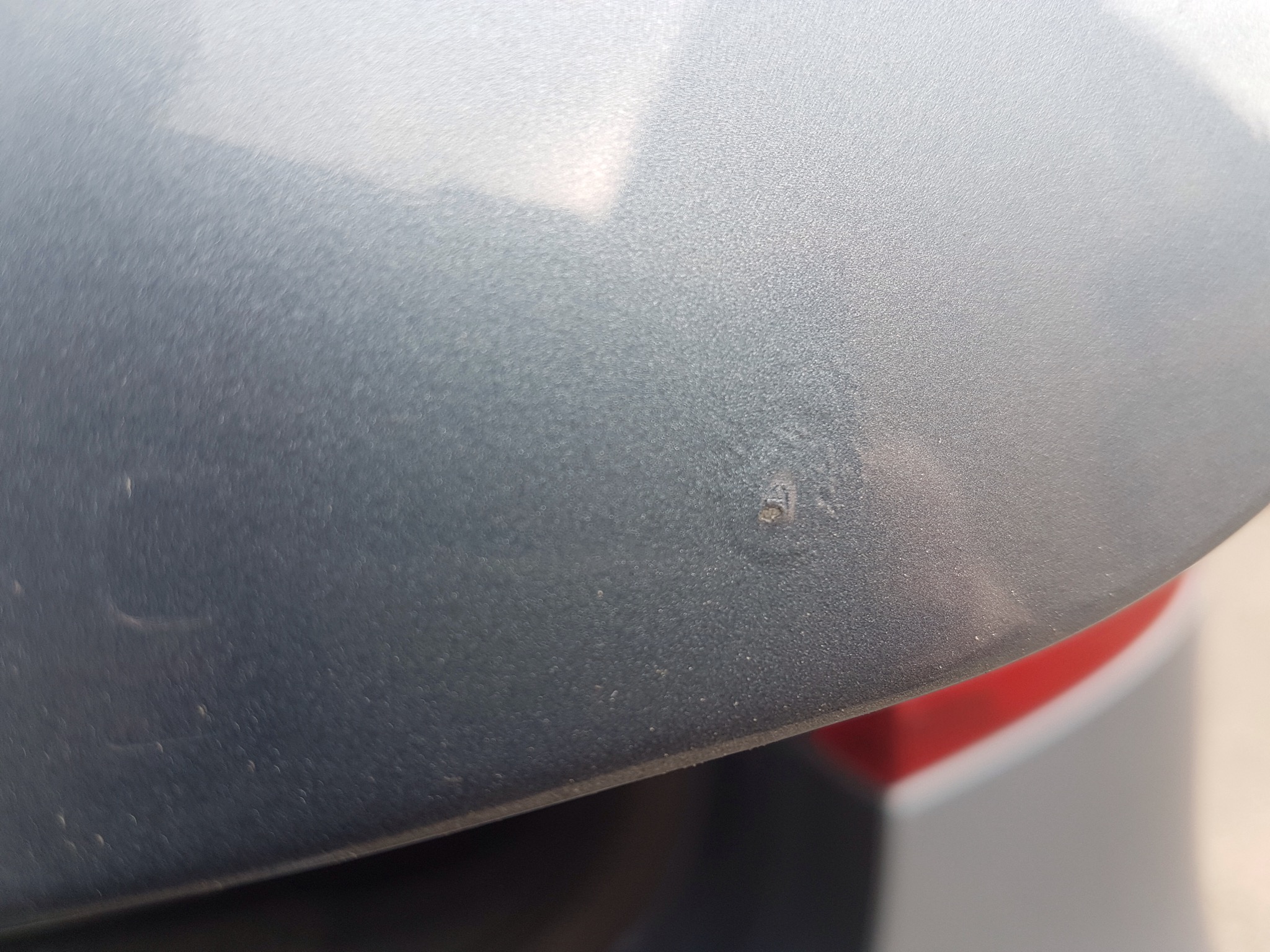

My Fabia Elegance 1.6 TDI on a 10-plate has the small tell tale corrosion signs starting on the tailgate. Gave the paintwork a proper clean, degrease, clay and wax top coat today as it was a great day for being out and playing with cars. Remind me not to use Collinite 915 (absolute sod of a product to use)... Meguiar's carnuba wax is better.

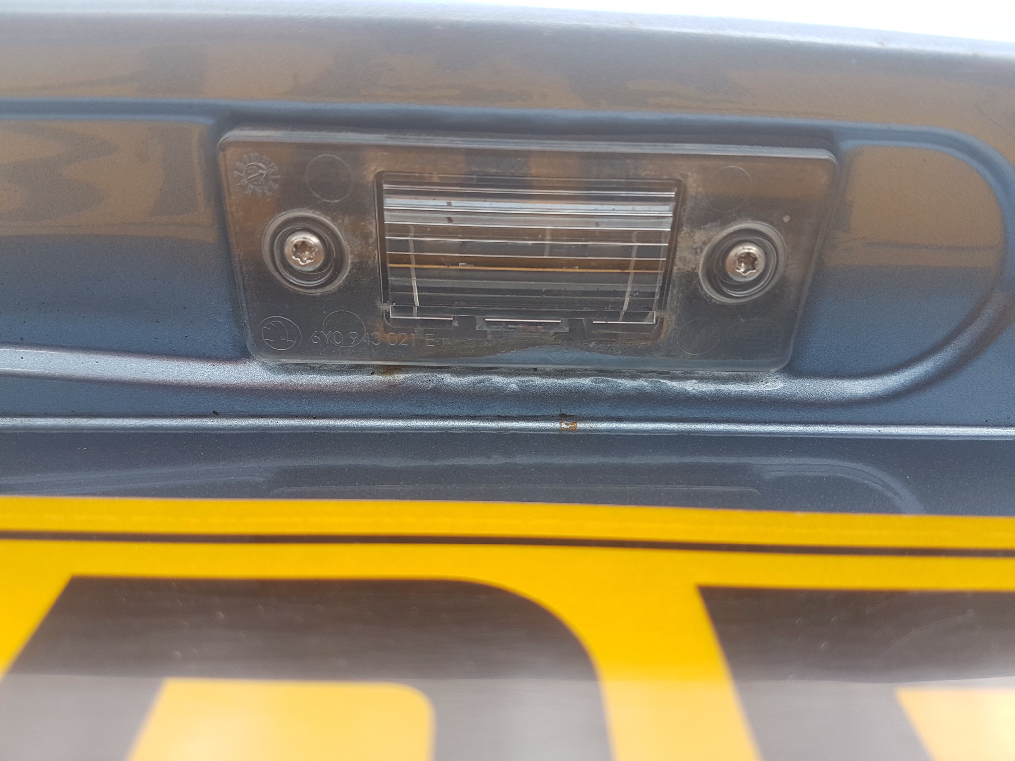

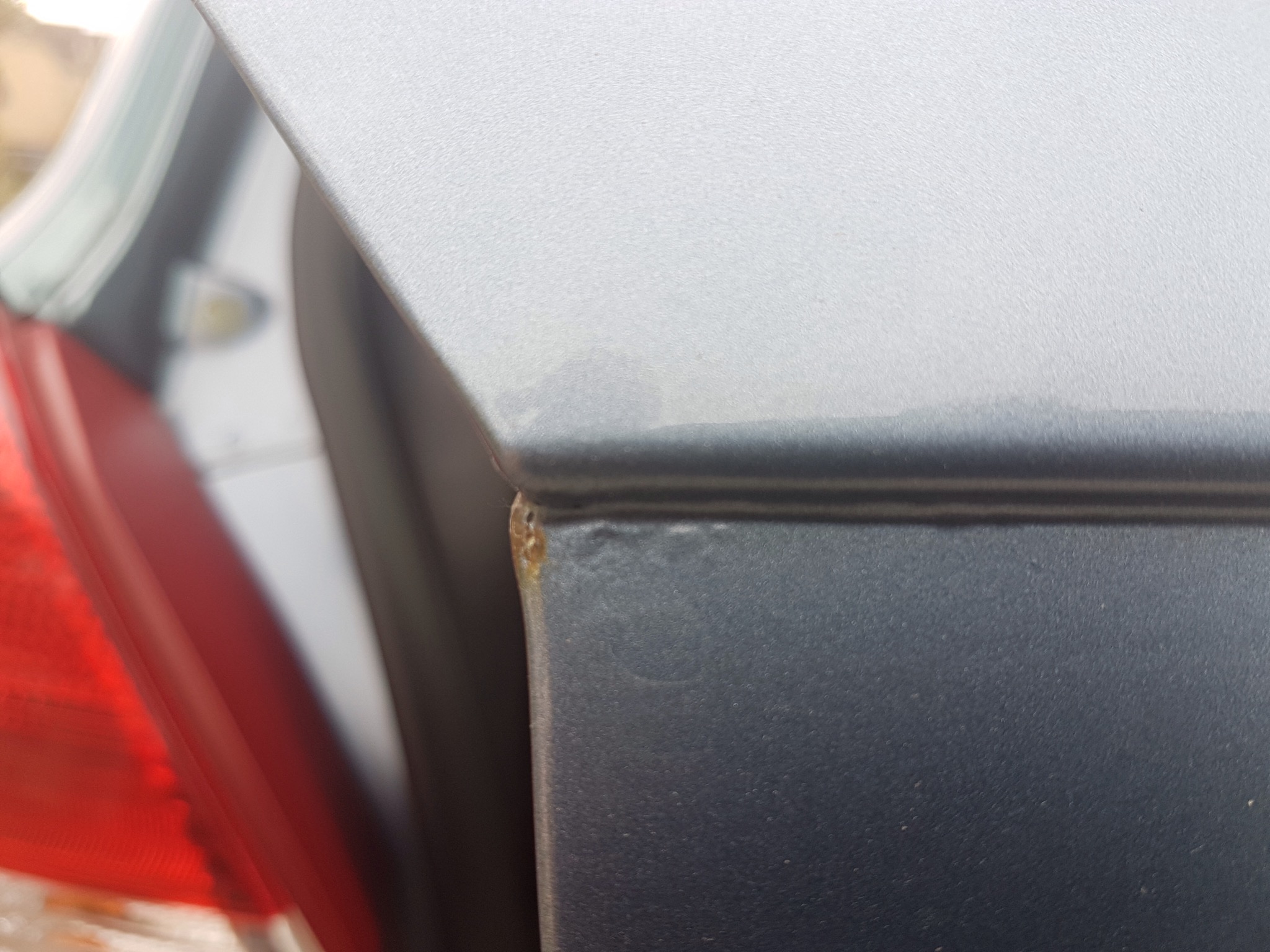

I'll post pictures tomorrow, but wondered what other owners are seeing? This is on 85k mile car that gets quite a lot of DIY attention. Granted it's been a hard winter, and our council and roads department have spread more salt than Harry Ramsden! Seems to be isolated to a couple of bits in tailgate, namely rear numberplate illumination lights and one edge of the tailgate.

The corrosion at rear number plate lights is a classic case of poor design by using foam gaskets instead of rubber ones allowing moisture to be held there. The Fabia does get particularly dirty at the back, so you'd have thought Skoda would take more care over the seam joints.
Anyway, fired an email off to Skoda to see if the dealer can inspect it. I've maintained car for the last 6 years so that might be an issue, but we'll see.
Just the same places as Skoda UK have had to approve warranty work.   Maybe Skoda in other countries as well.
So no point anyone at Skoda UK like a Warranty Manager or Communications Manager saying not a known issue.
Update on this. Skoda approved repair, so it's in bodyshop just now. I'm a little surprised, as I've been here before with Audi in the past. They check paint depth as a matter of course. If it's been repaired before, then you can forget it. Skoda will make you jump though hoops, but be persistent.
Bodywork is great on the rest of the car, and this is the only rust I've found (normally through a thorough detailing session), so my advice is to check and claim. I need this car to last another couple of years without deteriorating, so want to keep on top of it, as rust is relentless otherwise.

Latest update. Called the body-shop (as they've had it 4 days), so they said corrosion was worse than they thought when they removed the lights, so they've taken photographs and are requesting a new tailgate from Skoda UK. That'll mean new rear screen I expect?
